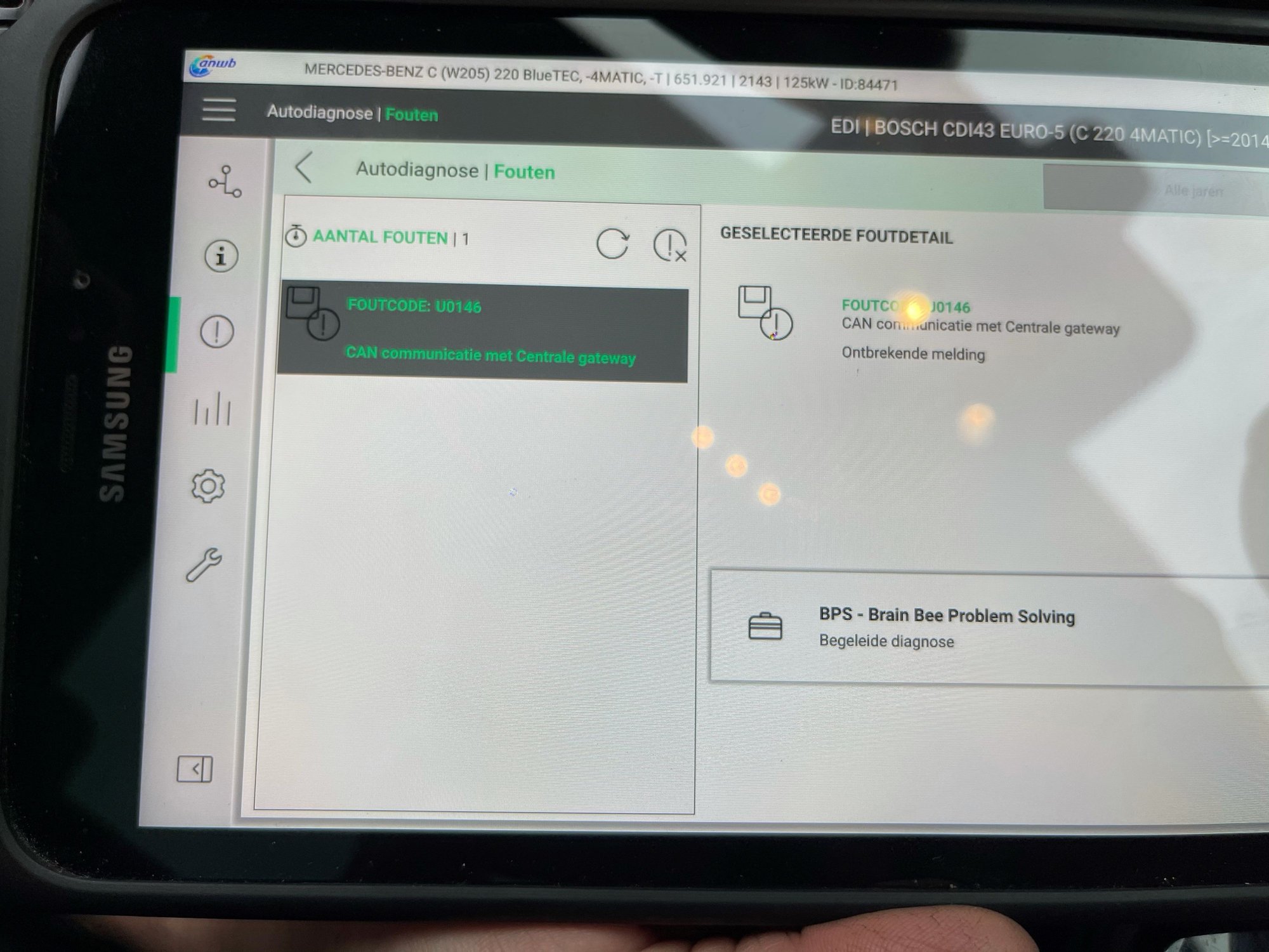

Oke guys i have an update: we called the car service to check what is going on. He scanned the car and said: that there was o miscommunication with a gateway.
I have made some pictures from the vault codes. :
U0146 is the code. Does someone know what this does or how i can fix this problem.
Why didn't you let the service guy fix it?

Service guy can only read the fault codes and reset it. He did a reset but it didnt go away. Now im searching for a solution. I just called the dealer for an appointment but the first option was in september.

Ok problem solved. The problem was the dvd player. Canbus disconnection caused by the dvdplayer dont know how. I think once a time the middle console was stolen and i puted a new one but the console + chasisnr wasnt equal. so im happy that the problem is solved
