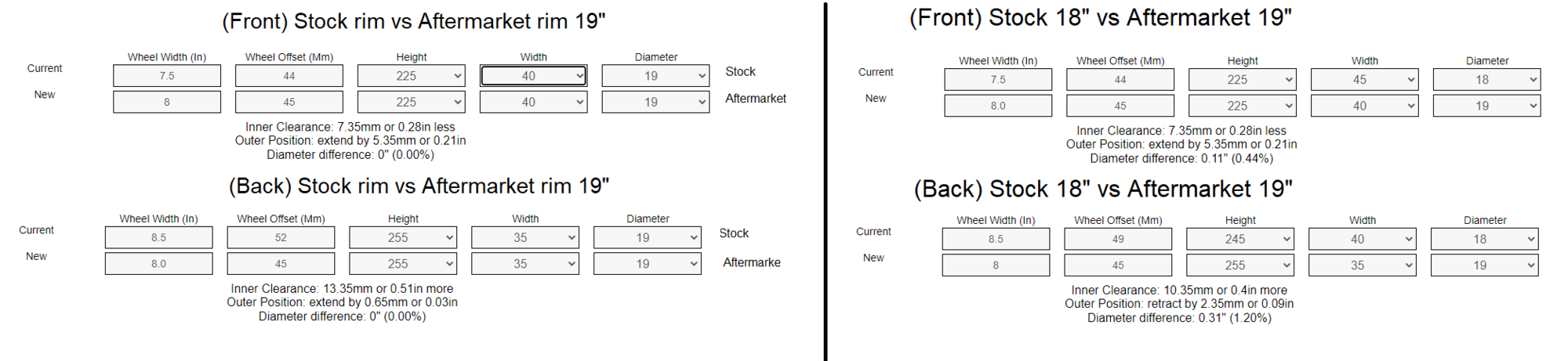

You did not confuse at all. I went a step ahead and used the calculator to check everything and here is what i found. i compared my rims 19 vs the mb suggested setup for 19 and my 19 vs their suggest 18 to check how much we are off.
Old Jan 19, 2022 | 05:34 PM
Zik Mir's Avatar
Joined: Jan 2020
Posts: 64
Likes: 10
From: NB, Canada
C300 avantgarde edition 2021
As you can see, the difference in front will be off my 0.28 inches closer and 0.21 inches outer. Hopefully this doesnt hit inside when turning or throw rocks at the car for being little out.
For the rear, its more, its 0.5 inch closer to the inside and almost equal to the outer.
What do you think? Too dangerous or is this usually acceptable?
Acceptable.
You may be able to reuse the lug bolts that came with the vehicle depending on your aftermarket wheels, some designed with OE lug bolts in mind and if not you should still have the aftermarket ones from your GLB.
I thought you want to get a squared setup, how come front and rear is staggered in the image you shown above? If you are going for squared, those aftermarket wheels you have and the 225/40 R19 for all four and based on the specifications you provided on the winter wheels you used on the GLB, it is unlikely to give you issues. As for the old GLB tires, I think you can sell it for a good price hopefully.
Remember, you want to have at least 15-17mm of shank length left on the other side of the wheel. This is to ensure it is bolted on safely, you can go more than that for the front but do not go more for the rear as you don't want to destroy your brake shoe, 19mm or above is pretty much guaranteed that it will damage your brake shoe. Try to keep it in between 15-17mm, preferably 17mm.

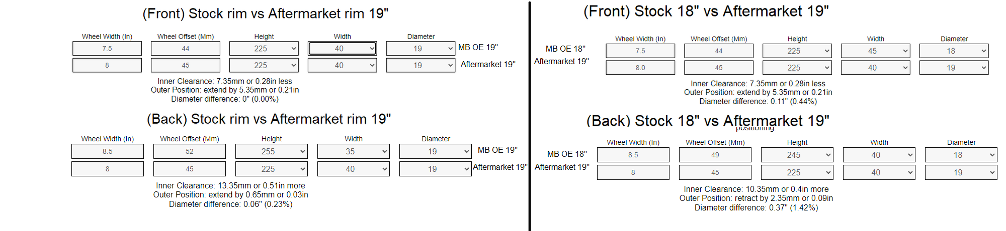

You are correct, i mistakenly compared staggered formation. I updated it with square and now the rear measurement is even closer to what OEM is at least with 19 vs 18. I wrote it down to be more clear:
19" MB OE vs 19"Aftermarket(Square) = 7.35/5.35 mm off for Front tires
19" MB OE vs 19"Aftermarket(Square) = 13/0.65 mm off for Rear tires
18" MB OE vs 19"Aftermarket(Square) = 7.35/5.35 mm off for Front tires
19" MB OE vs 19"Aftermarket(Square) = 10.35/2.35 mm off for Rear tires
As you can see the best case scenario is comparing what MB recommends as 18" and with my 19" aftermarket im off my 7.35 mm in front and 10.35 mm in rear. Now hopefully thats not too bad?
I do not have have aftermarket lugs, i always used the original with my GLB. I was hoping to do the exact same, use the original lugs with the new car with my 19s".
UPDATED
Assuming that all the data you provided me is correct and that you verified everything, the width of your aftermarket rim decreased by 0.5 inch that helped offset the differences you mentioned, it is unlikely you will have problems with these aftermarket wheels on 225/40 R19 tires. If your main concern is that it sticks out more, I am happy to say that it wouldn't be too much to the point that will actually cause an issue. The only thing sticking out too much is a problem is when it is greater than at least 20mm, then it is too far out putting stress on the wheel bearing (usually people do that for a wider stance at the rear), suspension components as everything is off balance that way. However, 10-13mm as you indicated is unlikely to cause damage.

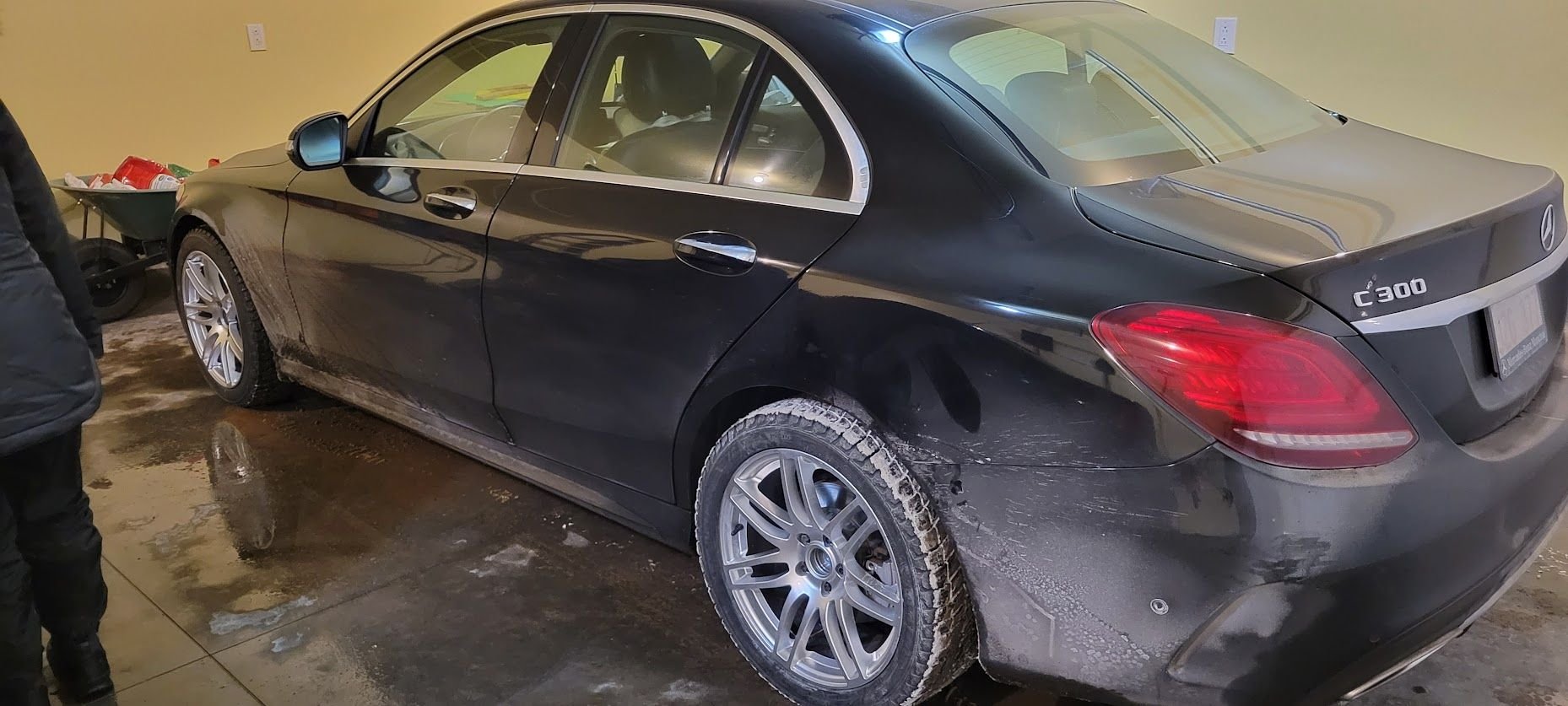

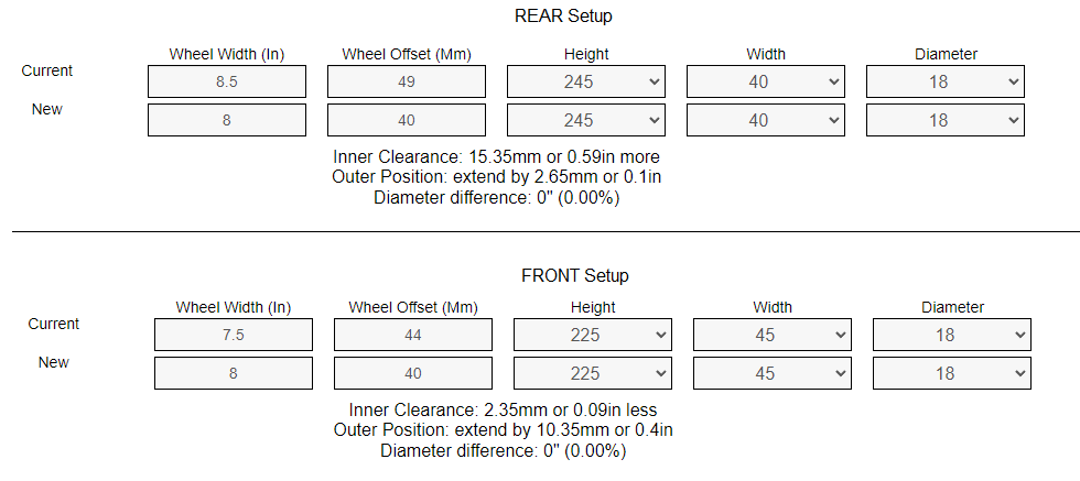

They didn't have the other brands. So i finally got them today. I checked the fuel door and it says 38 PSI? lol Isn't that much for snow?
Michelin X-Ice® SNOW
F: 225/45/18
R: 245/40/18
Rims:
Width 8.0
Height 18"
Offset 40
Hub 66
I was concerned about the offset but they calculated and assured me they wont rub or touch. I did my own calculations
Seems front is sticking little out by about 0.4 inch. What do you think?
Sorry the car is dirty due to all the snow and slush lol
Ouch that salt is brutal but you still kept it pretty clean which is nice.
Are you using the M&S tire pressure? I don't have the fuel door tire pressure sticker handy for the C 300 so I can't check but basically use that tire pressure with the normal load option. You would to take into account the current temperature as the lower the temperature the lower the tire pressure will get and then vice versa.
I guess you ended up getting staggered after all? I was hoping the tire shop at least throw a set of aftermarket hub cap if they were not to include the OEM MB ones for you. Without the cap it feels like something is missing.

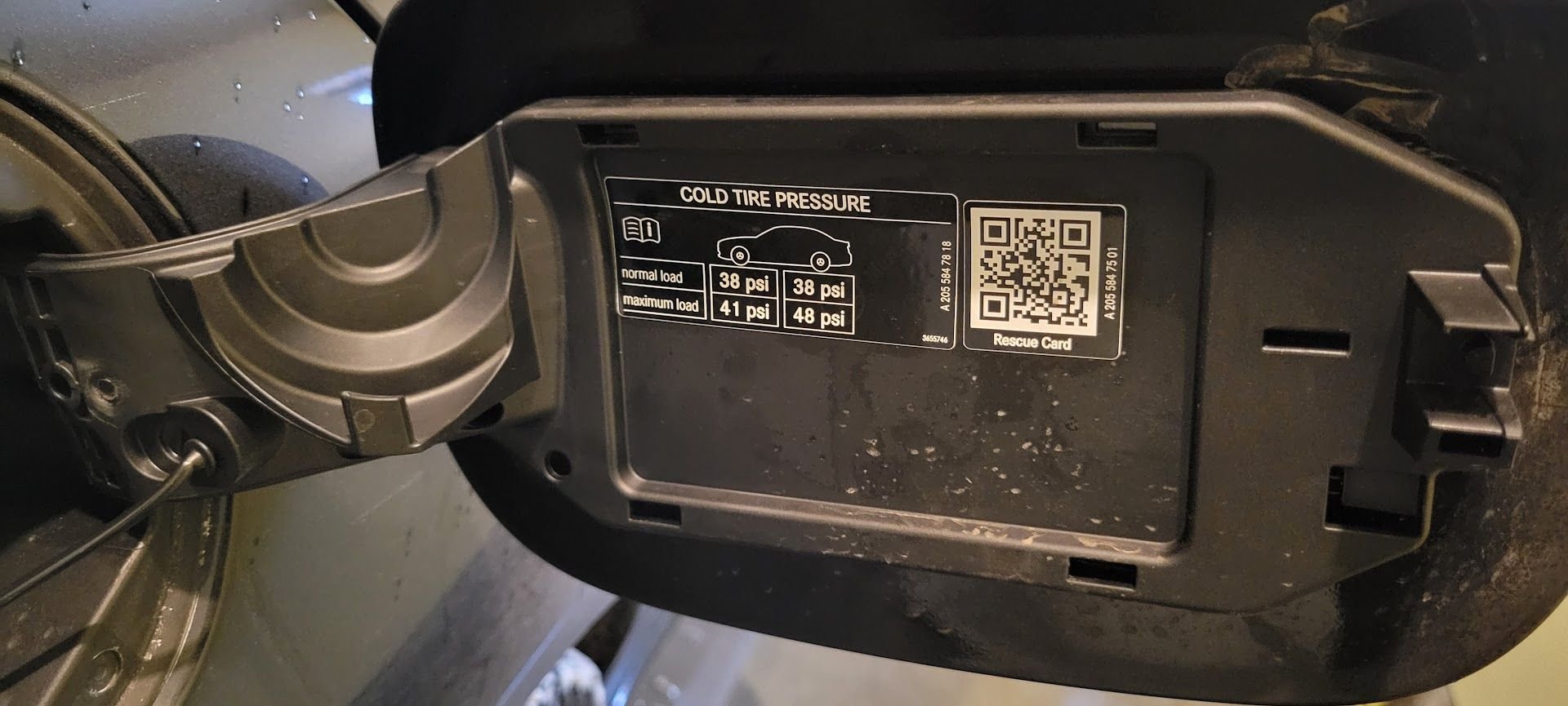

Here is the door, 38 / 38 all around suggested. Gotta tell you ride is darn stiff and jumpy. What do you run yours at?
Fun Fact: Asked 3 different MB dealership in Provence and Quebec and got 3 different suggestions for tire preasure.
1) Leave it as 38 all around (The dummy response without even wasting 1 sec)
2) Leave it at 34 all around but only for winter
3) Put 38 or higher since cold weather can reduce the tire pressure??
4) My own opinion, leave at 36 all around? lol

Our calculations were not wrong, if you stick with 45 offset staggered (Typo: I meant squared) is the way to go but since you switched to ET 40, your shop wasn't lying that it might come in contact with the suspension components. Was there a reason that you changed the offset at the last minute? They ran out of ET 45 wheels?
That is strange, your tire pressure sticker is missing M+S. I have a C 43 and pre-facelift so I am not sure if my tire pressures are helpful at all. As the torque split is different and the C 43 tends to favour a bit more sportiness over the C 300.
That being said, 35 is my recommendation sweet sport for a C 300 in winter. I am not sure if my recommendation is good enough though. Ya you can do 36 if you want, so do that.
