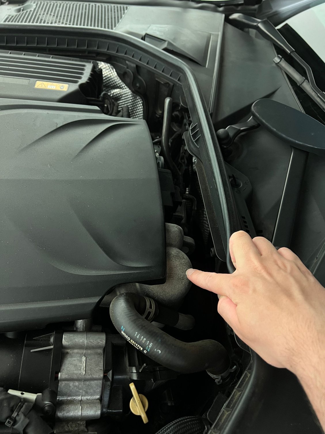

So I managed to locate where the sound is coming from. It’s coming from this part here at the back of the engine. Does anyone know what this part is called?
that is the high pressure fuel pump.
