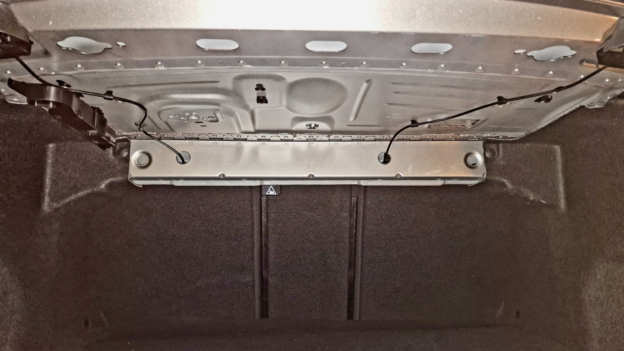

First I thougt ex owner did something until I watched a bunch of videos with all the cars being same, is it possible and for what reason would mercedes not put the lining on the roof of the trunk(inside), it's all metal
This looks ridiculous.

Hi I dont have the same lining as your trunk. Something is missing in your trunk.

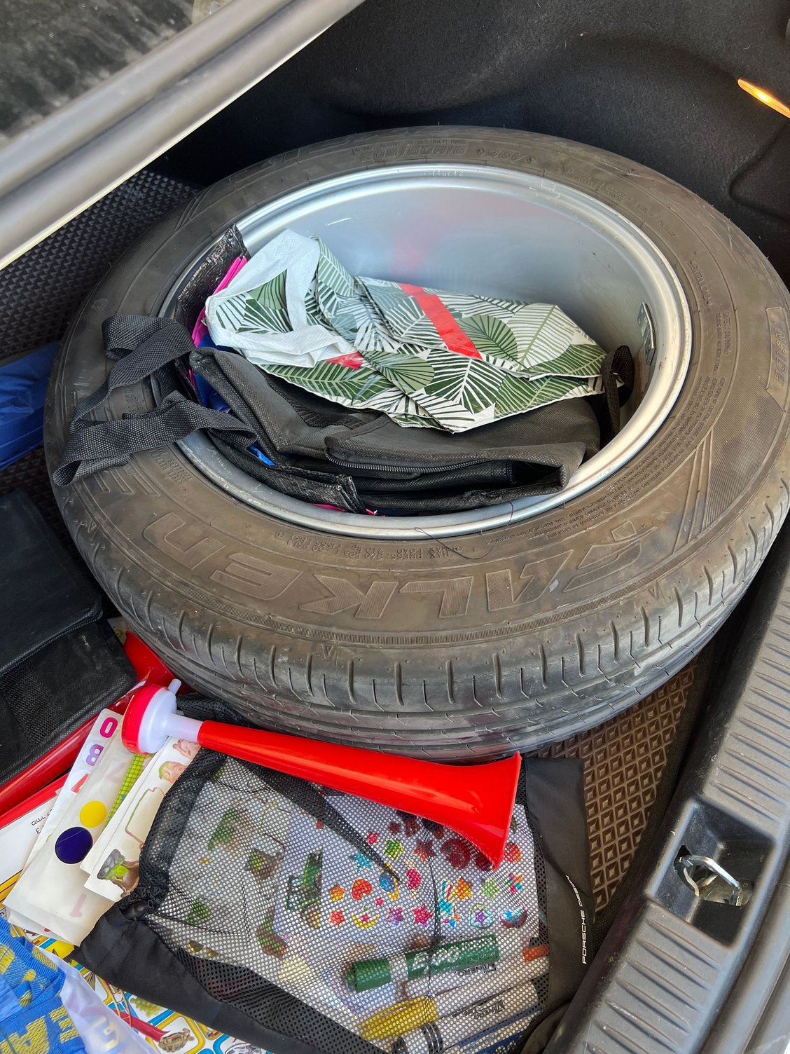

I Bought a space saver nonplace to fit it because the car came with run flat tyres. Our German engineers should have gave us a space to place the space saver if the owner decided to replace the run flat tyres.

Idk maybe it deoends on spec or something, I watched 10 w205 facelift videos on yt and all were like this, weird but oh well.

As for spare, I'll have to think about it, I need trunk space but also i do have roadside assistence that would help hm.. we'll see

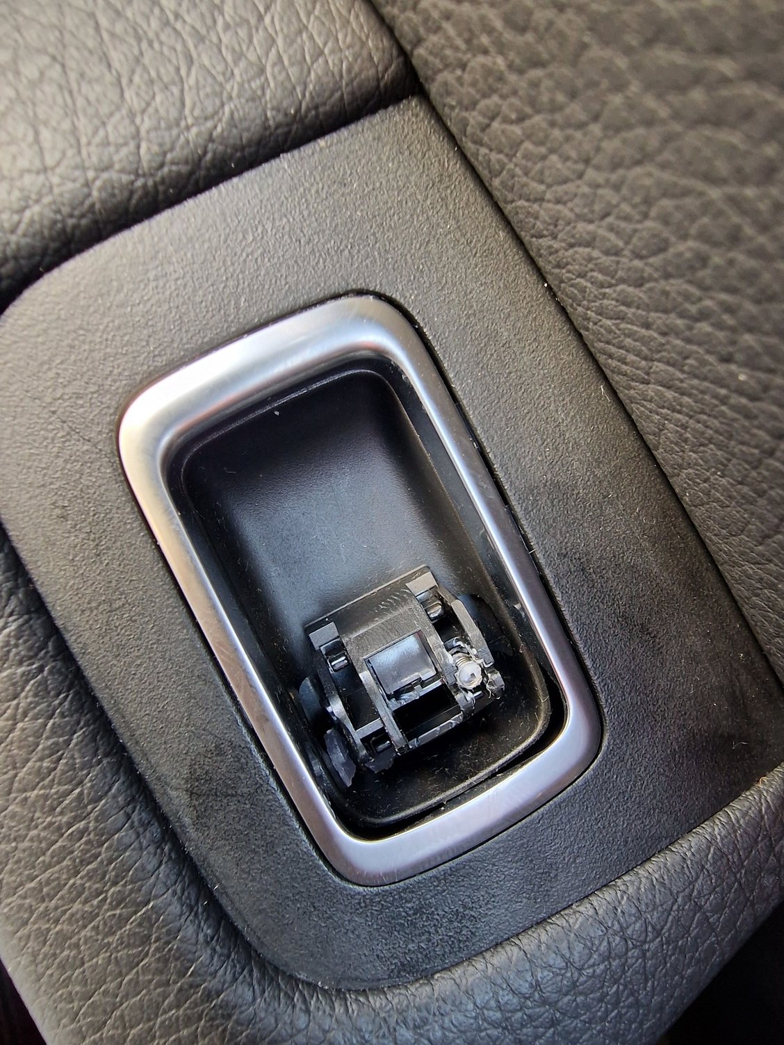

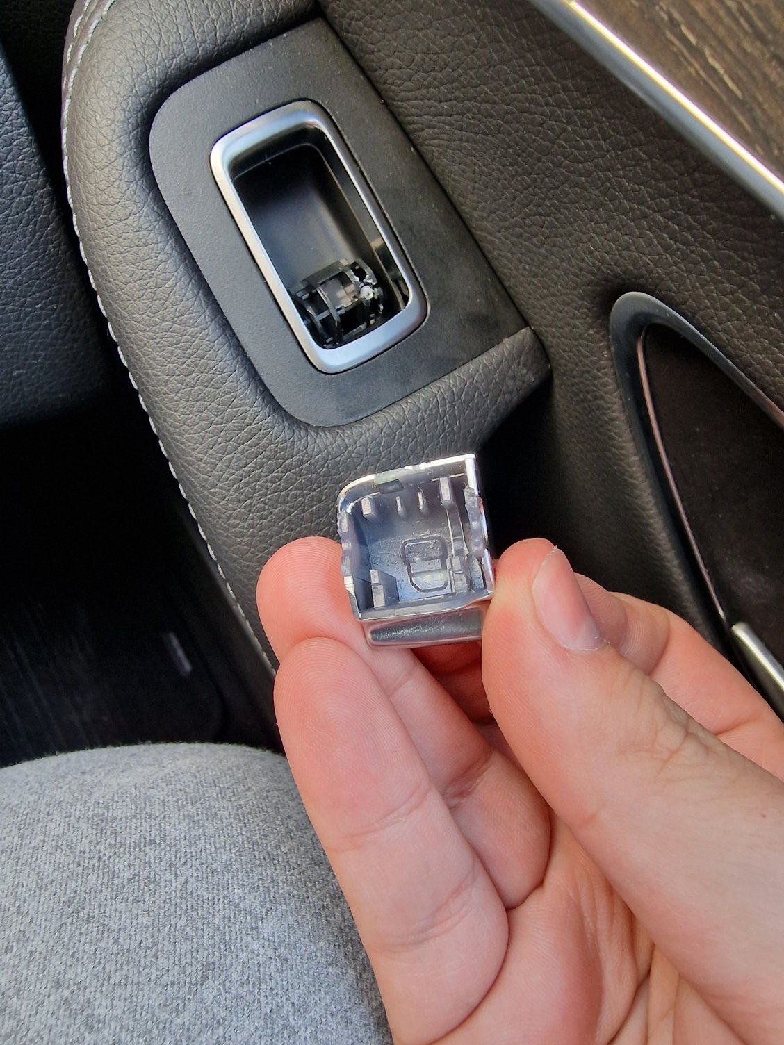

I will go to local dealership because I just discovered passanger window button is broken too sigh, so much for eveything is perfect

you probably asked your self about the pro and cons. I decided this is the solution for me when I was dragged out from home to where the car was waiting to be rescued…
