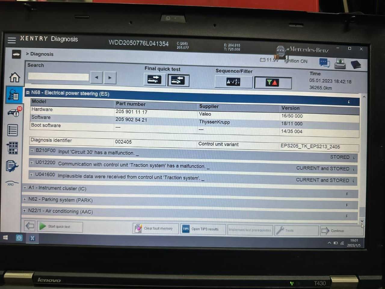

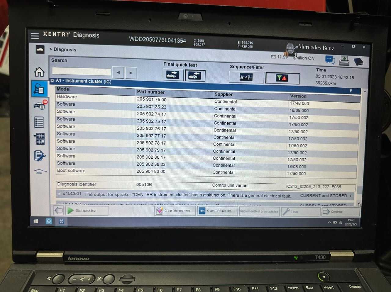

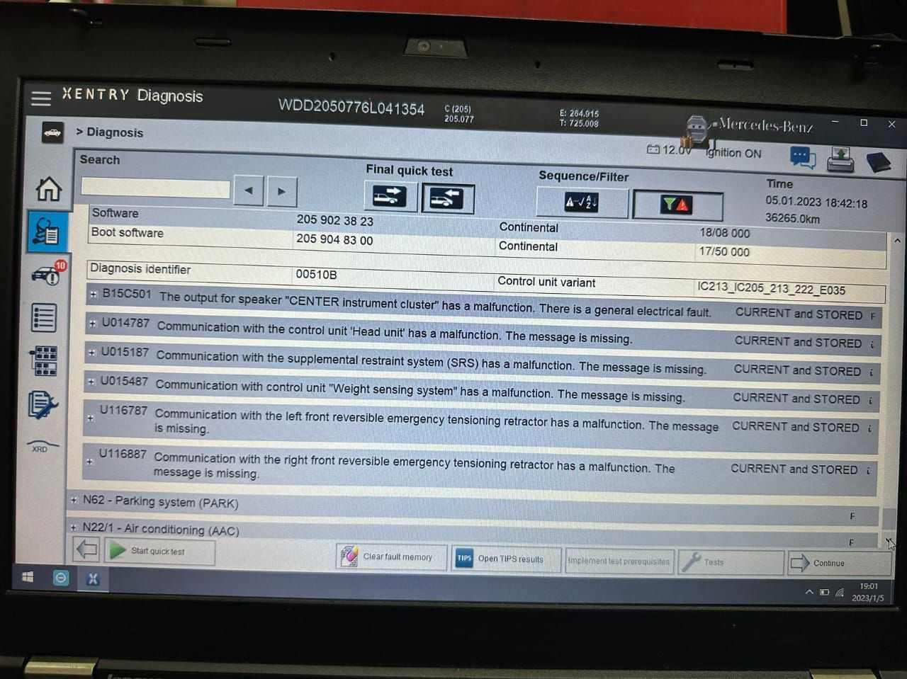

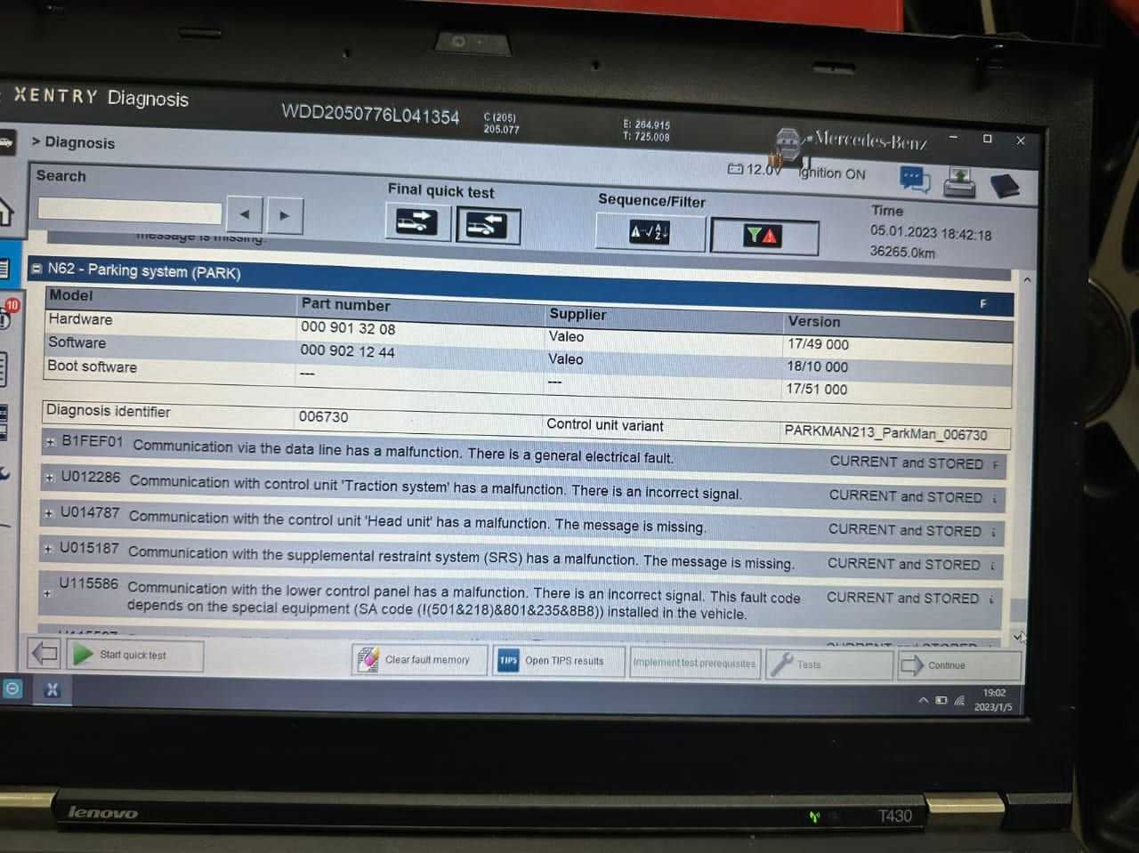

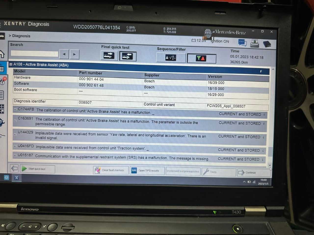

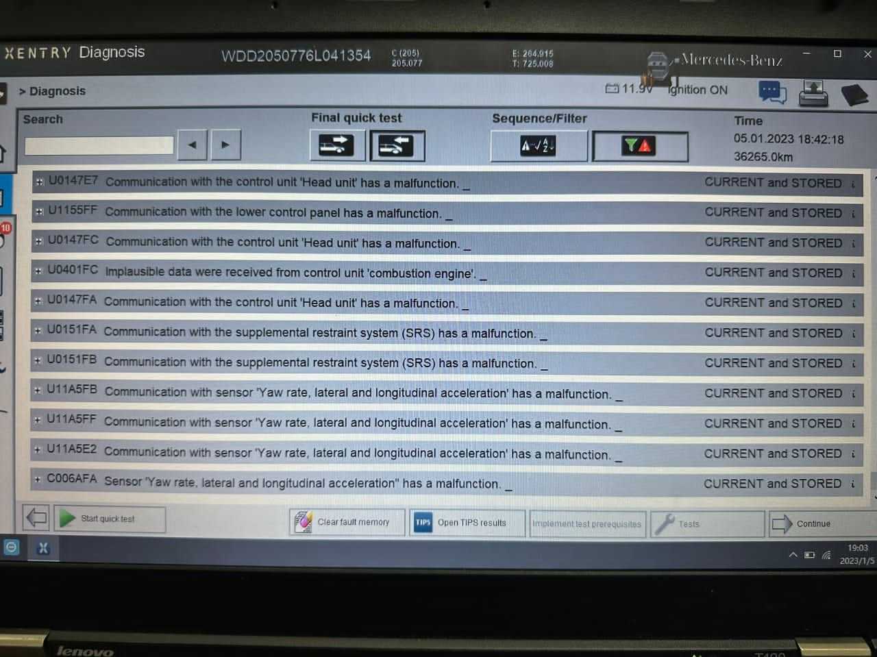

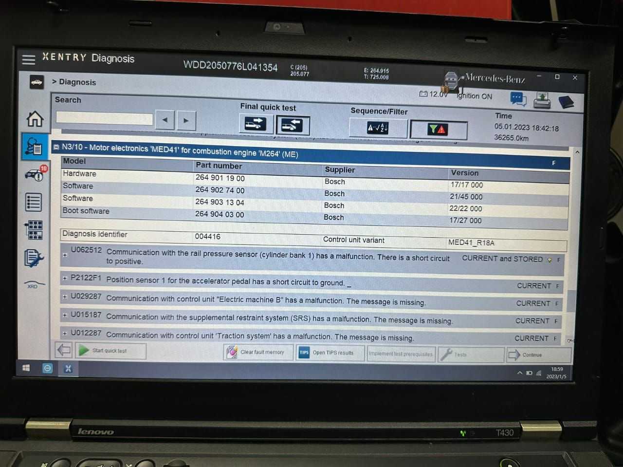

hi guy i really need some help on my flood car 2018 c200 1.5t with 48v EQ boost
i have been repair more then 1 year but my car still can`t start normal ,

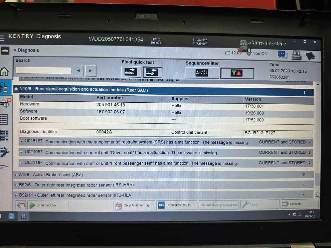

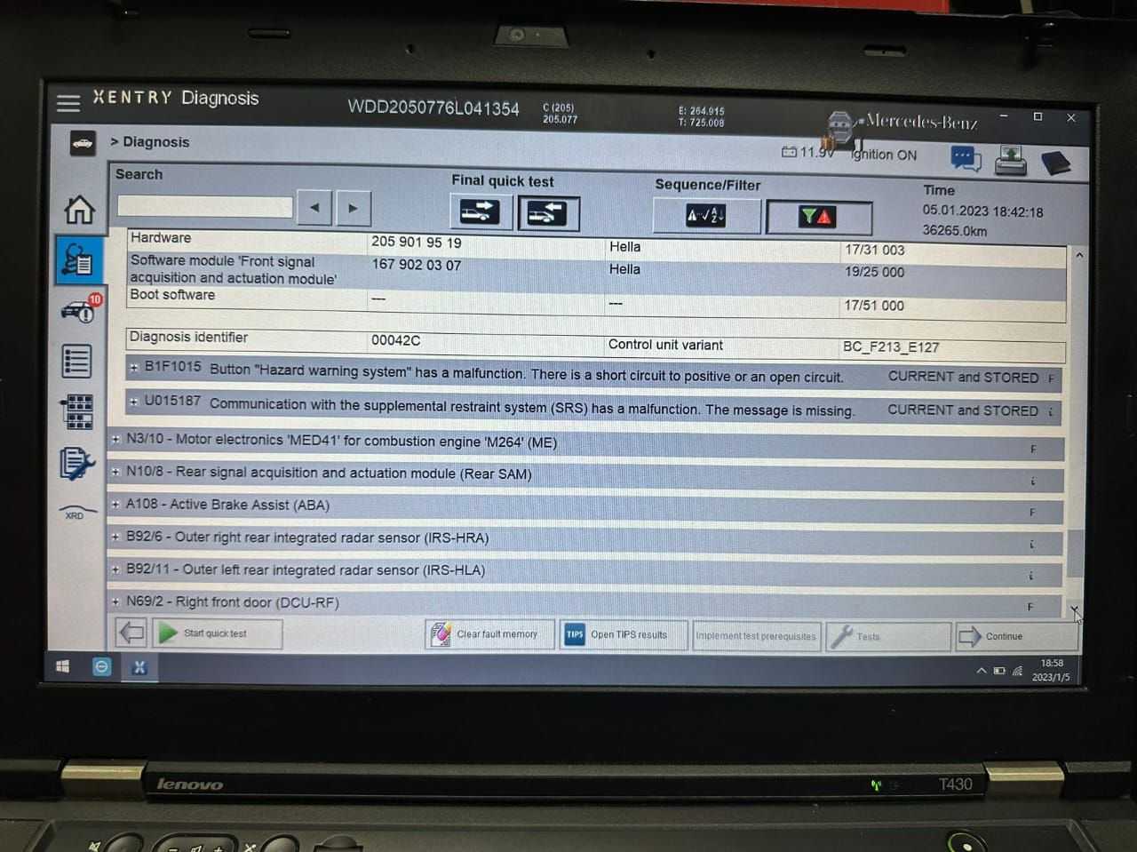

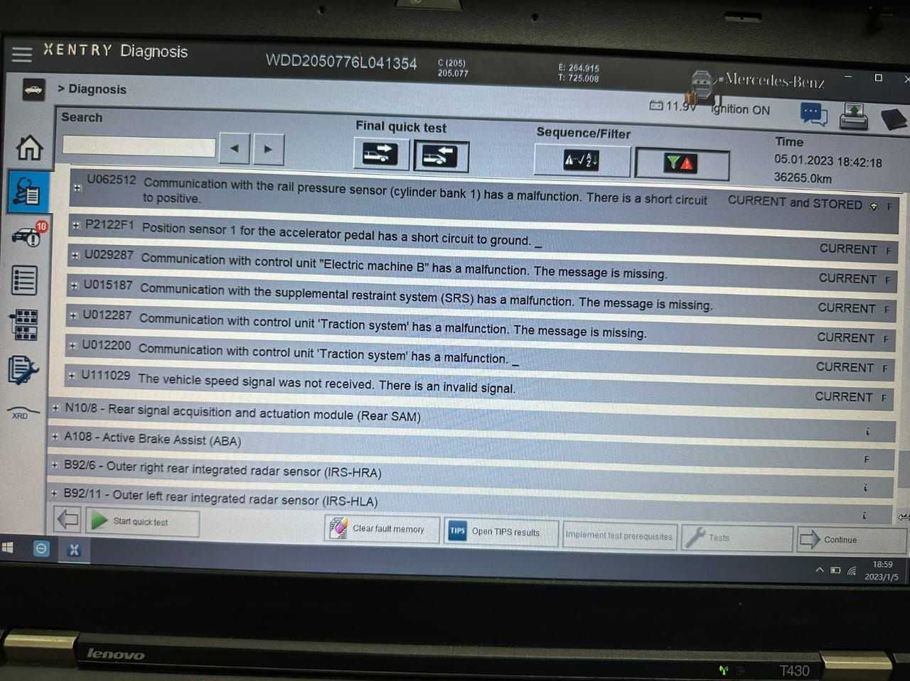

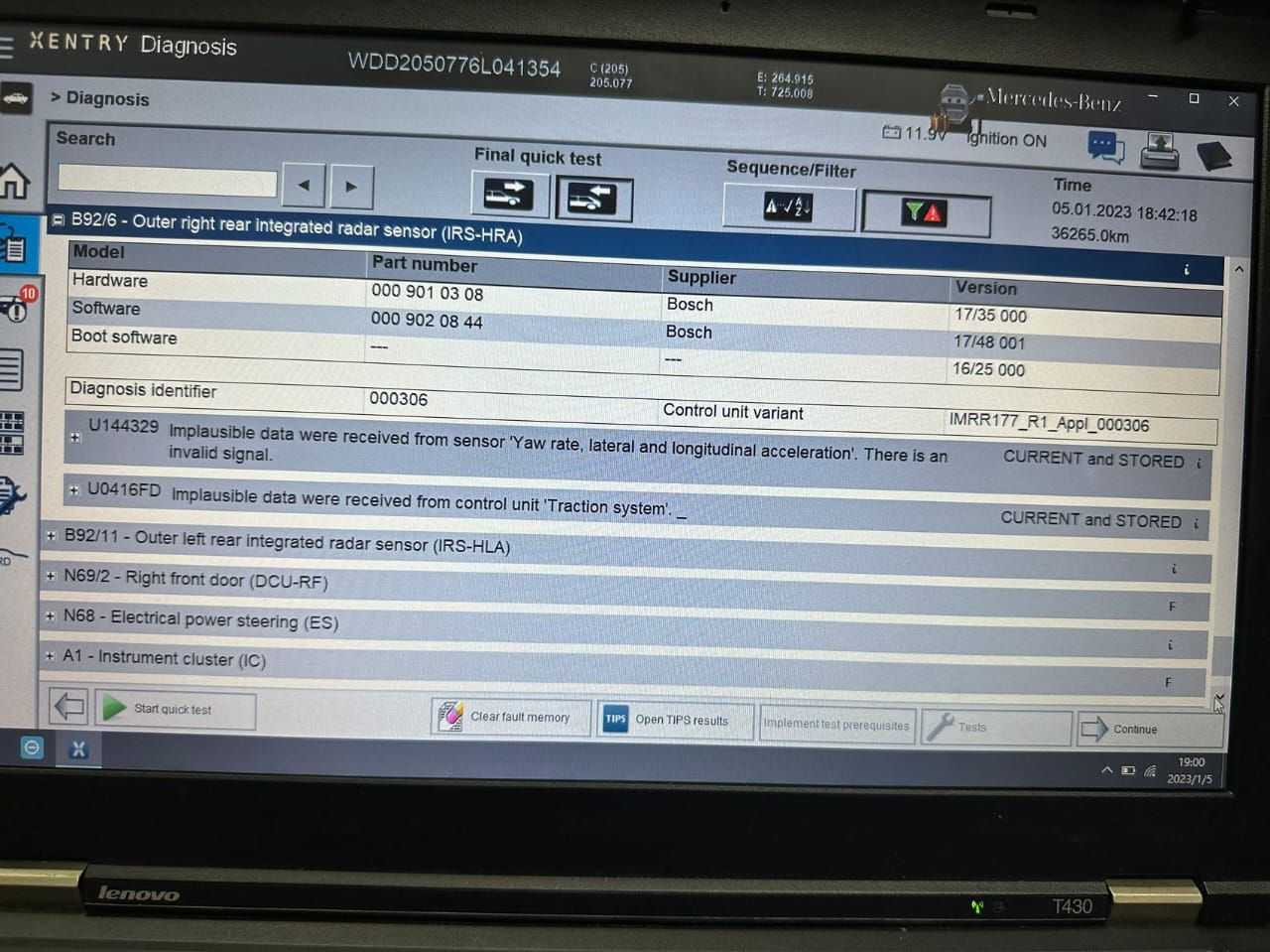

First I clean the sludge from the car and dry it ,after everything dry i rebuild in , headlight and interior light all function but my console and cluster not function and push start was not working too .
so i decide to replace new EIS , Front sam , rear sam and bcm , after that cluster have been function and can crank few time and show up an error on my 48v battery and fuel pump and i decide replace a new one
after we change everything and try crank again its start like 2-5s and dead again , so now we have check fuel pressure around 5 bar and each cylinder around 10-12 bar ,and we can`t find any error code on fixing this problem
on the moment i have no idea how to fix its ? hope u all can help me thank alots

forget mention ECU have check too , its dry
