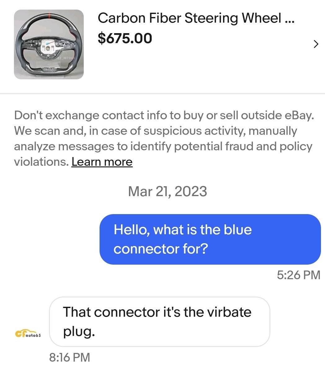

Well, after spending an hour searching images and videos of "Mercedes W205 steering wheel", it looks like the OEM steering wheel might come with that blue connector and it attaches to the right side of the board inside top of the steering wheel.
I am just curious as to what it connects too (speaker, buzzer?) and why there is a duplicate in the aftermarket wheel. I thought everything with wires would transfer over to the new wheel.
I sent out some messages.

I might have solved the mystery? Vibration motor has same plug. But oem wheel has motor in lower silver trim.

I asked a random seller on Ebay. I guess i will have two then. Vibrate plug?

where does the other end of the wire go? pop out anywhere?

Nope. I am tempted to give it 12 volts and see what happens.

it might honestly be for heating...
the vibration module sits at the bottom and goes through the bottom trim. looks like the wheel doesnt have one installed.
my money is on heating element

Well, two votes for extra vibration motor
From original seller.

EDIT: I finally connected it to a 12 volt battery. The wheel comes with a built-in vibration motor. (who knew) Bzzzz! Bzzz!
