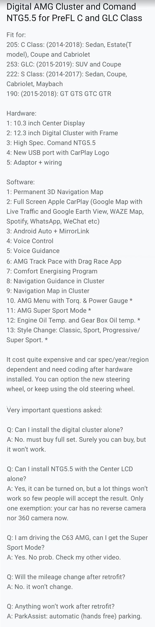

I spoke with EleBest on WhatsApp.
  • He said NTG5.5 for C class. NTG6.0 for GLC.
  • For coding they need you to have a laptop and have TeamViewer installed to allow them to remote in and install the coding software.
  • You will need Tactrix OpenPort 2.0 adapter. Not sure if it's provided free by them in the kit or an extra cost. Not sure if it's a real Tactrix adapter or a china clone.
  • The car owner will be responsible to provide the laptop, install the car parts, transfer the harness wires as needed. Connect the Openport 2.0 and ensure it's working.
  • If you only have 3 color ambient, I am not sure it will still work like before. You may have to upgrade to 64 colors.
  • Stated price was about $3000 USD.
That's more reasonable but still high but he has to make a living. I only have the 3 color ambient (weak) on my 2015 C400. I would only consider for touchscreen. My guest-imate was for used parts although I think you need a new cluster which I forgot about. Found a NTG 5.2 and ran the VIN. It said it had Car Play. Not sure what to make of that.

if yours is facelift W205 (2019 onward) then here you are:
if PreFL: You can do MBUX too, but as you know facelift W205 still using NTG5.5 so perfect software is NTG5.5. If you do MBUX: some minor issues: no C class car image, we will replace it by E class image. No full screen android auto, only full screen CarPlay, if you are Android user.
