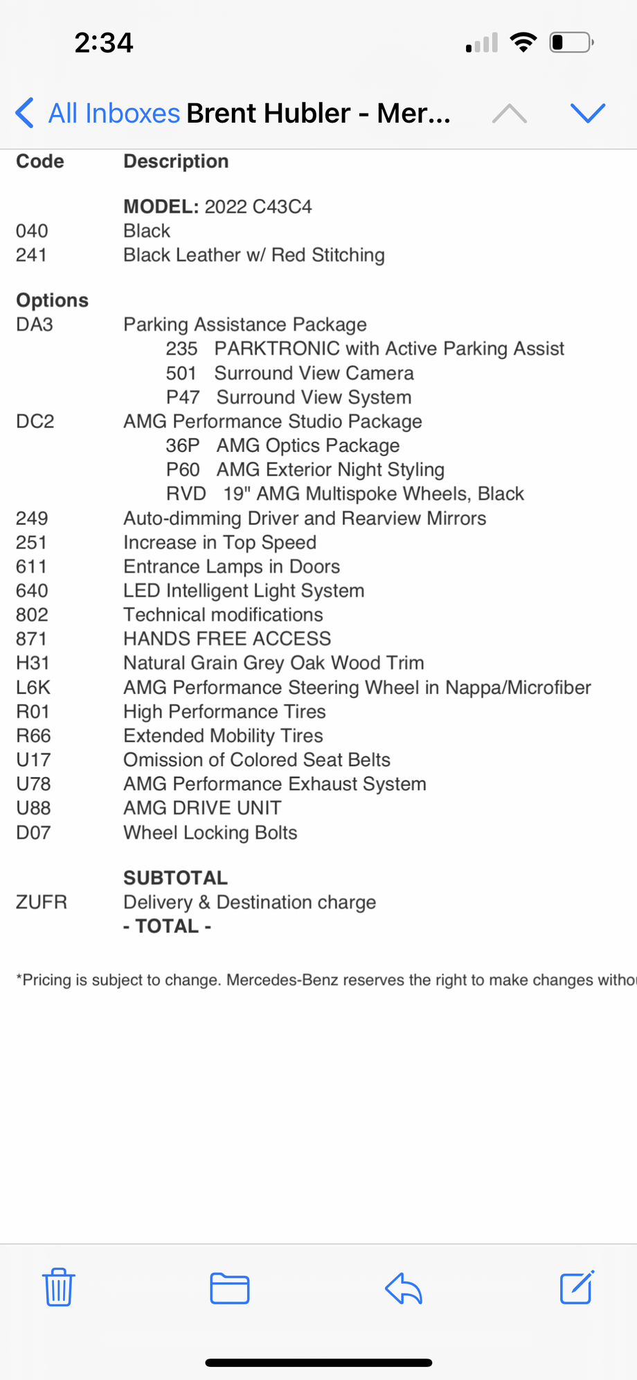

my build sheet has a purchase of an increase in top speed code 251. Online it says the top speed is 135 but I've passed 147. Does anyone know what the top speed is or what all is involved with this option. I have attached my build sheet

Your car was optioned with the R01 High Performance tires, so the electronically limited top speed is increased to 155 mph. The MOE all-season tires have a lower speed rating, so if the car is optioned with MOE tires then the electronically limited top speed is 135 mph. It's all about the tires. The 63 and above models have a pay to increase the top speed option, although it's standard in the USA. The C63S' top speed is 180 mph for example. At some point the top speed is limited by the power. Remember that drag is proportional to the square of the speed, so to go twice as fast you need four times the power and so on. The more power the car makes the higher the theoretical top speed, but again the tires have to keep up. The highest speed rating is (Y) which only says 186+ mph, but doesn't specify how much above 186 mph. That ultimately comes down to the specific tire. Car manufacturers work with the tire manufacturers to make sure the OE tires have enough headroom. That's what the manufacturer designation on the sidewall is for. MO1 and MO2 for AMG vehicles. MO for regular MBs and MOE for the extended mobility tires. The electronically limited top speed factors in the max theoretical top speed and the safety headroom of the tires. Can't go 180 mph if you don't have the power nor the tires to achieve those speeds safely.

Build sheets for Benz will say limit 186 not taking about tires.
I understand how the tires and limit need to work
but if he’s gone over 135, then 155 is the next logical limit.
just go drive and see. Can prob hit 158 with a 155 limiter

Yes, as I said, with the R01 tire option the top speed is 155 mph for the C43, otherwise it's 130 mph (I incorrectly said 135 mph). Also, the speedometer can show up to 10% higher than the actual speed, so for actual speed you need to use a GPS timing device.

Sorry, but that's not even remotely correct. As I said above, the summer performance tire option where available raises the C43 top speed from 130 to 155. That's all there is to it.

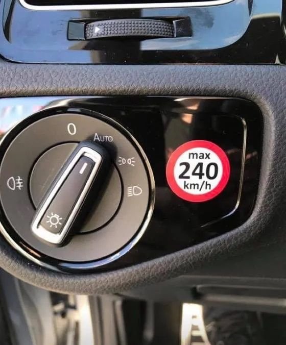

This is what you find in German cars during the winter. Depending on the speed rating of the winter tires it's lower than 240 kph (150 mph). The sticker in my most recent rental car I had said 210 kph max, which is ~130 mph.

Top speed limiter is optioned.
The C43 (FL at least) DOES NOT get the limiter increased based on the tires it is delivered with
its correct that the proper tires are required in order to chose that increased top speed limiter.
where did you find this. Is this for a specific year. I tend to find different info everywhere I look. I joined this forum for all the knowledge on here. Mercedes stuff seems to be different depending on where you look. Car and driver has 0-60 at 4.1 for the fl c43. Bmw seems to have more cohesive numbers and information from one sight to the next.
