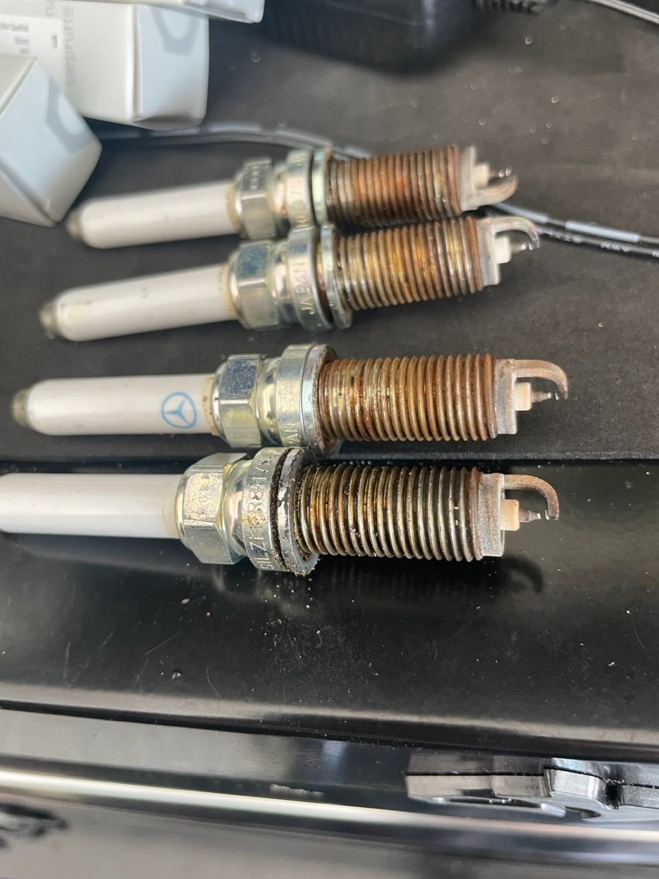

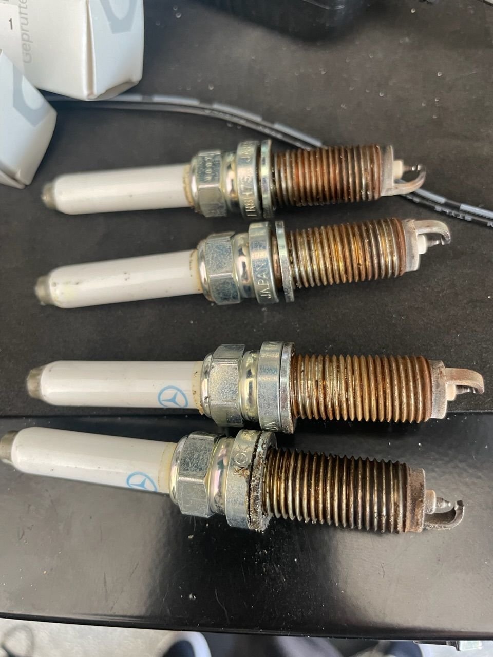

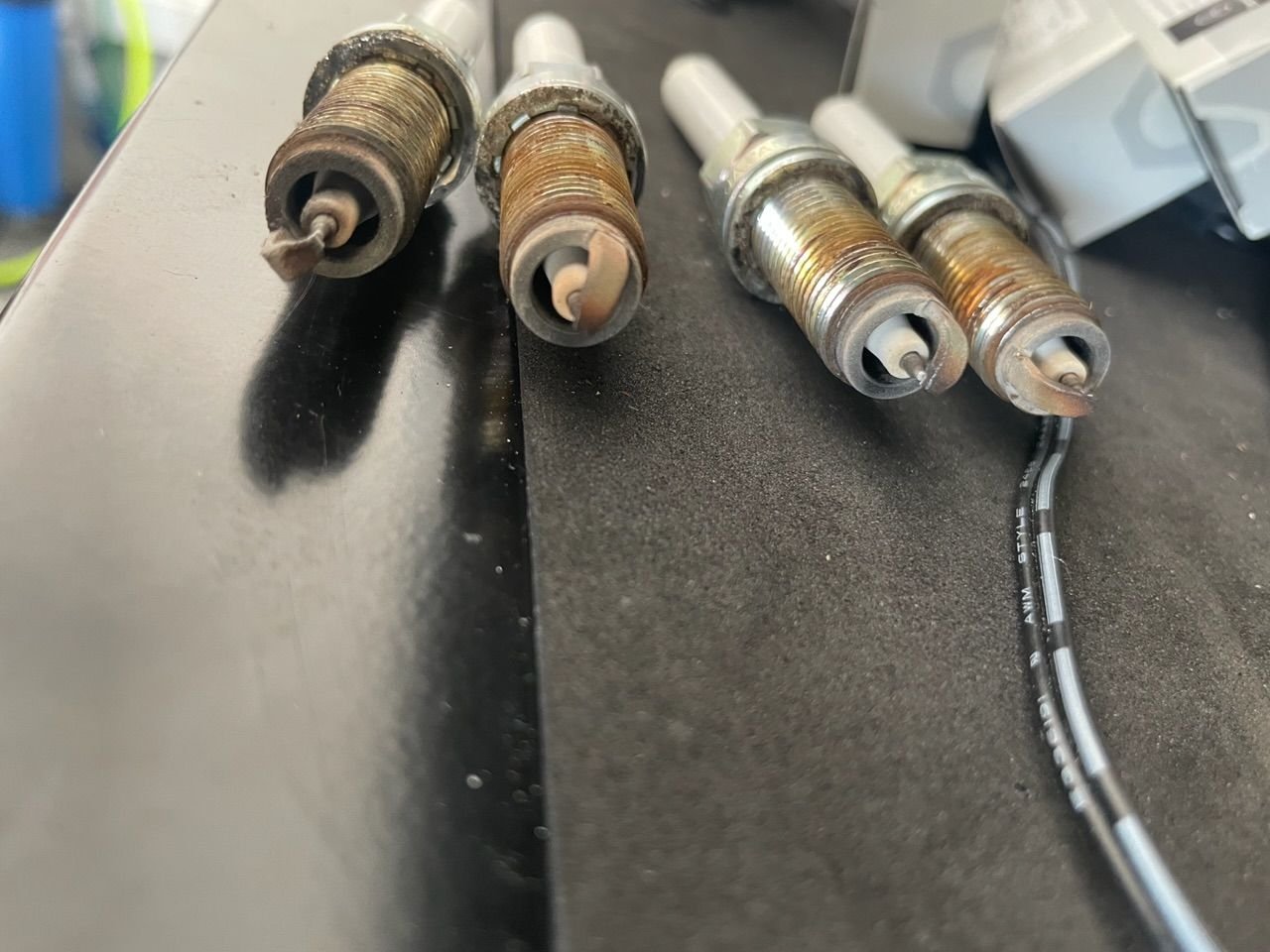

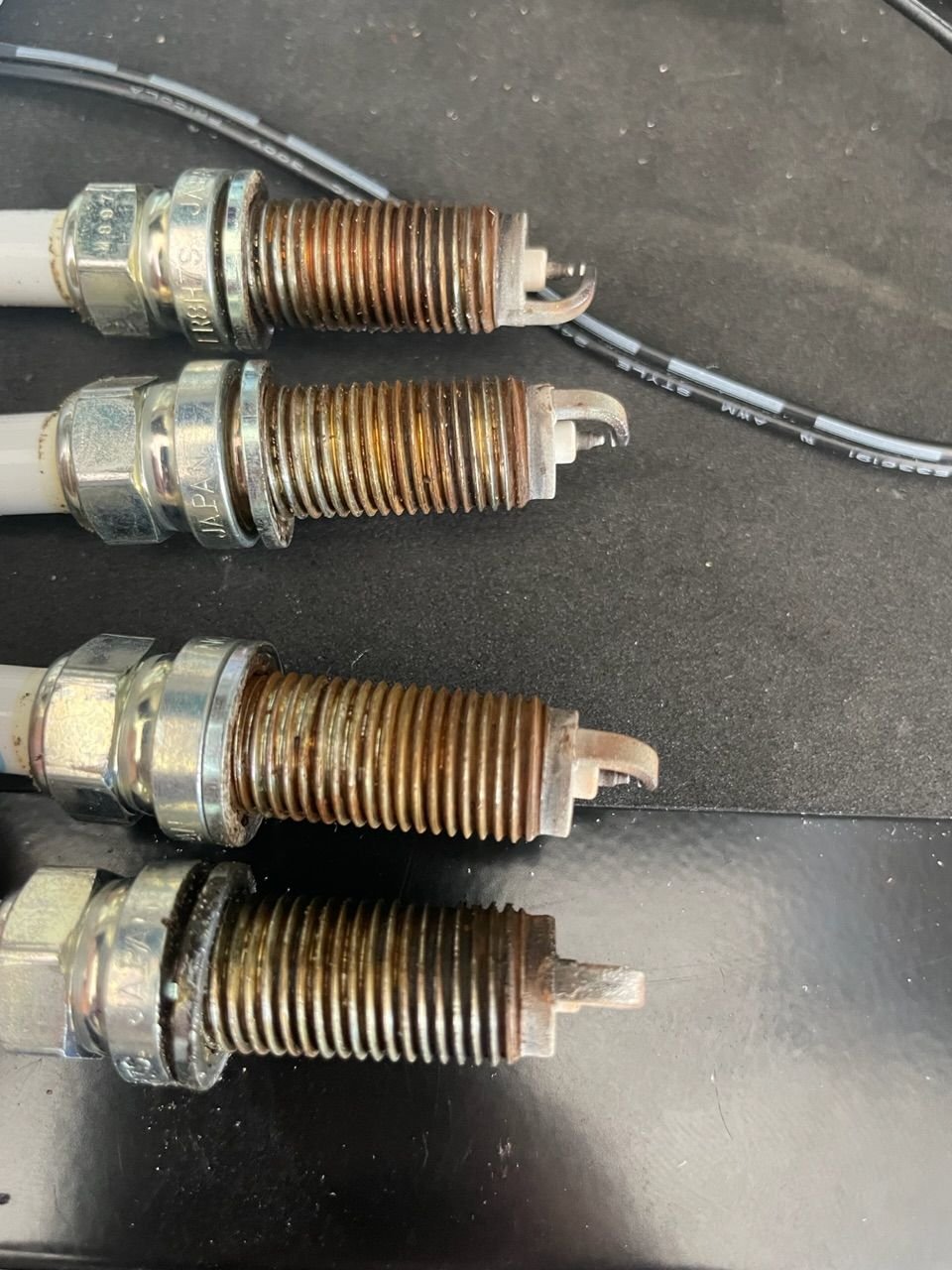

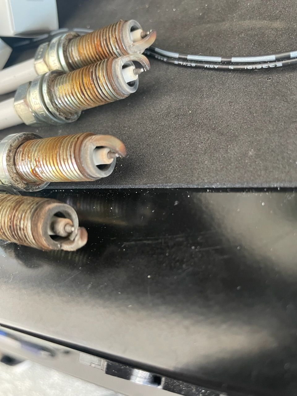

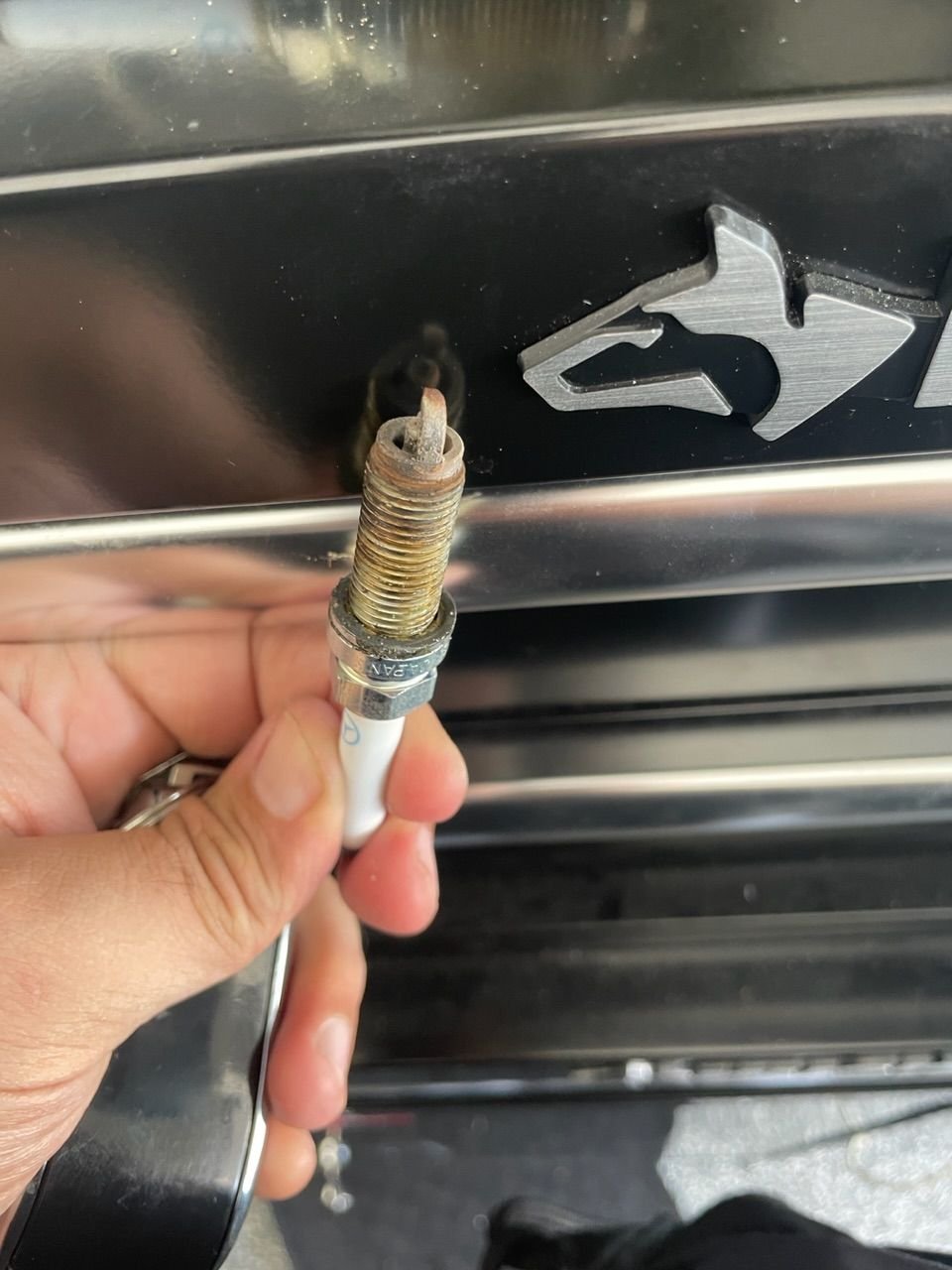

3.5 years later and 41k miles later, I decided to change them again. I was surprised how out of shape the #1 cylinder looks compared to the rest.
continues my thought on performing maintenance on time or ahead of schedule and maybe mitigating piston cracking.
pictures are in order of removal with the worst looking one coming from cylinder 1.
