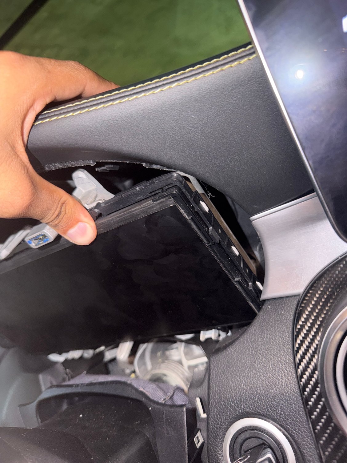

I got my new screen and it won’t fit in? Do I have to trim?

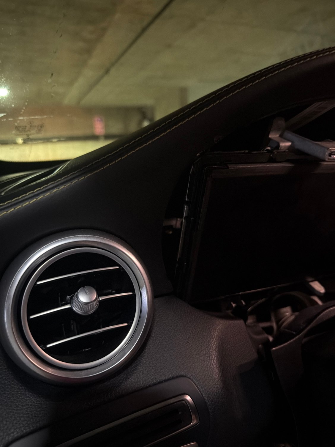

Cluster won’t fit.
Hey my new used cluster from a GLC the screen won’t actually fit. I have a 2017 C63s coupe l

The Original Digital Cluster can be installed natively only on Facelift W205/253.
For pre-Facelift models an adapter and a lot of other parts will be necesary.
