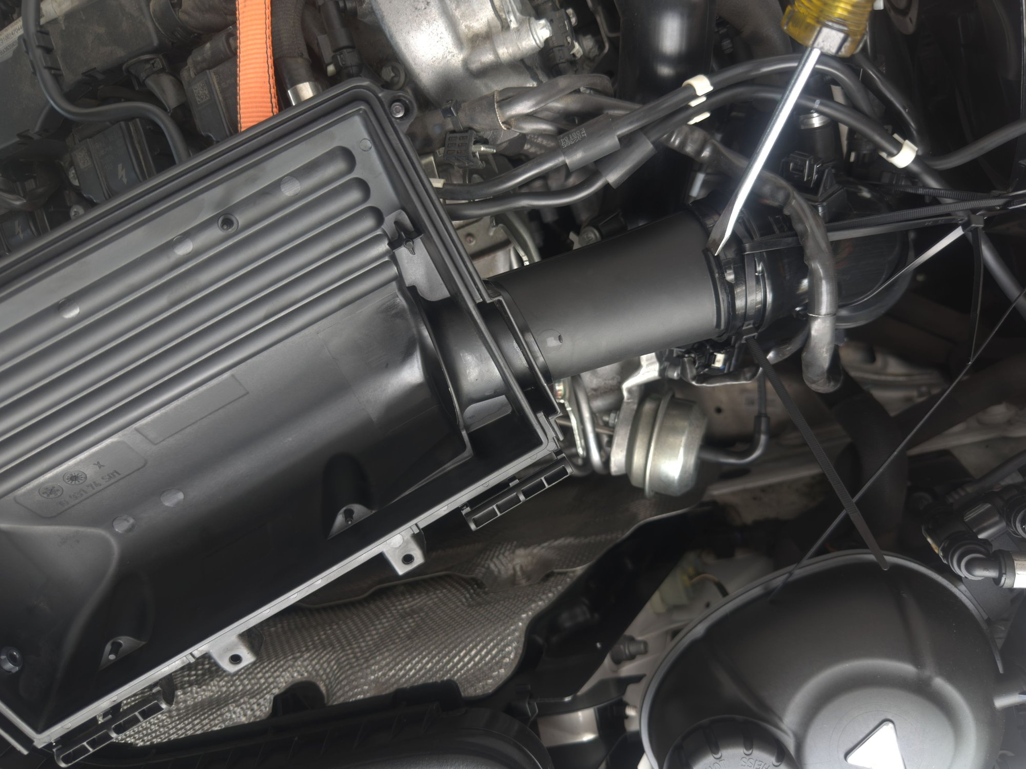

Stuck Air filter cover tubing, will not budge. How?
The piece that is stuck. This goes on top of the filter.
the hose clamp is fully removed. And I used zip ties to get some more support for pulling.
I’ve tried wedging and prying with the flat head. I’ve spun the entire thing around many times now, and again with some lubricant. I’ve yanked on it, tapped it with hammer, used a ratchet strap. Nothing is working. It does not want to move more that what is shown in the photo.
how the fudge do you remove this peice? The YouTube videos that show this process get it out with ease!

Maybe try heating the plastic collar with a hair dryer to expand the plastic?
