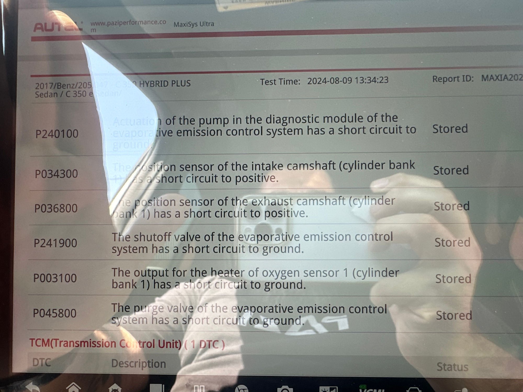

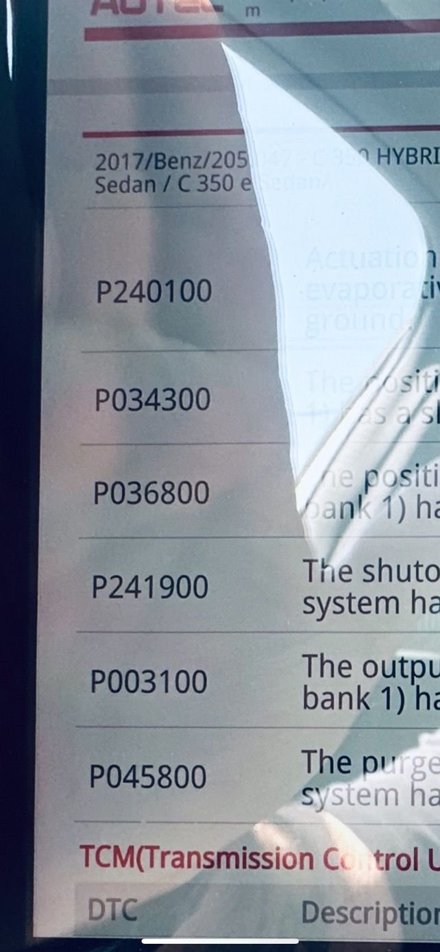

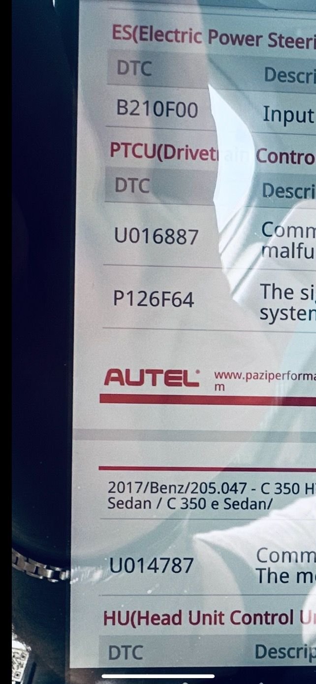

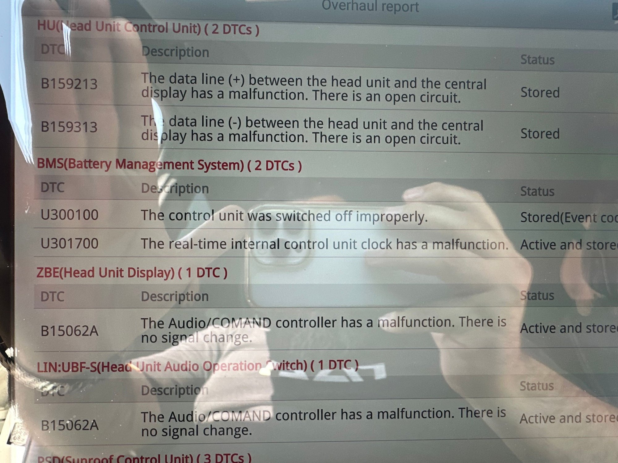

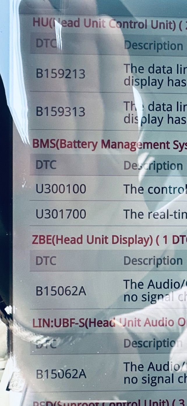

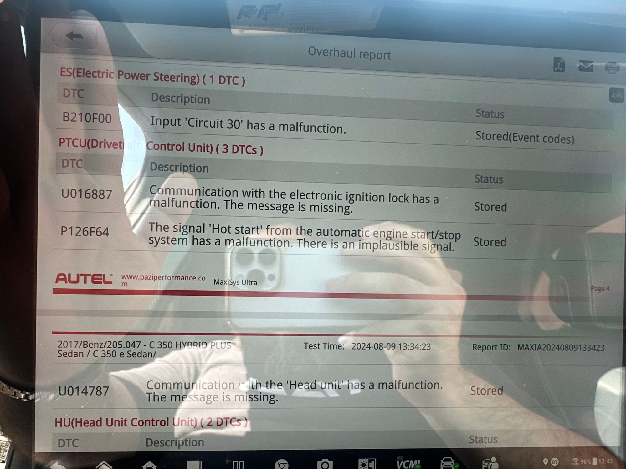

Hello, any help is appreciated. 2018 C350e. I tried to wire the LED emblem without unplugging the battery. SMH. Now car turns on then whole cluster lights up and car turns off and won’t shift into drive. Steering gets stuck! How can this happen by removing a 15amp fuse?! 🆘

Looks like a short circuit.
Clear all the codes and see which comes back after the restart.
Take a look at all the fuses in the engine compartment box, and test continuity on the relays (especially the one labelled Circuit 30).
I have encountered past issues on mine and another friend's car where we had multiple codes relating to open or short circuits, and the fix for us was eventually replacing the relays.

Thank you. Mechanic shop did a hard reset I’m guessing that’s at the ECU and it worked!
