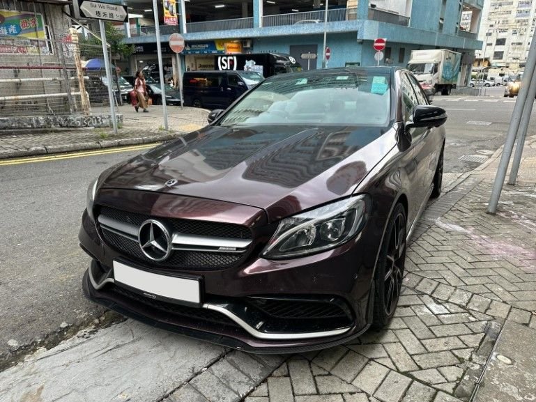

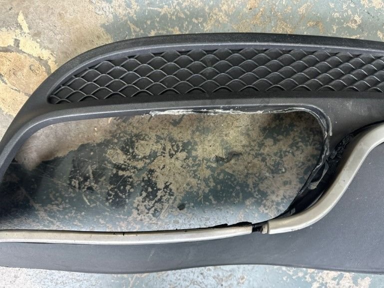

Well, it's more of a repair and upgrade.

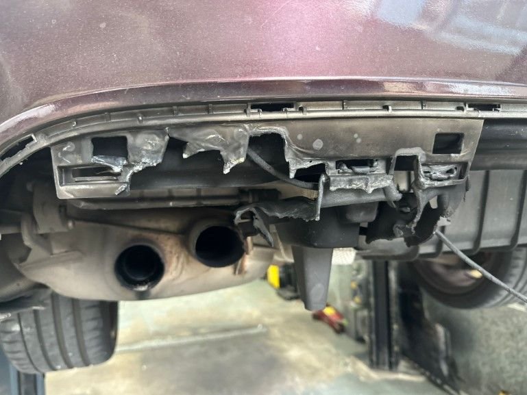

For context, it's a standard W205 which upgraded to C63 style body kit, but the exhaust tips on the left side got a little deformed and the diffuser was also missing the trim.
C200 is a single side exhaust on the left. which caused hot air melt the diffuser and cause this.

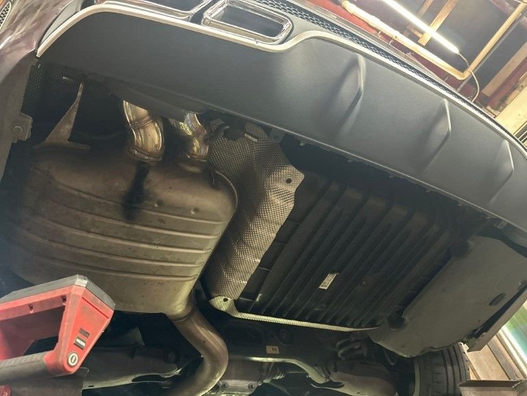

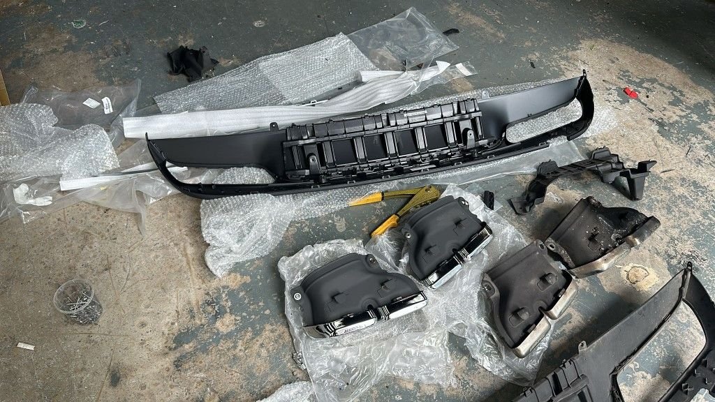

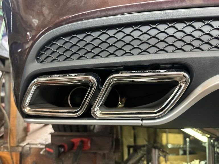

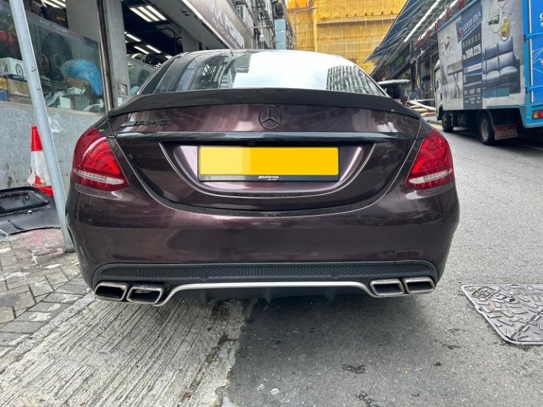

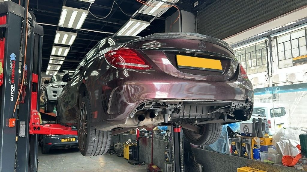

We helped the owner replace a new C63 Style diffuser with tips, but also extend his exhaust pipe into the tips, so the hot air will pass right trough them, to make sure this won't happen again.
