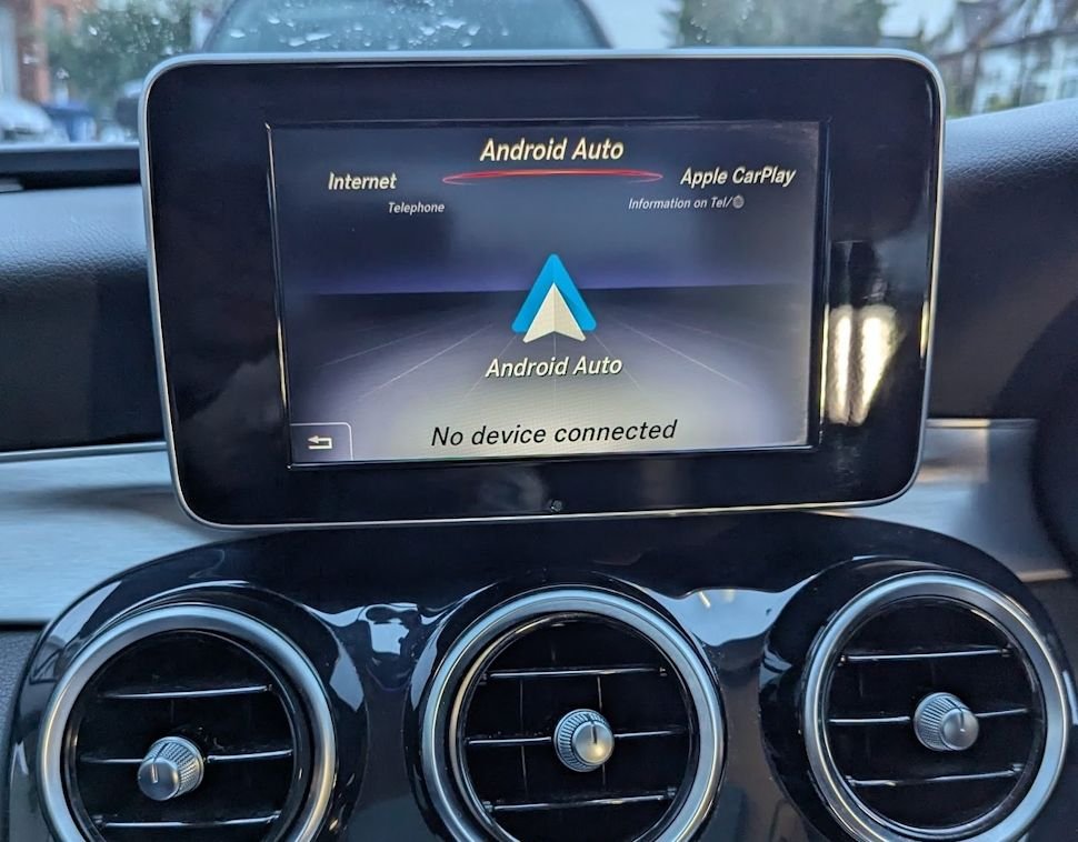

I was considering renewing my c-class to get Android Auto but thought I could retrofit it instead and save the expense. After a lot of research, I successfully retrofitted my head unit in my 2015 W205 to provide Android Auto / CarPlay. The process does not require Chinese gadgets to be installed to emulate Android Auto / CarPlay, only Mercedes OEM parts were used.
I found many different threads that describes some of the process but nothing from start to finish. Anyhow, I documented the complete process just in case someone else finds it useful. PDF document attached.
Clearly, if you choose to undertake this procedure you do so at your own risk.

While this guide isn’t applicable to me, your very detailed document is among the most helpful tutorials I’ve seen in the MB community. Clear, concise, organized, and easy to understand. And you are giving it here to all members for free.
Thank you for your contribution!
