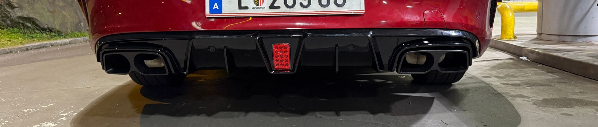

He guys. I installed the Brabus Diffusor on my C205 2016 Coupe. But i got a problem the the tips are somehow hanging and are not straight. Here a photo so you can see how they look. Maybe someone of you got the problem already and can help me out.

you just need to bend and massage the tabs that are used to fix the tips into place. there's pics of my car before and after on here somewhere lol, search my posts. ( I'd do it but on my phone )

i did the install and it looks pretty good now. But the next problem i got is that my Parking Sensors dont work. They beep the whole time with 4 Yellow dots and the jump to full red too. We already tried to modify a bit the diffusor where the sensors are mounted but it wont help. I really dont know what i could do now as they worked with the C43 Look Diffusor.

same here but I think I pushed the sensor in too far, mine are sort of flush and they should be angled up a bit ( Bottom of sensor is almost flush and the top set back a bit \ ) the c43 diffuser I had previously stopped them from going all the way in. I haven't fixed mine hasn't bothered me that much and I don't use the self park feature.

its probably just the angle they're sitting at plus the Brabus one has more of a curve to it at sensor location so sensor point downward , where as the c43 has the sensor sort of pointing straight back.
I back up or down a slope sets it off every time.
