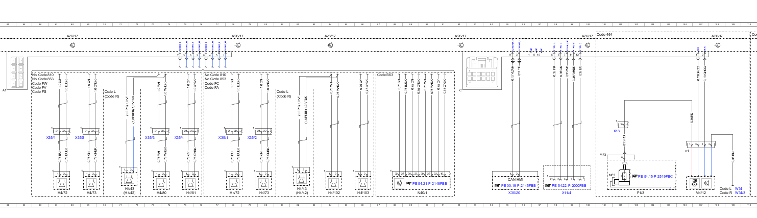

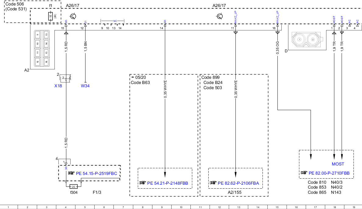

Does anyone have a wiring diagram for the NTG 5.5 rear connections ?
Maybe this?

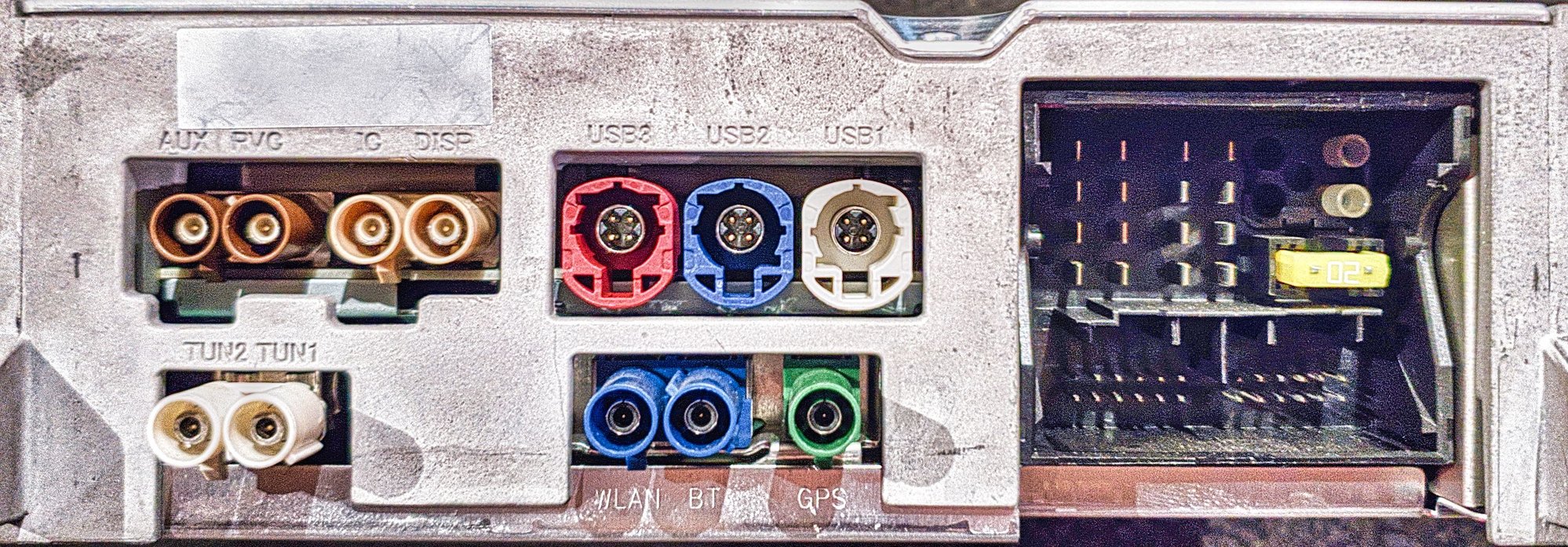

this is the rear of ntg5.5 , looks like your diagram is not ntg5.5
