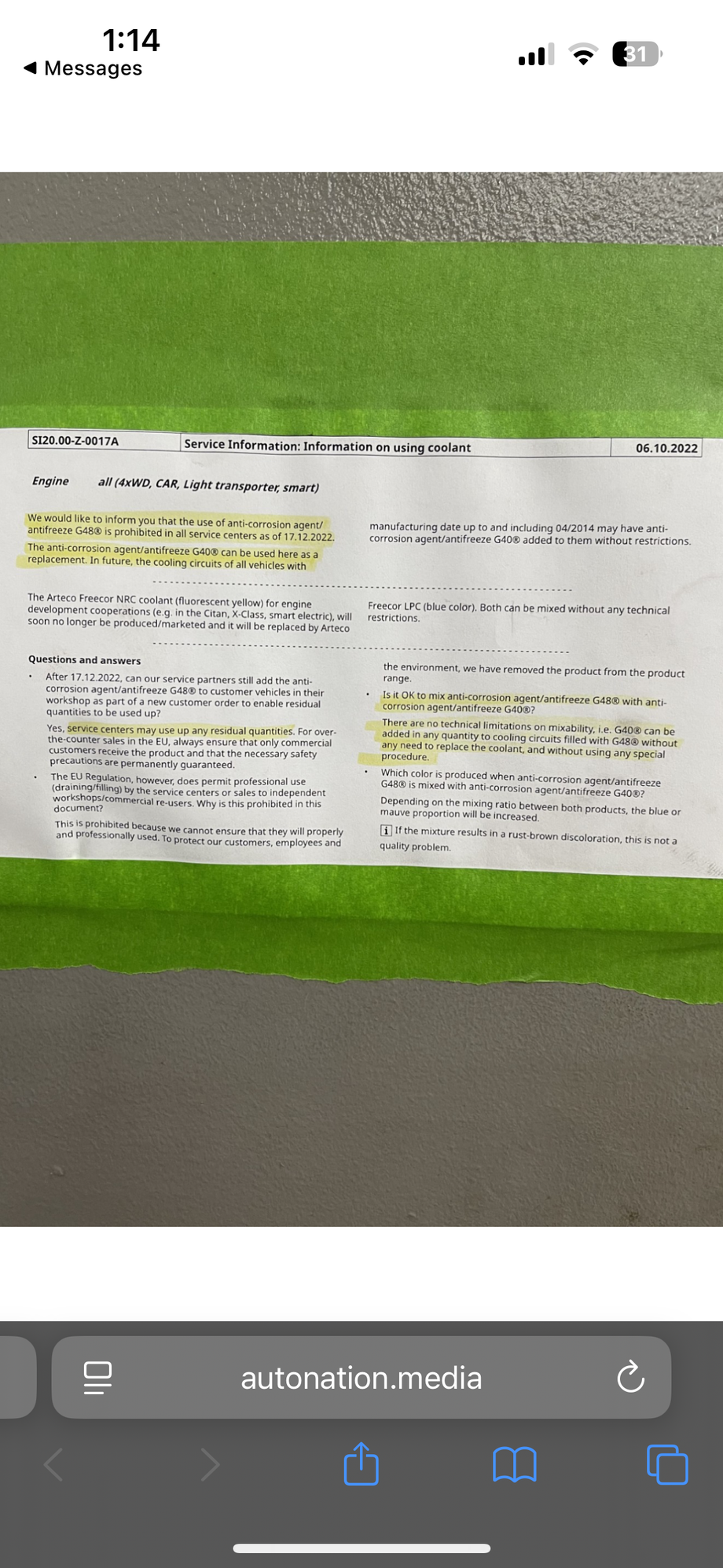

Dealers are limited by regs in what they can sell you now vs a standard autoparts store. This is likely for all shops due to disposal regs. Mercedes has also upgraded their recs to say the new pink fluid is compatible with the blue fluid. Id suggest just topping off with whatever is currently in there, purchased from an autoparts store. The main difference is supposed to be that the new fluid lasts longer. If you need a copy of that rec of compatibility, lmk and ill look for it. I have a 13 and just went through this on my '13.

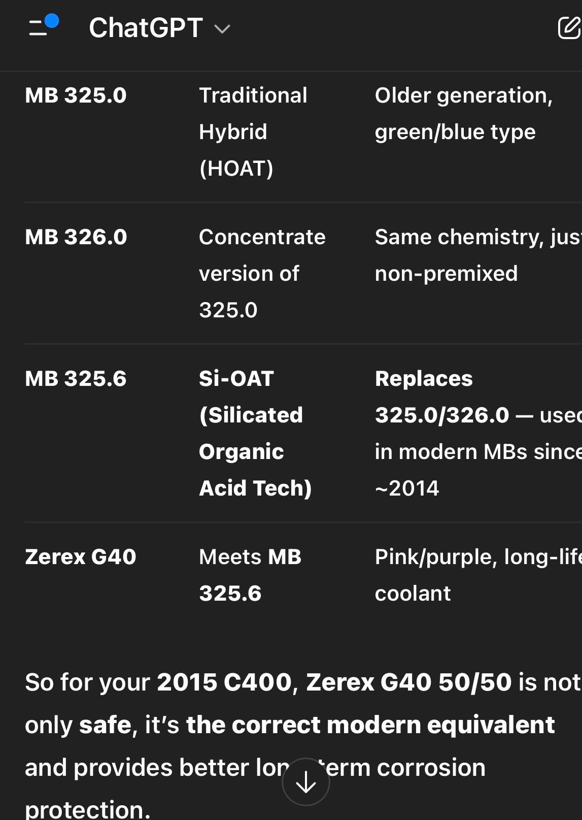

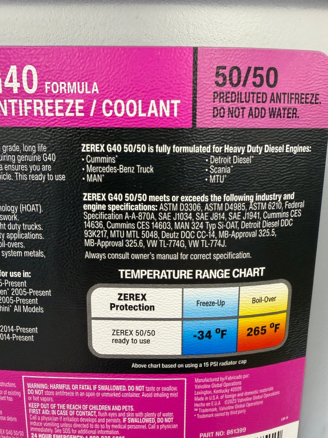

it says MB approval 325.6. The manual says use MB 325.0 or MB 326.0 corrosion inhibitor antifreeze.. so given that this coolant is in between that it be fine 🪿

Yes they have replaced it with Zerex for a few years now.

It cost me $19.74 including tax from O'Reilly. Insane, they are charging $60 plus tax. LMAOOOO.
