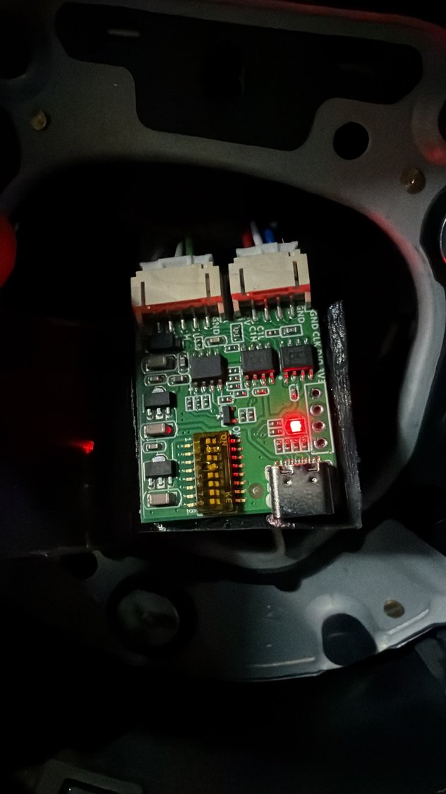

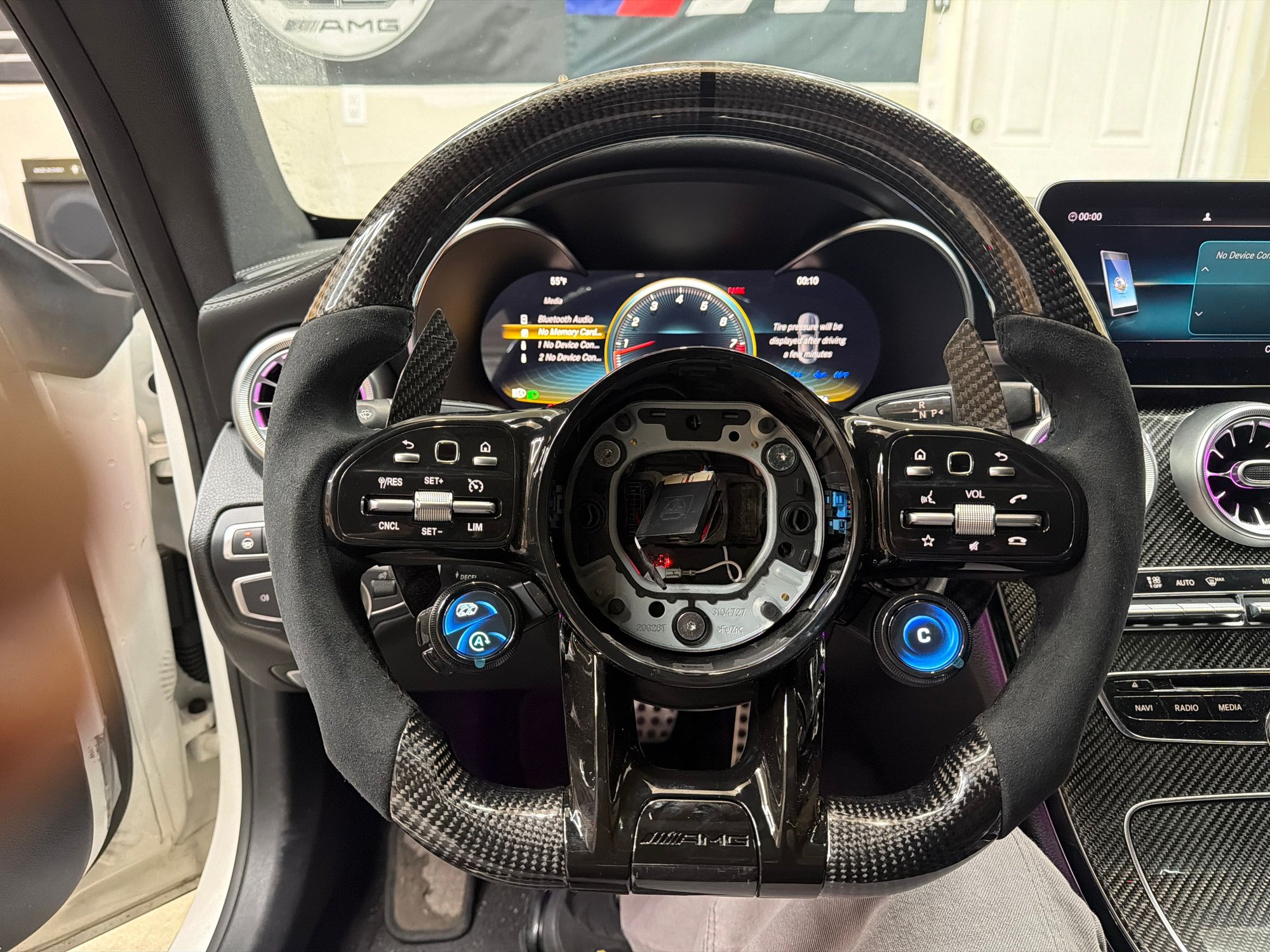

Installed an aftermarket AMG wheel on a W205 C63s (facelift, NTG 5.5). Buttons + click work, up/down swipe works, but left/right swipe doesn’t register. Both touchpads are mirrored (right pad controls cluster instead of head unit).
Wheel uses an 8 switch board. Tried multiple configs. Switch 2 UP disables wheel power, so it must stay down.
Anyone found a working switch setup for full functionality on NTG 5.5, or is this a firmware limitation of some boards?

haven’t seen that board before. But generally with other decoder boards if something isn’t working or like you say is mirrored it’s a coding issue
