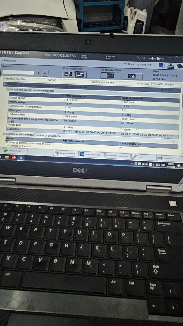

Hi everyone, I'm Yanuar from Indonesia. I have a 2017 Mercedes-Benz W205 that constantly displays a "the check engine light is on". We've tried replacing the VGS and body valve solenoid, but it keeps showing Error P074100
Above is record data p074100
. According to my technician, the clutch torque converter lock-up is staying open, which is a rare issue for a relatively new Mercedes. The official Mercedes garage suggests replacing the entire torque converter, which costs almost $10,000. I'm broke and frustrated. Has anyone in this group experienced a similar problem? Please help 🙏😔
