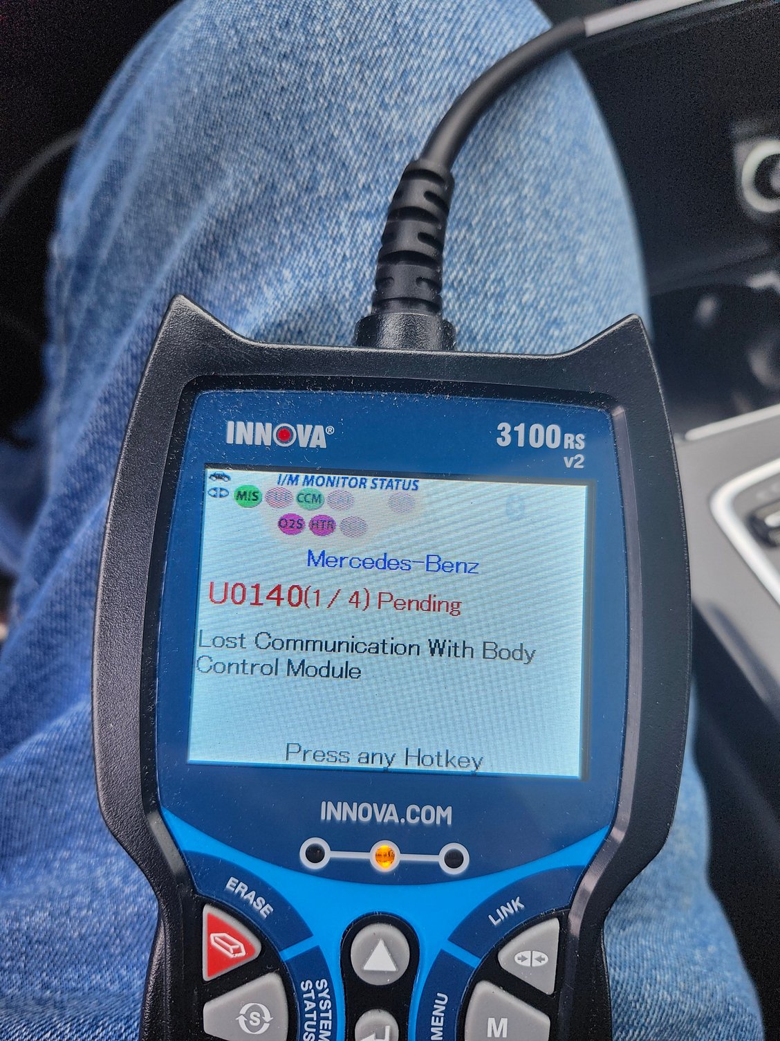

Rear CAN bus also controls the camera I assume then? Also stopped working just before I parked it. I have a scan tool (Requirement for owning VW/Audi).
Yes, no brake hold. My Passat CC had it but made sense because it was 6 speed.
I'll run the scan. I am not familiar with MB codes but can it be something as fundamentally simple as a short? I would have thought the battery ground would have had to be bad to cause a large problem like this on that front.

If you're just running a run of the mill OBD2 scan, it's unlikely you'll find anything useful. You need something like a Creader x431 specifically for MB to pull the CAN diagnostics related to all the modules in the rear.

Thanks for the insight gentlemen. All relevant thoughts surrounding the simple solution. It was a bricked battery. Scanning with a basic OBD tool did only reveal what didn't want to work which included the rear camera before it was parked.
