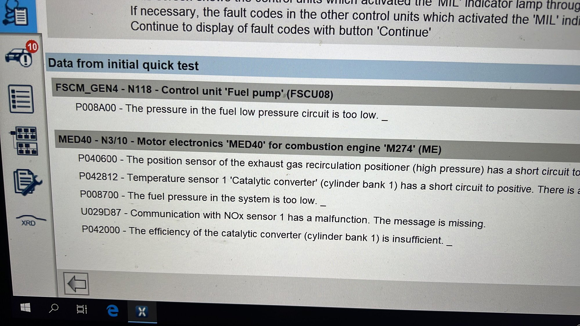

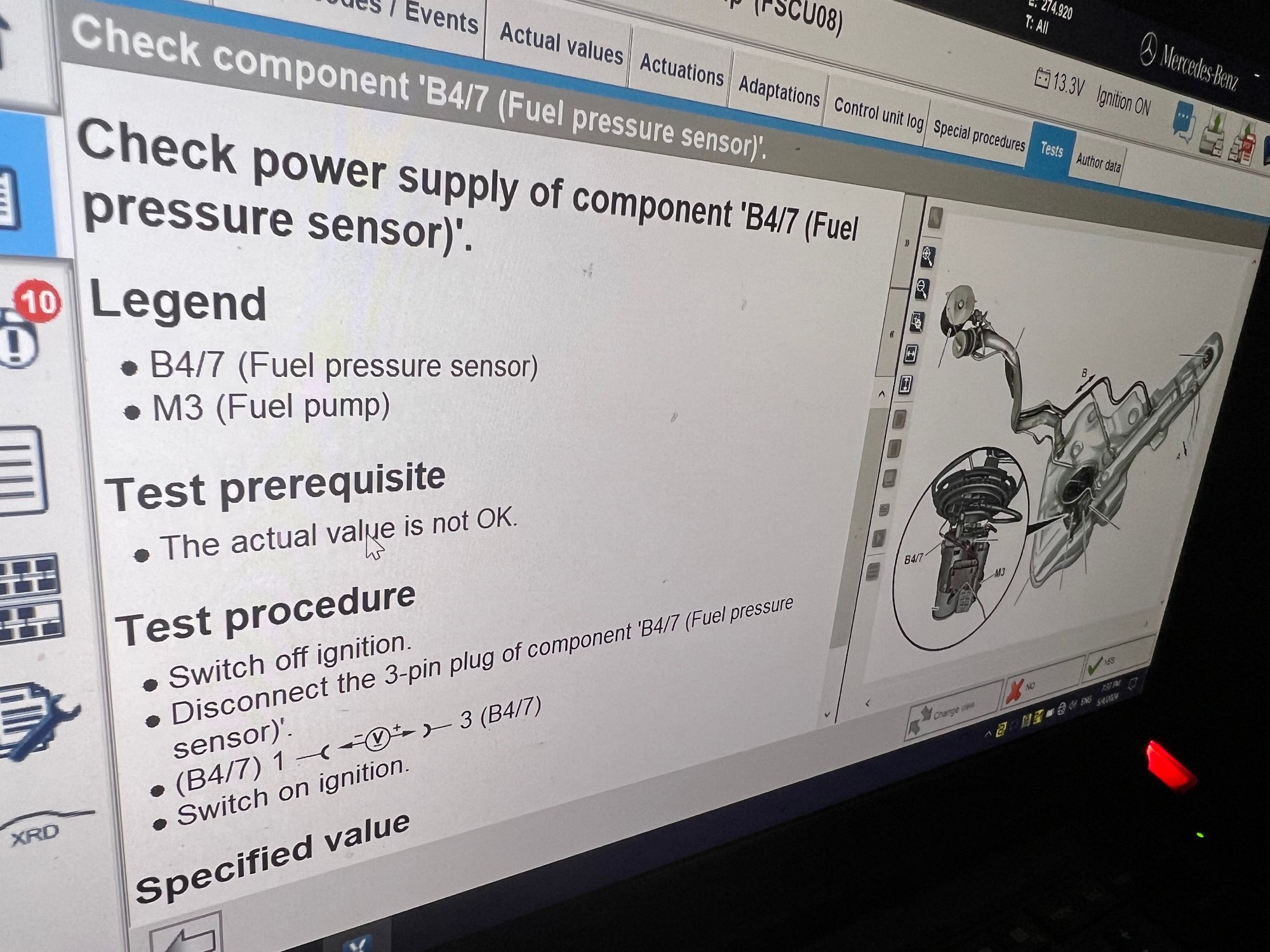

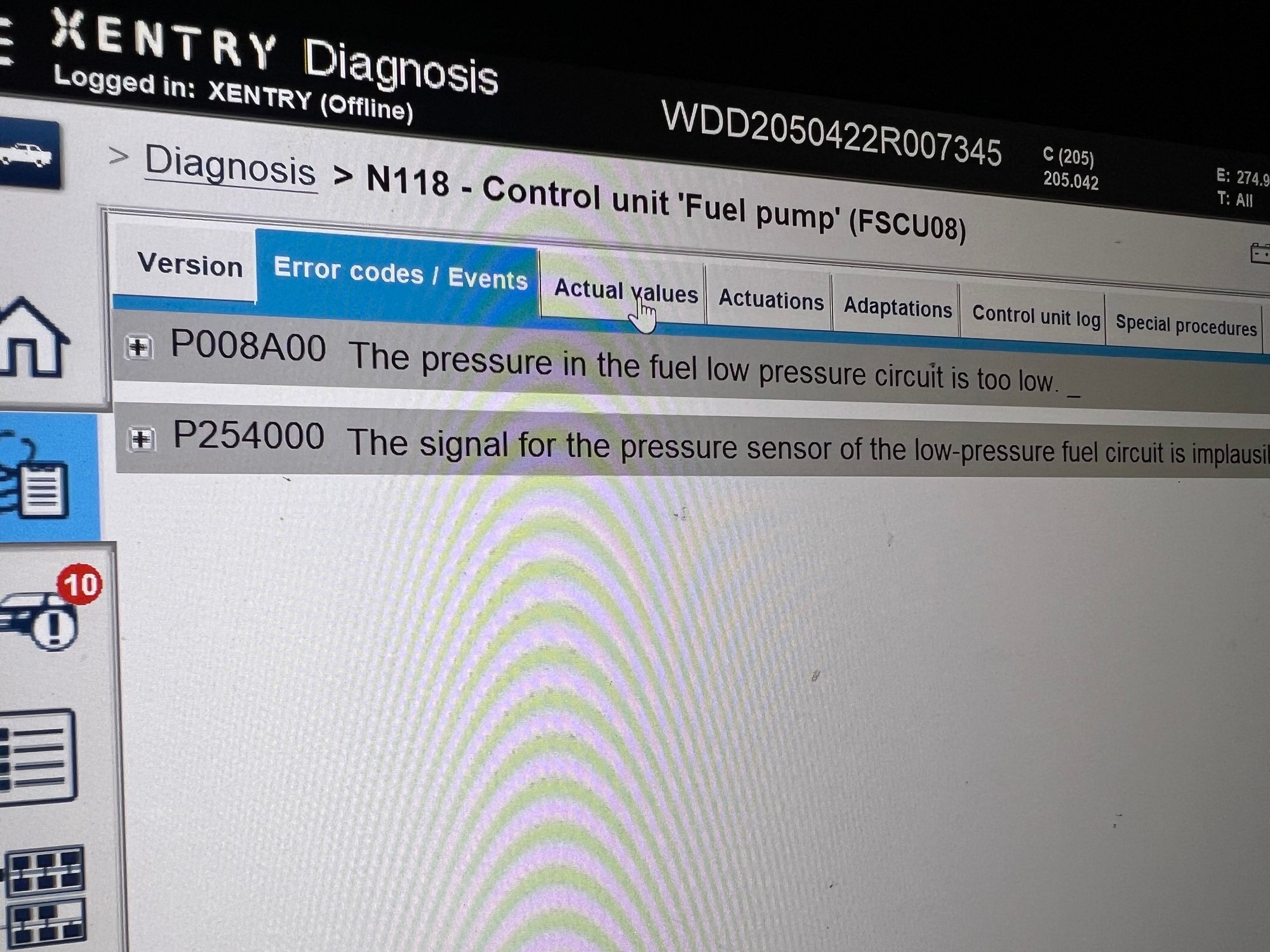

Anyone who has encountered an issue with a W205 M274 continually losing power after some drive. From the scan am getting the errors below and i have already changed 3 petrol fuel pumps with no change
