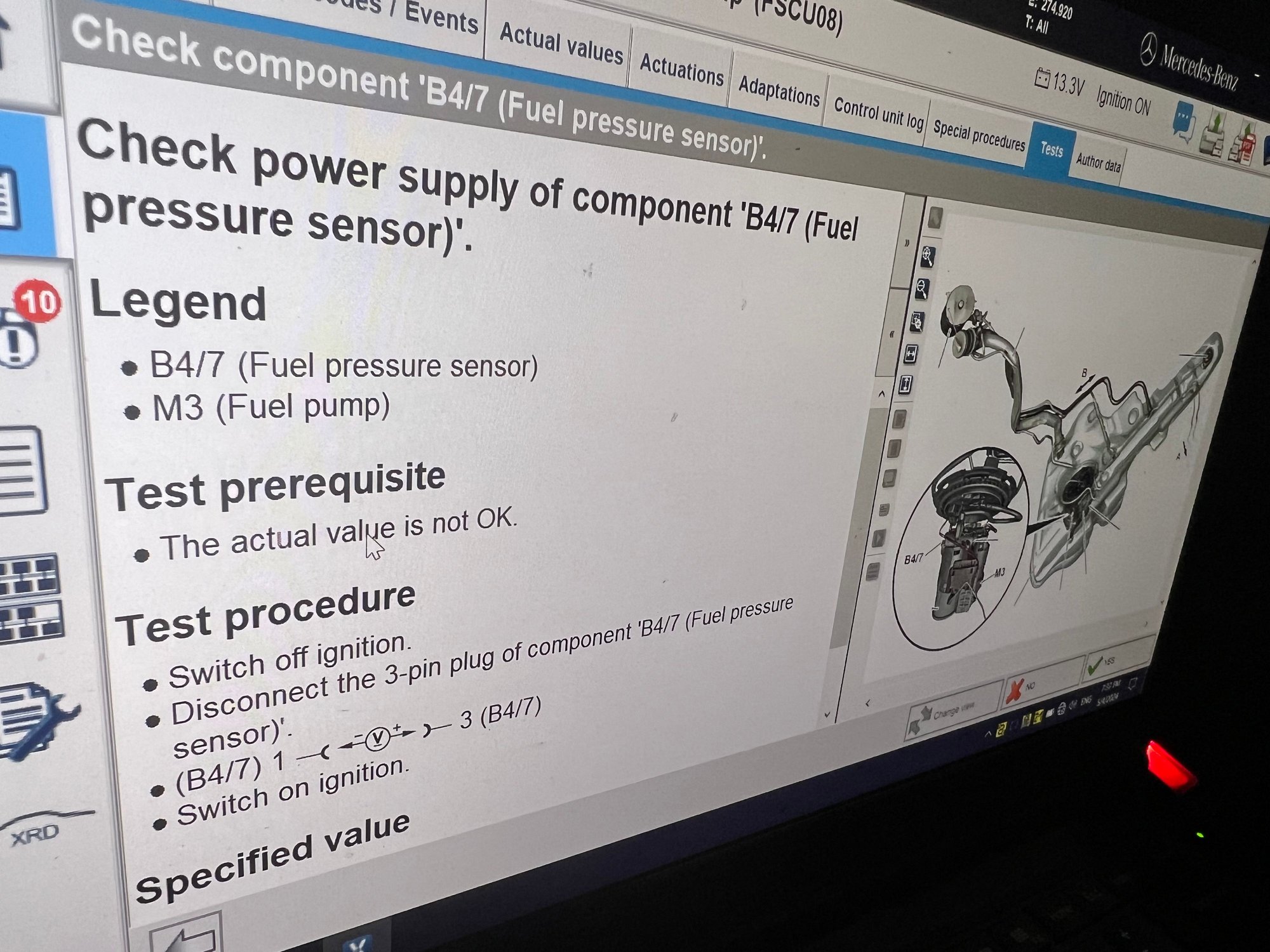

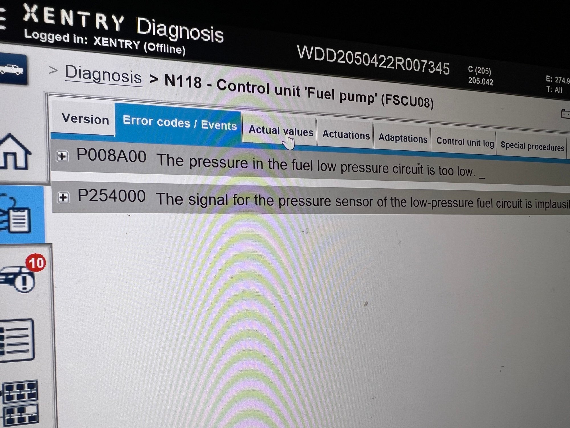

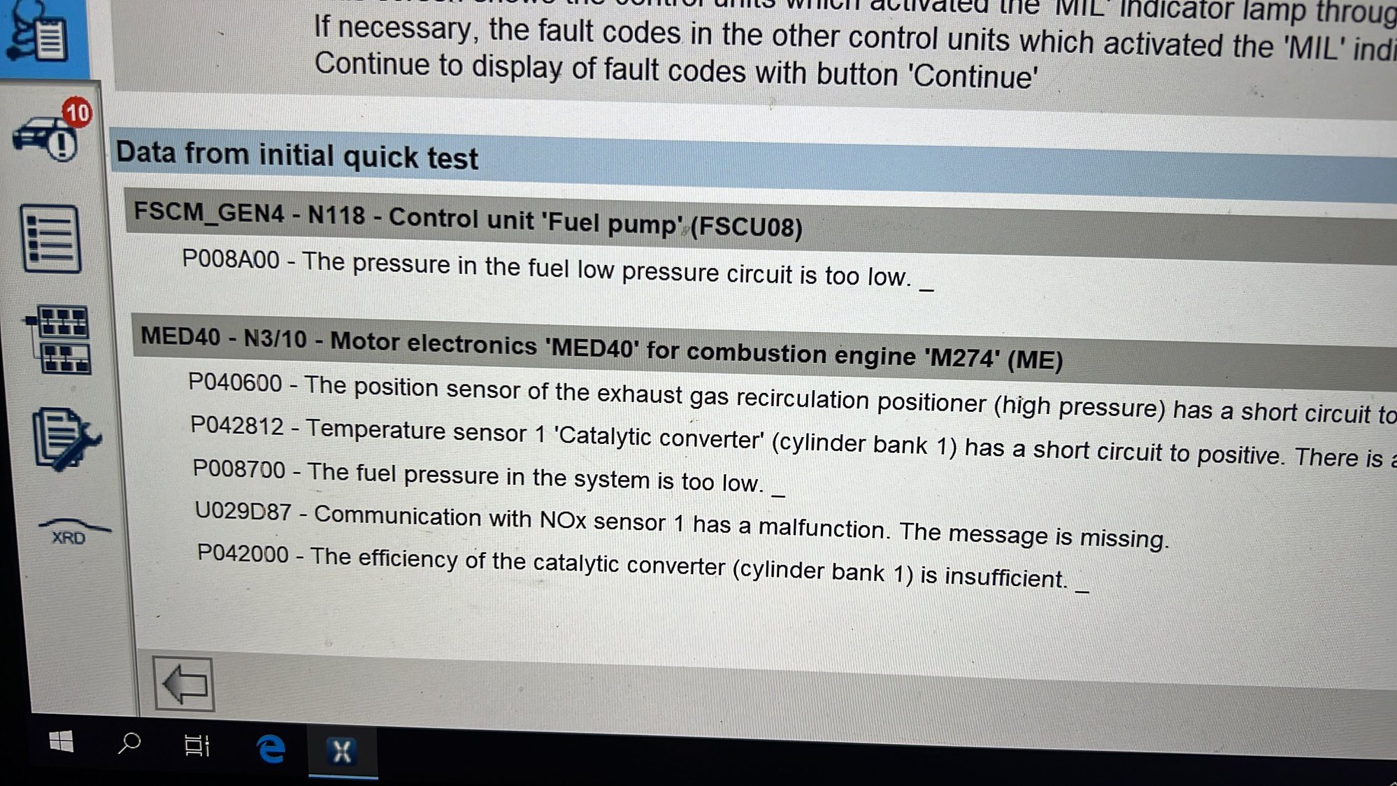

Anyone who has encountered an issue with a W205 M274 continually losing power after some drive. The scans have given me the errors below and i have changed 3 petrol fuel pumps without any luck.

I had to the same codes. Bad petrol ie contaminated damaged the low and high petrol pumps also my fuel tank was so dirty that I had to clean thoroughly as well. In addition I changed the fuel filter I had to clean my injection system. Total cost 780 USD. Local mechanic as the dealer wanted me to buy a new fuel tanks which alone costed 3800 USD.
