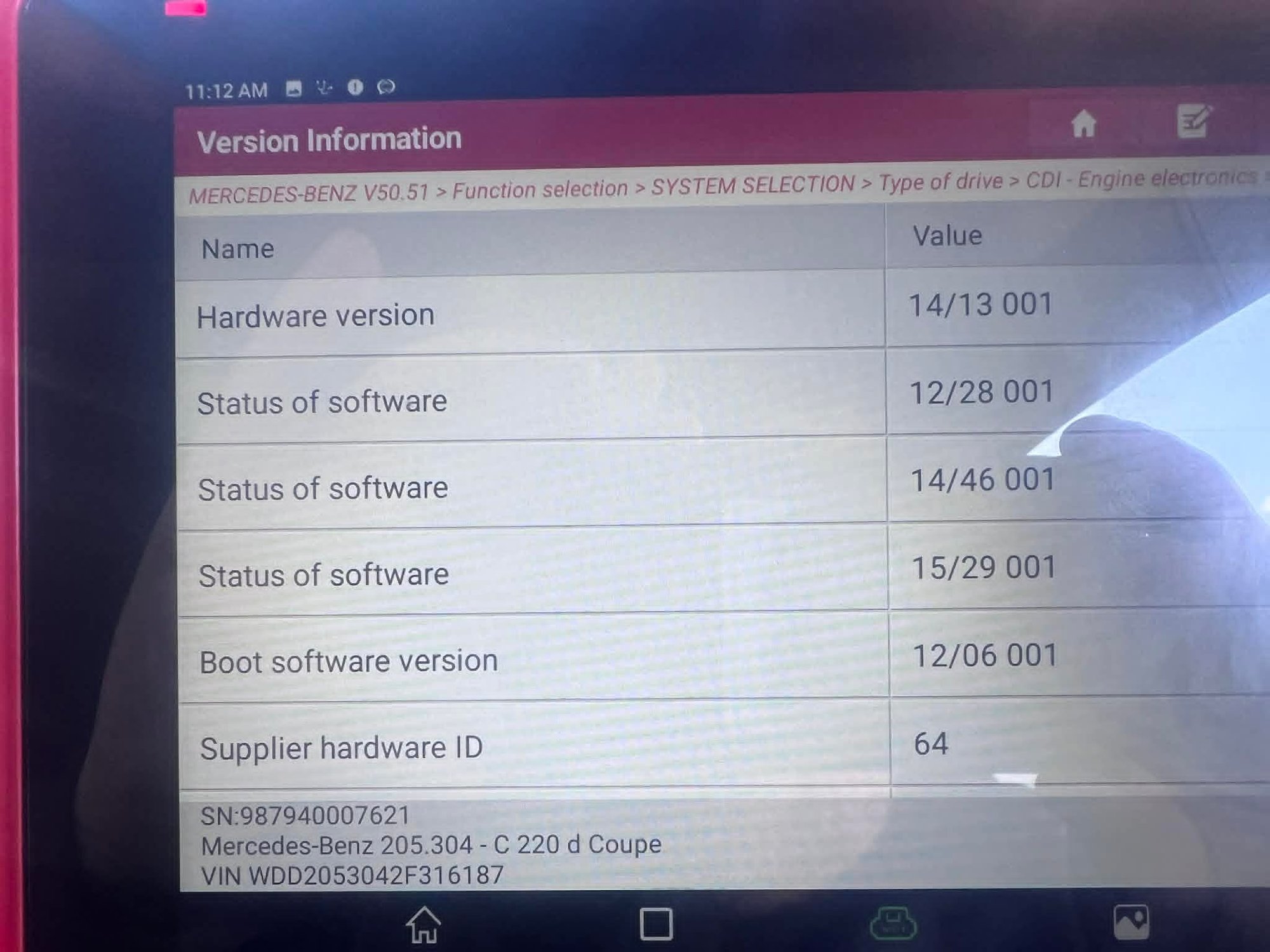

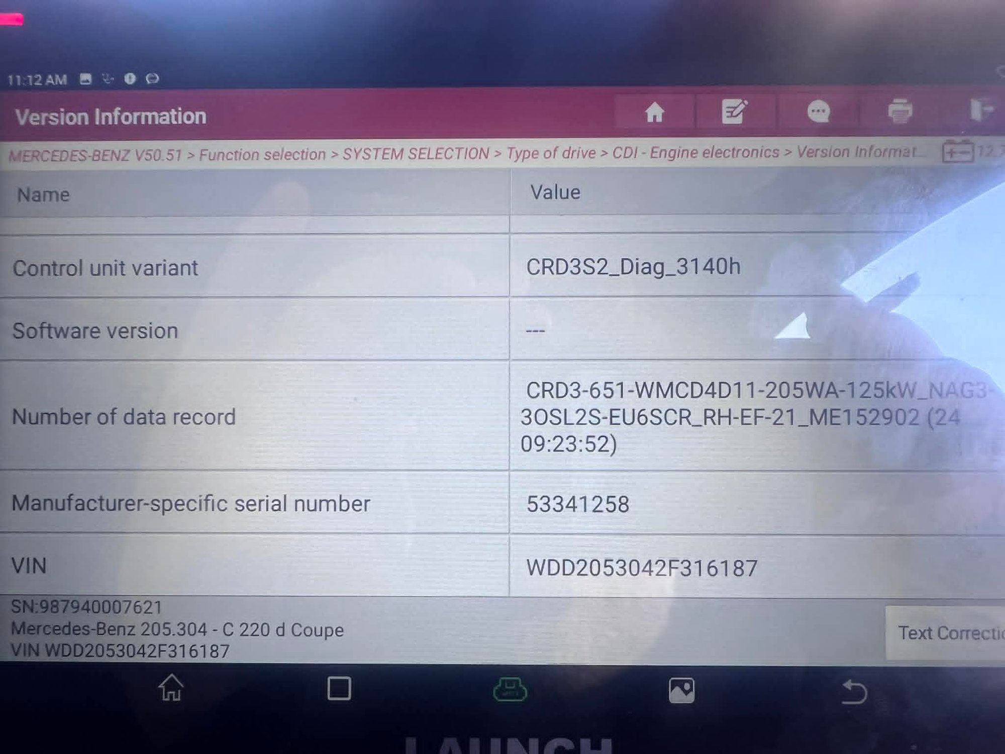

I have a Launch x431 pro and although it wont show any error codes due to the map i can still see the live data values, the kickdown switch physically works and registers on scanner and all other values seem to be in specified range so the only thing i can put it down to is a bad remap, i have taken it to a well regarded mapper (junction 28 remaps) but he refused to look at it because he said some its some one else work and the w205 are difficult cars to begin with, i have also spoken to an intendant Mercedes specialist in the hope he can restore it to stock software but he's refusing to help because the DPF has been gutted and he says once its restored it wont even run.

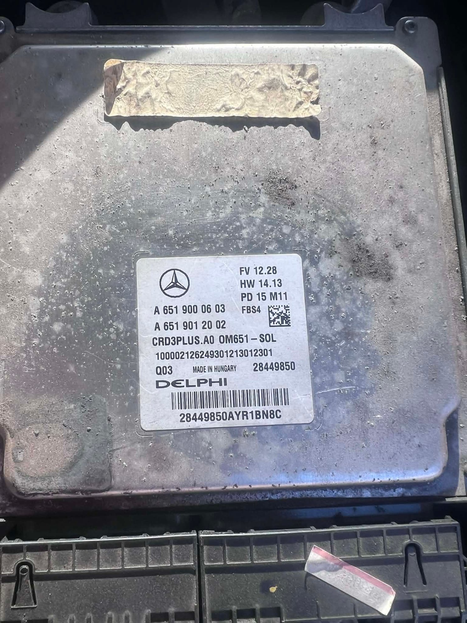

So ive had an idea, i have been looking on ebay and i can replace the whole ecu set for less than £300, i realise ill have to change everything, even the clock cluster but when i was researching the job Gemini is saying although the car will run and drive, the radio, rear parking camera and front radar sensors wont work, does any know if this is true?
Does any one know any one in the mansfield,/Nottinghamshire area that can restore my ecu back to stock?
is the Merc specialist right in what hes saying about retwoing it without replacing DPF will make it not start?
Please guys any other ideas or advise before i go all nuclear and replace the whole ecu modules?
oh one last thing that stood out on my scanner, i saw this in one of the live feeds if it helps anyone "Torque limitation by component or function value normal/mode smoke limit"

Best and cheapest, load the original SW back to the ECU for diagnosis reasons. Of course, car may run even worse with the original SW and without DPF, sensors, etc, but it will start.
You can do that with any Win11 laptop and a 15$ Openport interface.
Car received all that Off's because the previos owner did not find a technician to repair the incipient defective component. They do Off for no reason, as the initial defect remain not repaired.
So, after origianl SW in place, diag the car with any Xentry system if you are ready to understand the difference between reading Fault Codes and doing diag with step by step written in plain english and explained in full repair what you want/can repair, or use a tech that can do that.
For the rest, you can use any tuner to do any nonsense Off based on original file.
