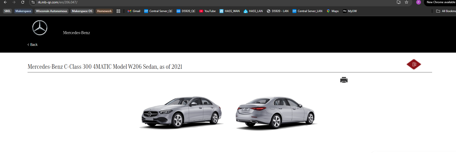

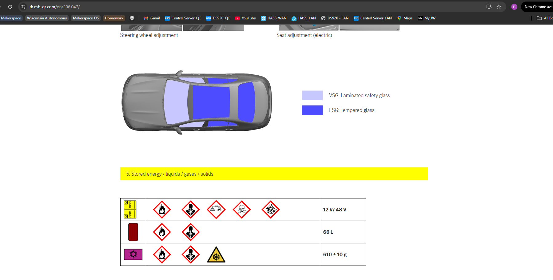

Per MB Official W206 Rescue Sheet they indicate the sunroof is laminated safety glass. I saw the panroof explosions on W205 and double considered ordering it on my 206 until I saw this sheet and though they "fixed"/addressed it by chaging to laminated glass, so I got panroof on mine.
Apparently not, they are also providing incorrect crtical safety information to rescue personel which could seriously mislead rescue process.
What a disappointment, there really needs to be a class action to force them to recall and swap all these roof to laminated glass. Tesla M3 are famous for random roof shatter but at least they are laminated, somehow MB end up being more of a safety hazard than tesla build quality.
I wonder if this picture is different for the acoustic package.
Old Jul 11, 2024 | 11:20 PM
Patrck C's Avatar
Joined: Mar 2023
Posts: 40
2013 C300, 2023 C300
Nope its not, mine is optioned with acoustic, and my side glass are indeed laminated. The Rescue card scanned directly from the QR code on my car is the same as the generic one.
It's difficult to judge whether a sunroof is laminated or not(until it shatteres like many people in this thread), which is why I believe this picture. Pretty sure acoustic package only extend to front side windows and windshield and doesn't change the sunroof, that's what I can confirm in EPC, there is no acoustic option code(851) matrix relevant for sunroof.
Old Jul 11, 2024 | 11:42 PM
wildta's Avatar
Joined: Jan 2023
Posts: 3,135
Likes: 1,205
GLE 580
Thanks for checking. The acoustic package does not include the pano glass but I wonder if the rear glass comes laminated.
Edit : Google says the rear glass is not laminated.
Old Jul 11, 2024 | 11:50 PM
Patrck C's Avatar
Joined: Mar 2023
Posts: 40
Per EPC, acoustic package does not extend to rear window either.
Assuming we still trust the rescue card, it is probably not laminated.

An update, looked at the rescue sheet again today, mercedes quietly and secretly updated the rescue sheet to indicate the sun roof is not laminated. Interestingly they still labeled it as (as of 2021), maybe they are trying to deny the old mis-infomation?
