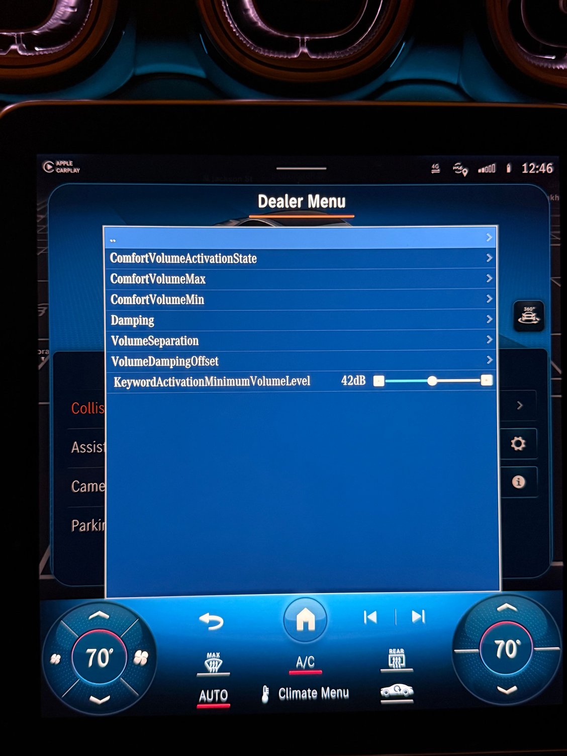

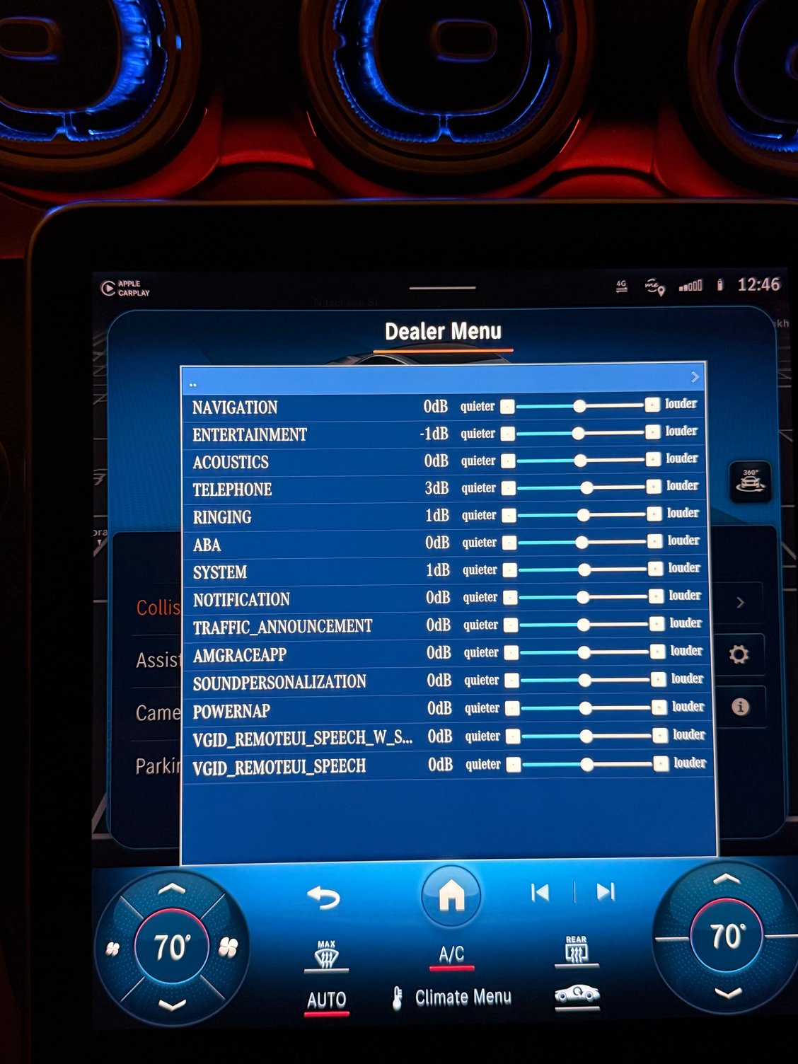

Try the following and let me know if it works:
Open settings, press the "Assistance" heading 8-10 times.
The dealer menu should open:
Press Audio volume > ComfortVolumeMax:
Lower the AMGRACEAPP to your desired level:
That is a lot of options to choose from indeed.
unfortunately it does not have any effect on the Engine sound via speakers. I guess this AMG raceapp is for something else
It's probably for the track/timekeeping app on AMG models then. Sorry I wasn't able to help! As others have said, I hope you find a solution without having to remove the entire system. Maybe a stereo technician specialized with MB in your area can offer guidance.
