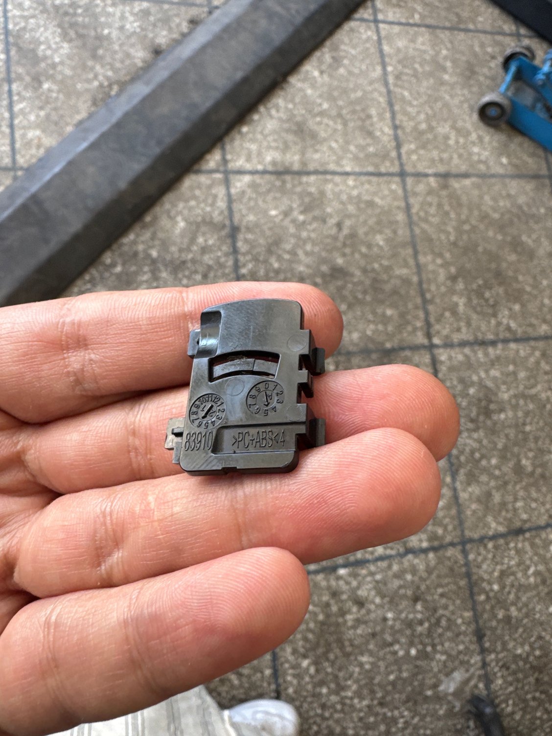

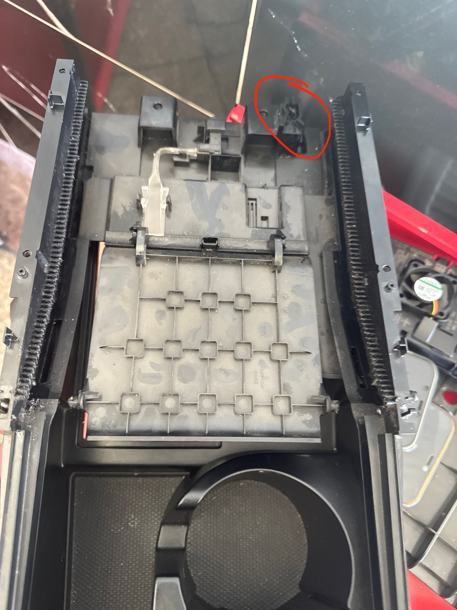

Alrighty, i got it fixed today, not easy, had to open the entire central console to get the entire tray out and disassemble, issue was there is a clip that was holding a pin, somehow came off and the pin itself goes into the part highlighted in red that makes the clic sound when the tray is opened all the way back. Tbh all felt too filmsy of a system you would expect mercedes to have a more robust thing going on
the cover tray
the cover tray
latch holding the pin at the back of the tray cover
Pin goes in and out in this little plastic 'maze'

I did not send it to be fixed to dealer because i know they will ask me to change the entire tray and quote me 500$ if not more for something that is not even broken just needed to put it back into place.
As for your issue of not closing backup is that big spring you see at the end of the latch in the first picture, your issue should be either change that entire spring or if you’re lucky you need to just tighten it up, it does the work of spinning the little plastic wheelies that push it to close back. 100% sure that’s your fix
