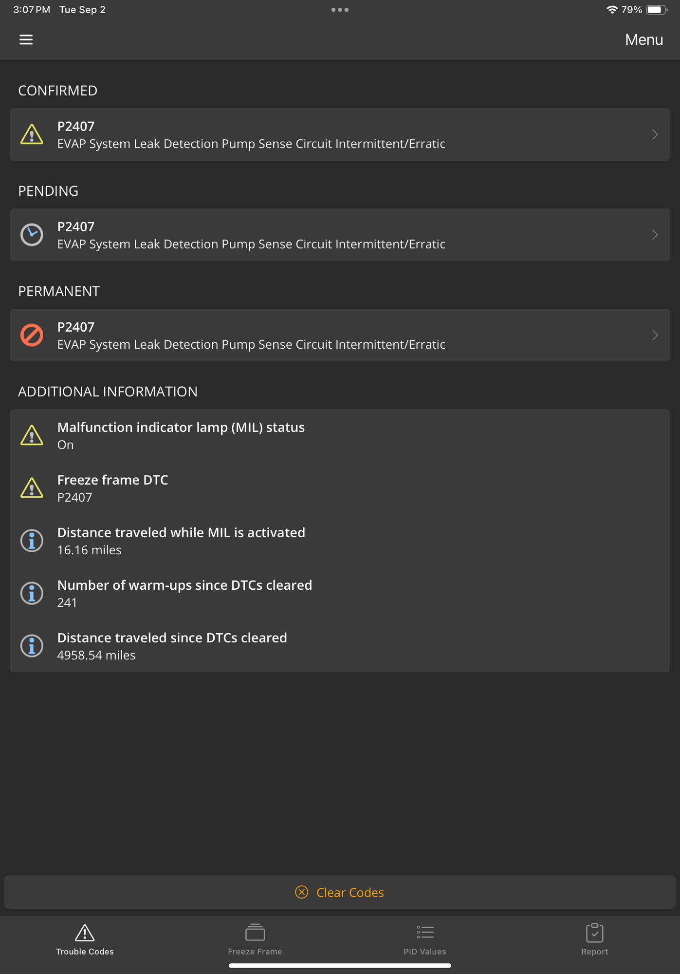

Hi all,
Engine light came on yesterday and this is the code. Could it be the fuel cap?
I can't take the car to the dealership until next week.
