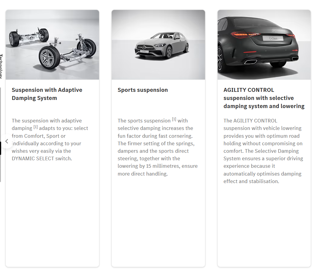

Which suspension do you have? As far as I can see, the C300 is available with different suspensions in your neck of the woods. Two of them are adaptive and can be controlled by selecting the appropriate mode. The sport suspension will be firmer and doesn't have manual control over the mode. The selective damping system in the sport suspension has two damper settings, but it selects them automatically based on the amount of movement it detects in the body, so for normal straight line driving the dampers go into the comfort setting and when you start cornering somewhat spirited, they switch to the firmer sporty setting, but as a driver other than with your driving style, you don't have any control over it. The sport suspension is inherently firmer as it prioritizes handling over comfort. That's also reflected by sitting 15 millimeters lower.
So, I guess the most obvious response would be to option the correct suspension for your style of driving, but now that you have the car already, that's no longer an option. The most impactful change you can make to the ride is using the correct tire pressure. There are several tire pressures for different load, tire and speed situations. Usually listed on a sticker inside of the fuel door. So for normal driving mostly by yourself, you wanna use what's referred to as the normal load tire pressure. It's the lowest tire pressure for normal driving with 1-2 occupants and mostly empty trunk. If you use the highest tire pressure known as the max load pressure and you don't load the car up with passengers and cargo, you will have a harsh ride.
Having said all that, it occasionally happens that dealerships forget to remove the shipping blocks during PDI. The shipping blocks are used during transportation to avoid the car from swaying around. They prevent the springs from compressing. So, if they are still in, you'll have a horrible ride as a result. They are usually brightly colored plastic pieces in the springs that you can spot by looking at the suspension.
I've got the amg sport suspension without the adaptive dampers on goodyear eagle f1s and i've got the tyres pumped up as low as they can without turning the tyre pressure light which is 245KPA but im still finding it stiff especially on uneven roads the car rocks so firm left and right
That's your problem right there. The sport suspension is about handling and fun cornering, not comfort. I don't know what the tire pressure is supposed to be on this car. Can you post a picture of the sticker inside of the fuel door? Once you lowered it to the desired pressures, you just need to reset TPMS, so the tire pressure warning doesn't come on. There's no predefined tire pressure in TPMS. You have to store the reference values yourself after setting the pressure to what you want them to be.
What's making me mad is that my dealer never mentioned any type of different suspensions when I was ordering mine, also I'm afraid of lowering the tire pressure because that will put my rims in high risk
