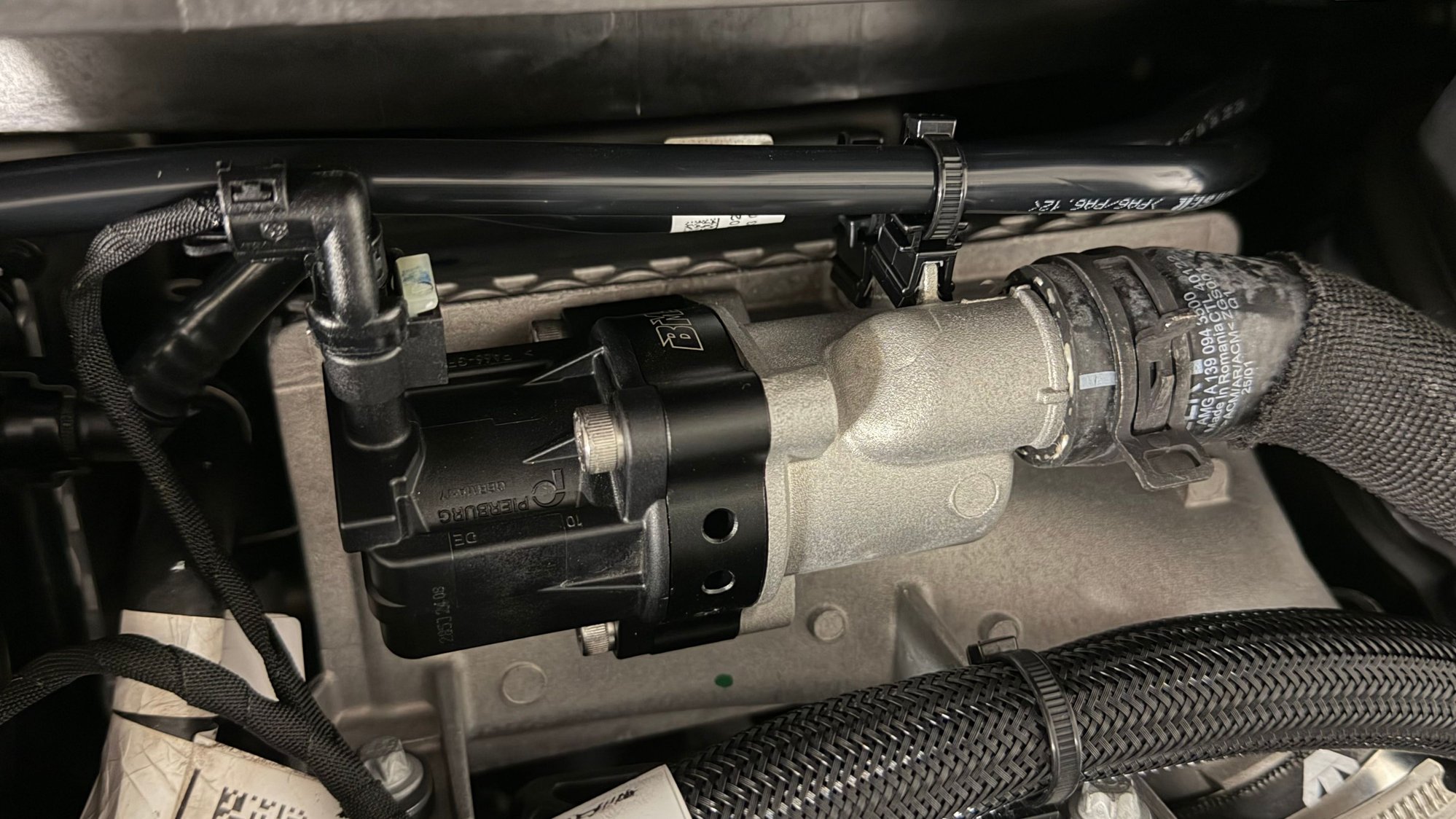

oh nice. mine is a C180 W206, i cant figure out where is the valve. do you mind sharing a photo of yours? would it trigger any CEL?

[img alt="This is where I’ve installed the adapter
It’s the solenoid off the intercooler with pipe going to top of the air box so I’m assuming it’s sending any excess air back into the top of the filter box
The boys at Burger Motorsport told me this is correct but I believed there’s supposed to be another similar valve on or near the turbo so was unsure which is the correct one that is if there is indeed another
This one seems correct
Appreciate your thoughts "]https://cimg7.ibsrv.net/gimg/www.mbworld.org-vbulletin/2000x1124/img_1942_1d622e9f32a3bd9072d61ea9fe9d2b7bcf562292. jpeg[/img]
This is where I’ve installed the adapter It’s the solenoid off the intercooler with pipe going to top of the air box so I’m assuming it’s sending any excess air back into the top of the filter box The boys at Burger Motorsport told me this is correct but I believed there’s supposed to be another similar valve on or near the turbo so was unsure which is the correct one that is if there is indeed another This one seems correct Appreciate your thoughts
I have a C43 but still I would think it would link the same around the inter cooler area

wow thanks for this! i'm going to let my workshop find where the valve is. then i'll show mine and what valves can be installed.
