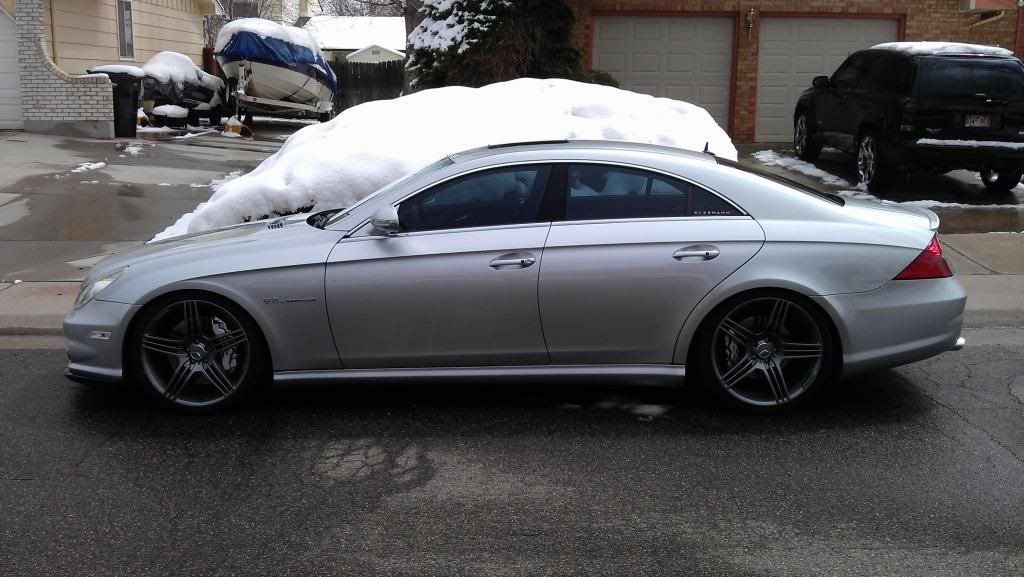

I just did a staggered 20" setup for winter.
255/285 Pirelli Sottozero 240

Wow, the 20s look great. I didn't know 19s were the only recommended for the AMG model. I've always been told to drop down a size for winter (did that for my M5 as well) but will have to reconsider that now for the AMG
Are those center caps the OE ones in Himalaya Gray?
I just P-coated my winter wheels in a somewhat-similar color, and I'm looking for center caps.
They are. Came with the wheels!
