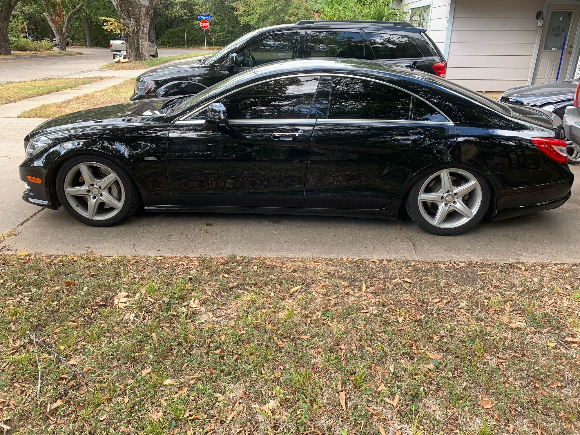

2013 cls550 4matic. No warning lights on dash or to visit workshop or airmatic too low . No illumination on the ride height button on center console . the rear end just dropped all of the sudden started mainly right side rear end, then total rear end, front was fine but now lowered as well I still have the 2 finger test in front but no at all in rear. please assist

Been to shop now 3x and they replaced bag on right side and rear right leveler so they say...they now replaced leveler with OEM part ...wondering if leaking strut but hopefully they tested for that dont know???
my lowering button t doesnt a thing and not illuminated either ..wondering if its some type of relay ...when hooked up to machine it gives one fault but haven't seen the exact code #. last tow to shop when they went to look at it they said the car was leveled. however i stated the rear still looked to lower ...now going on week 3
