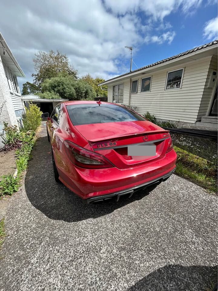

I'm looking to buy a red 2013 CLS63 AMG. There's one listed in my country for 23k USD (car prices are quite low in my country) with 30447 Miles, 3 Owners. The car is already tuned Stage 2 (conservative tune around a claimed 600hp correct me if I'm wrong in saying it's convservative) with a catless downpipe and has frequent maintenance at a high performance shop that I know of and rep.
