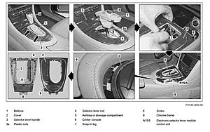

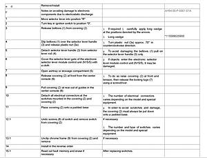

Anyone know how to remove shift knob?
Just bought a new wood shift knob so I'm looking for detailed instructions on how to install it.

Refer to the attachments.
Good Luck.
Attached Thumbnails Anyone know how to remove shift knob?-shift-lever.jpg   Anyone know how to remove shift knob?-shift-lever1.jpg

Exactly what I needed. Thanks!
