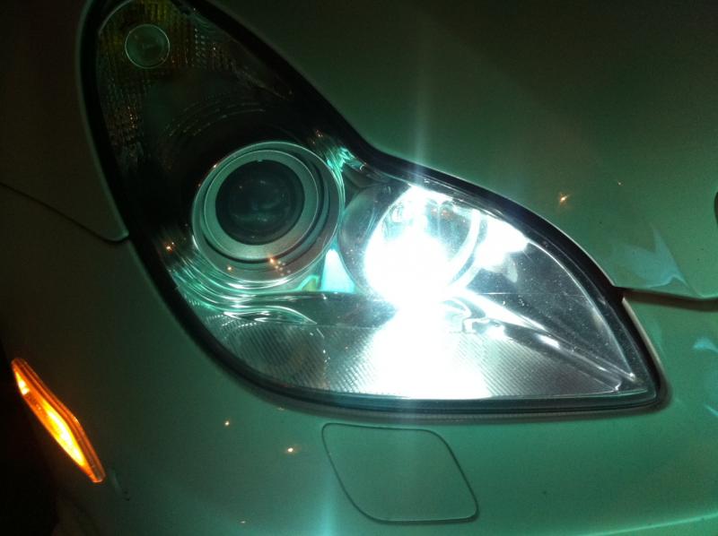

That's exactly what they are... They're readily available through most all tuner or automotive specialty type stores. You can also find them in abundance on eBay, but just be sure to order the "resistored" version or the ones that are advertised as "error free" units, as just the basic or regular LED version will cause you to get a bulb out error message...
I picked mine up from a local shop for $20 (pair). They shine a very bright and clean white. A huge improvement (esthetically) over the OEM yellowish halogen versions. Install took not even 10 minutes.
Here's a shot if mine...
