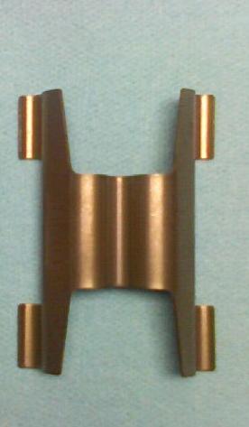

If anyone has the part numbers for the front and rear caliper springs for
a 2006 CLS55, please let me know, as i have some horrible break squealing
and would like to try this to stop it
I hate my dealer's guts so i hope i wont have to go to them
Any help is much appreciated

brake squealing are common in the amg rotors cuz the holes get clogged up with brake dust

brand new rotors installed yesterday (original mb) with textar pads... Old rotors were completely f*cked with olddd ate pads, and did not squeal.. New ones squeal like a

Did you try anti-squeal paste on the back of the pads? Made a huge difference on my M3 when I installed Brembo BBK a few months back.

i think soo.. i ordered 3 saches 2.5g of MB original brake pad paste...
Is there another one?
I swear im gonna throw those pads away and get akebono

If you replaced the original pads with the same pads, expect the squeal to return. There is no real fix for the squeal using the factory pads and rotors. It is inherent in the metallurgy of both components. I use the brembo rotors but changed the pads to akebono euro pads and no squeal as yet.
A side bonus for using the akebono pads is almost zero brake dust.
