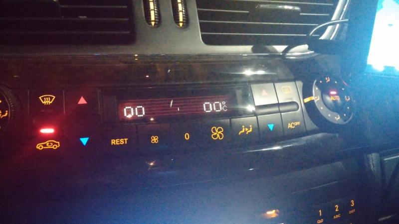

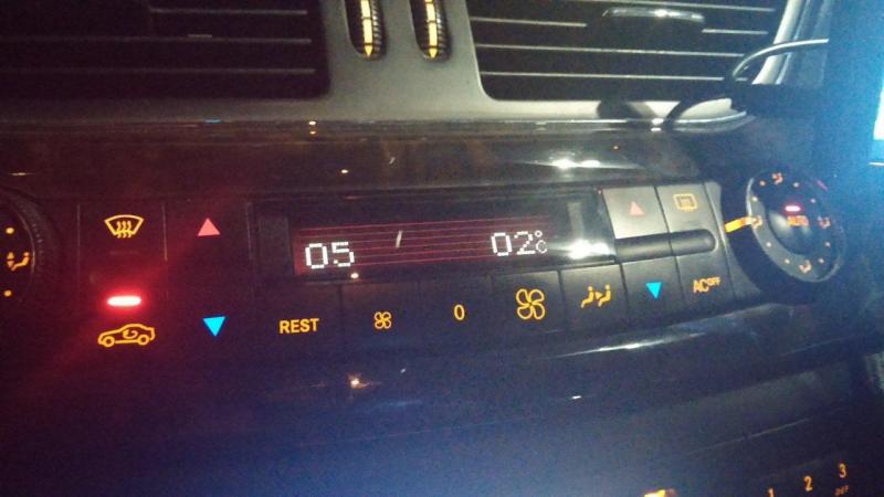

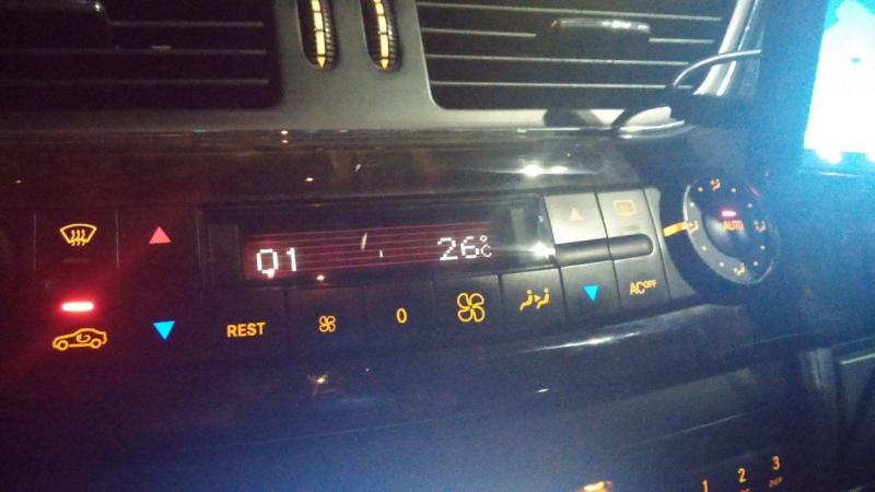

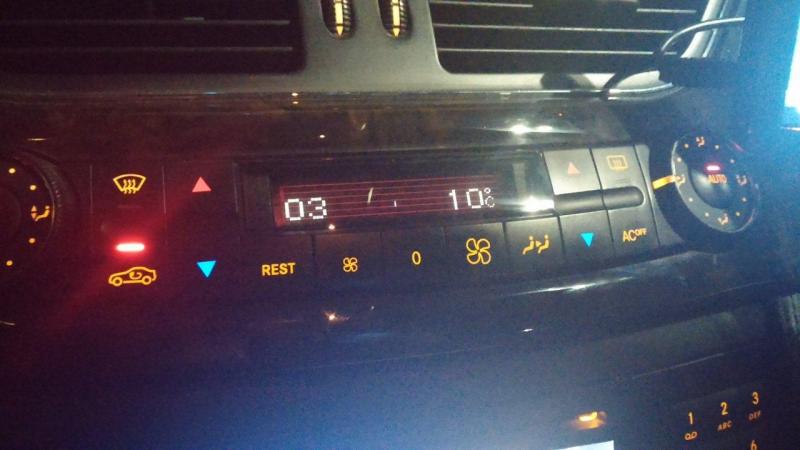

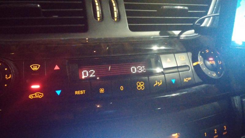

Hi all
i had a problem with my 2005 CLS 500 with the AC , it started to blow hot air from the rear vents every 10 to 15 mins , and to disable that i had to press the defrost and disable it once to come back to cold Air from behind.
front side is working perfectly fine.
any way thanks to this great Forum , i found how to reset the AC and the codes that worked perfectly fine with me are
00-00
01-26
02-03
03-10
04-10
05-02
06-80
so after doing the above config , it doesn't switch to hot air and works perfectly fine but....
every time i restart the car the codes come back to the original value , and i need to reset them again to my config
is there any way i can keep them like i want to ???
please help me , i live in Dubai and it is really really hot in here.
Best Regards
Andria
