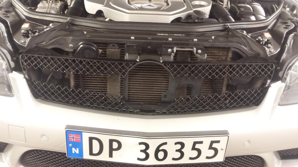

I have for a long time struggled to be satisfied with my front radiator grille on my CLS 55. So after a tryout of 4 different grilles, with more or less satisfaction. I tried the one that doen`t fit preface CLS. The 2009 Facelift grille

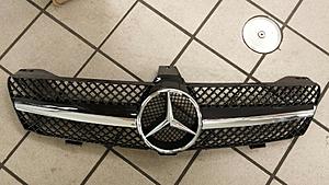

This is how it will look like if you try fitting it directly to a preface CLS
These grilles are in my collection

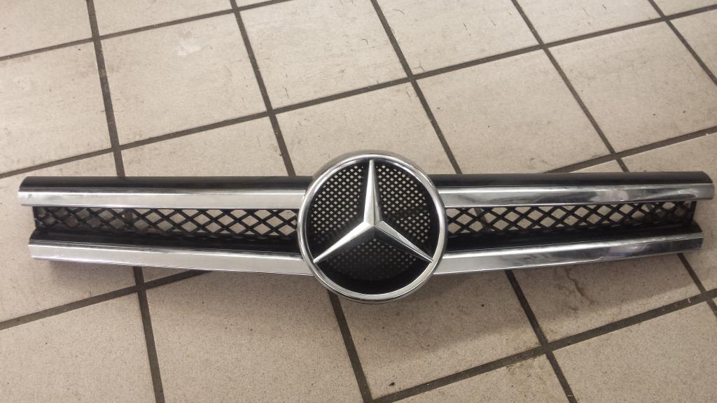

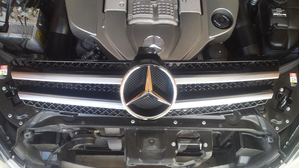

This is the grille I want to use for fitment to the preface
How to make a facelift grille work on a preface CLS:)-2014-08-12-2022.26.37_zpsgv8bdue7.jpg

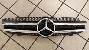

And then we have the facelift AMG grille. I was lucky enough to get a damaged facelift grille for little money You don`t need the mountings or upper and lower mesh grilles to do this mod:
How to make a facelift grille work on a preface CLS:)-20140811_190258_zps8au1lsfd.jpg

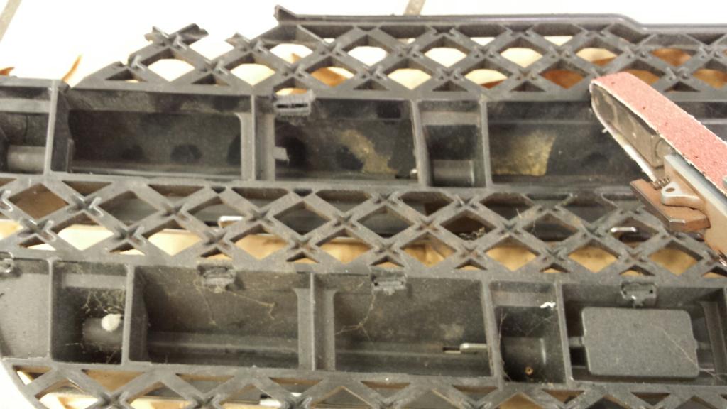

Started with grinding away the mount for the mesh on the facelift grille:
How to make a facelift grille work on a preface CLS:)-2014-08-12-2022.27.49_zpsdbpggpoo.jpg

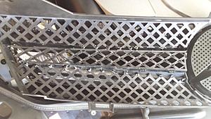

Then when you have test fitted and cutted/grinded enough, you can start gluing the facelift grille inside the single frame grille. But glue it in with the single frame grille attached to the car (for correct fitment):
How to make a facelift grille work on a preface CLS:)-20140815_170252_zps7vwrd2yz.jpg
How to make a facelift grille work on a preface CLS:)-20140815_170257_zpsj063z1vw.jpg

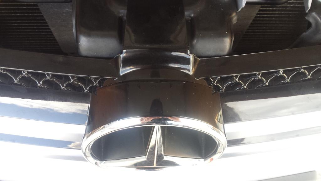

Heres your new facelift grille I got the paintshop to spray a layer of matt clearcoat to the chrome frames before installing it to the car. You get a satin look with this mod.
How to make a facelift grille work on a preface CLS:)-20140815_170615_zpsntuapwpw.jpg
How to make a facelift grille work on a preface CLS:)-20140815_170828_zps1fihgtpo.jpg
How to make a facelift grille work on a preface CLS:)-20140815_170835_zpsu14z6tfz.jpg
