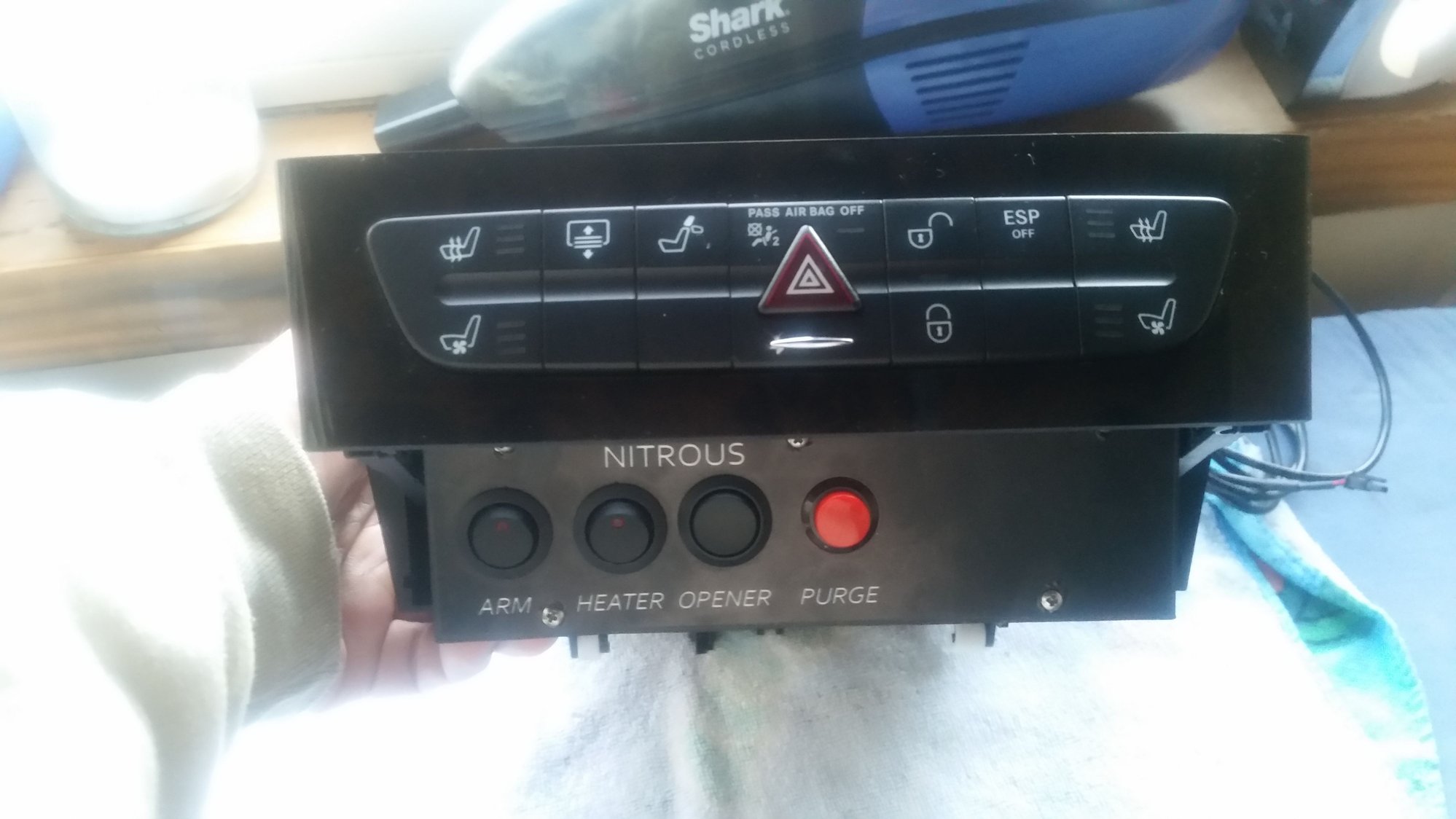

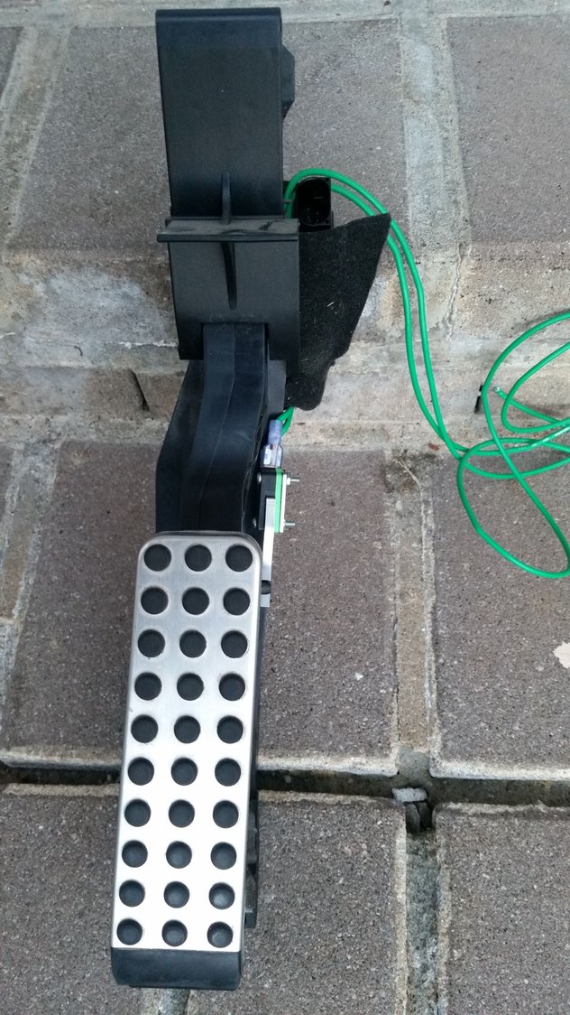

Here's how I did the wide open throttle switch and hidden buttons where the cd changer used to be. Like night rider

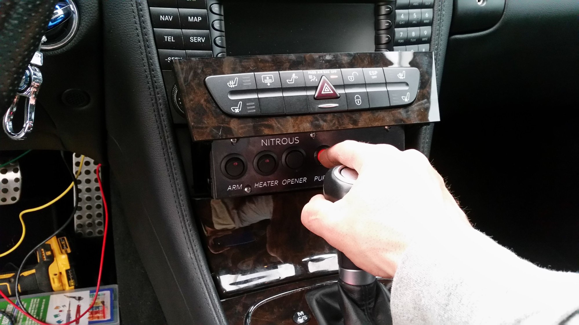

Switches installed.
Originally Posted by Ronnie Benini
Sorry, intake by fabtech. It will be there first for this car
They are perfectly at my fingertips from shifter

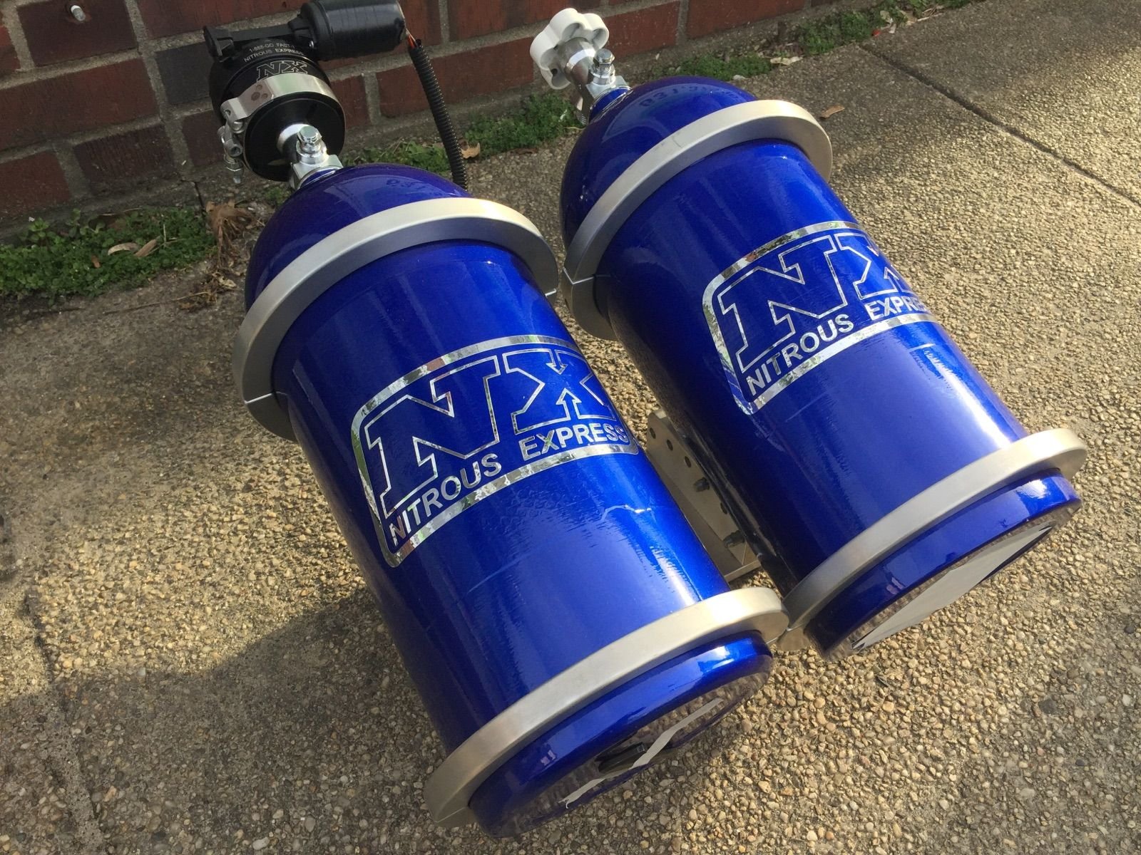

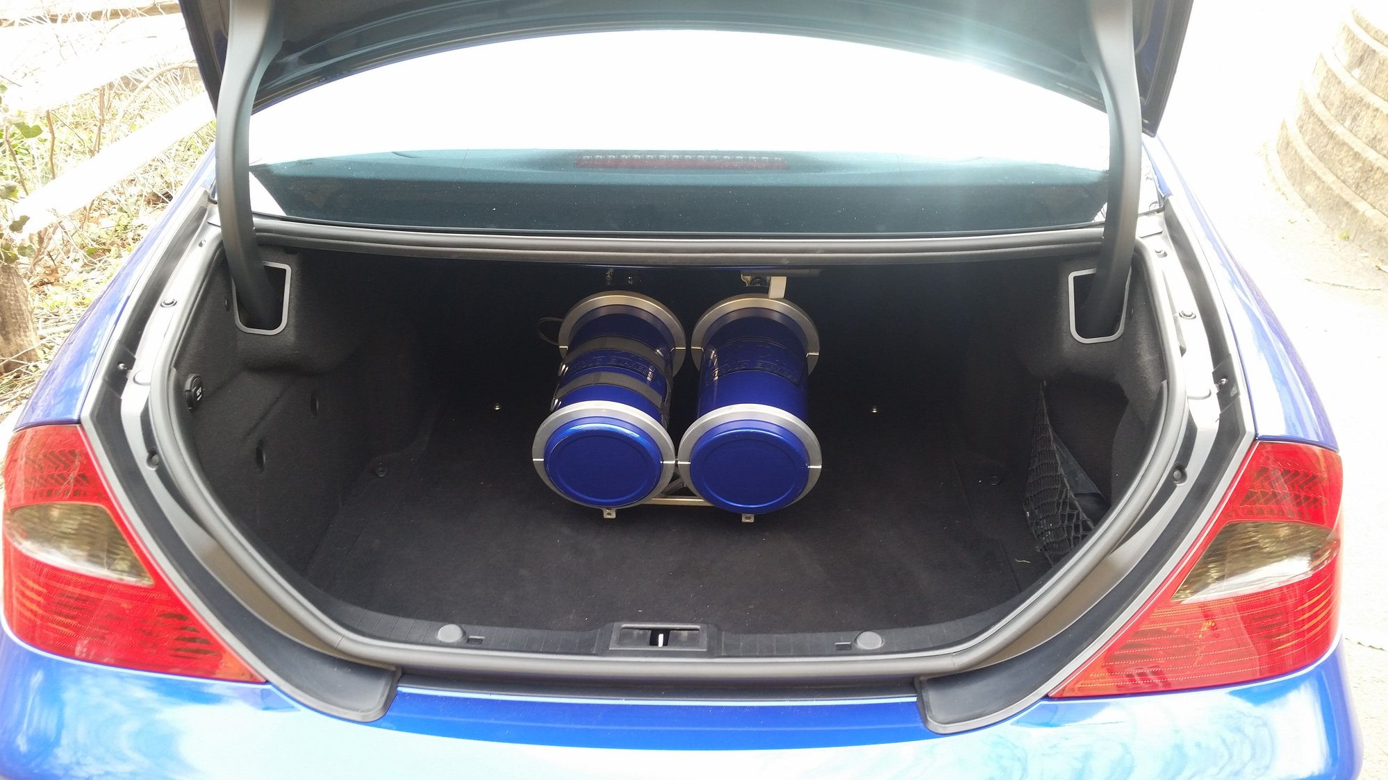

Tanks are in PSN1 gauge is in. Used a torch to mold a universal gauge pod to fit perfect on a pillar. I used the cd changer fuse port for constant power(since I removed the changer anyway) and the cigarette lighter for switched. Ran wires and no2 hose through passenger side firewall. Plenty of room there, unlike the drivers side. Will be installing remote battery terminals on side of trunk so I can access them without lifting the carpet. Carpet will still lift with bottles out though. Put an aluminum plate under the mat instead of drilling through the floor.
Tanks are in. Opener and heater.
Innovate PSN1 gauge. Molded gauge pod in alcantara. Obviously alot brighter then the 2008 alcantara. Have to install headers before I can hook up the Lamba sensor.
Aluminum plate under mat for for nitrous tanks. Makes it possible to still lift mat once bottles ate out. I have quick release brackets.
