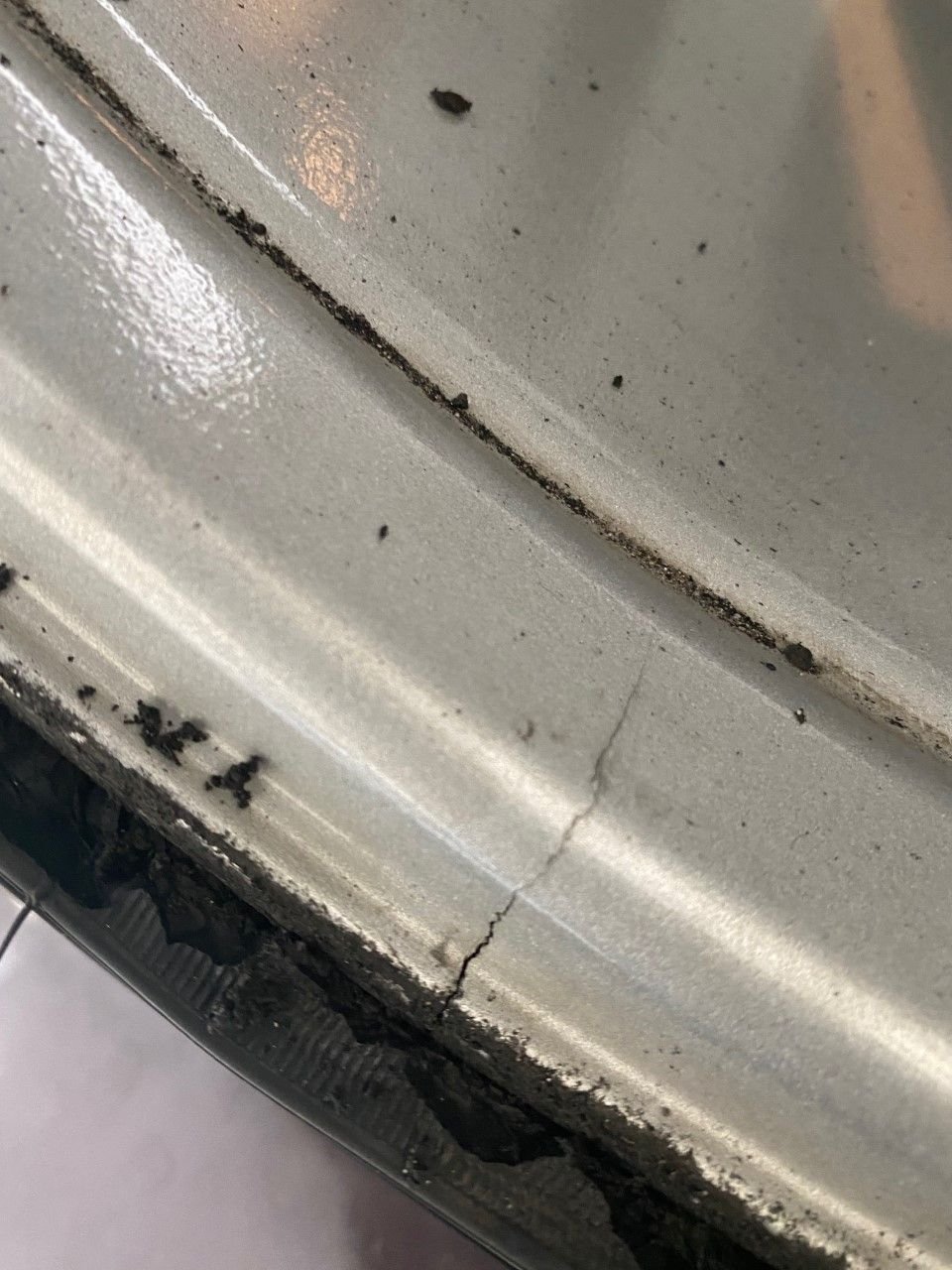

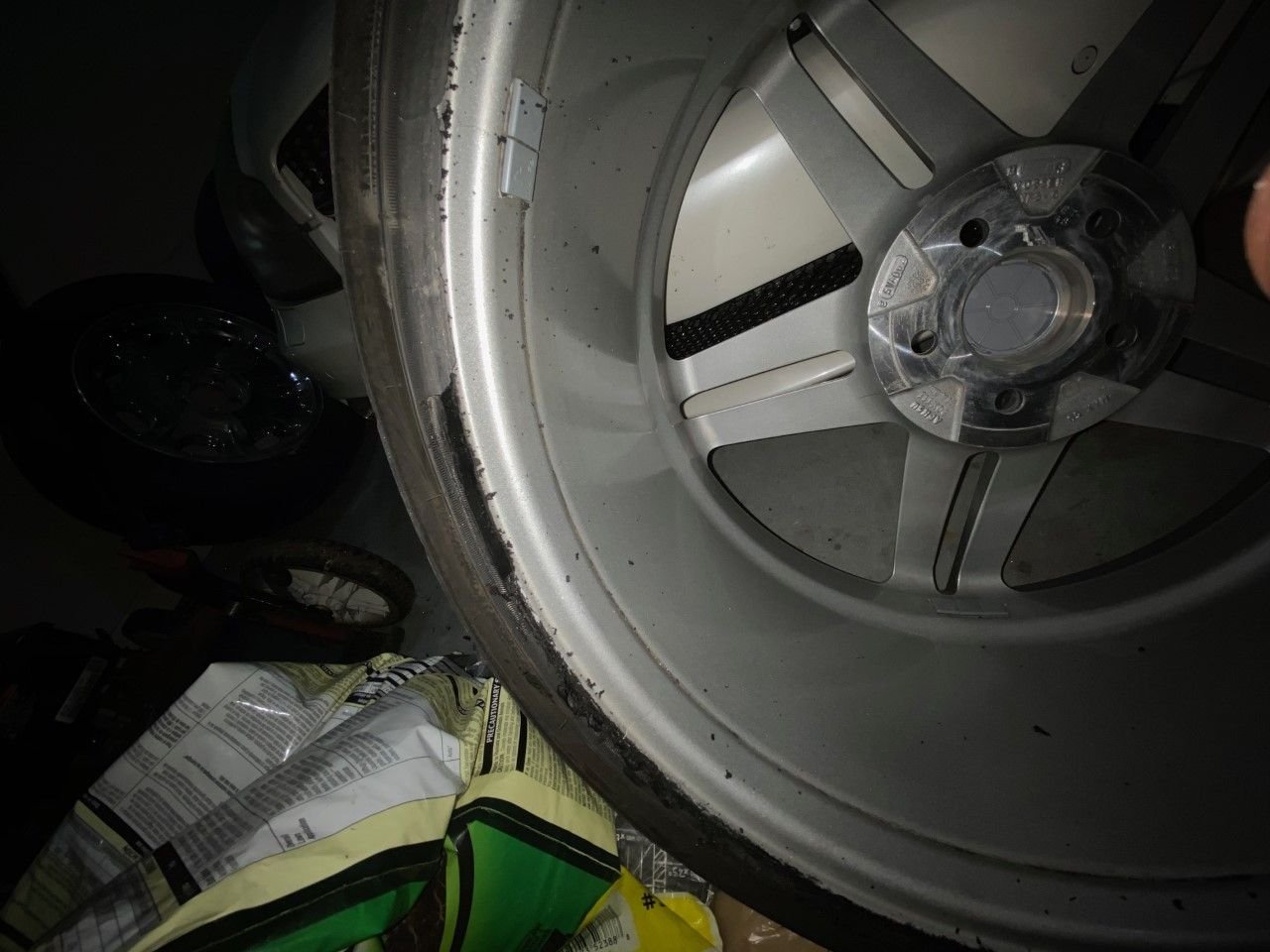

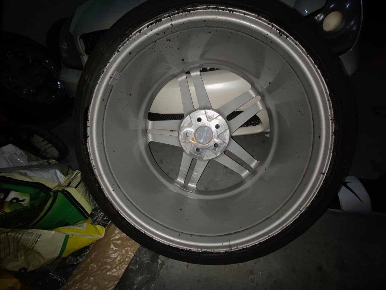

Thanks for the reply, I made the mistake of lowering the car with links and never got the alignment... That was my fault because I know better from past experience. I had a blow out in the rear from a cracked rim, being cracked in 2 places on the inside where the tire wear was. I'm not sure if the camber was involed in the cracking of the rim but I did notice the tire wear once I pulled the wheel off, in the front and rear... The wheel is discontinued so I'm 50/50 on weather I'm gonna get it repaired, or keep my factory wheels on... Do you have a link for the front and back camber kit you speak of? I've seen many different kind on eBay, but I wanted to get the kit that's for CLS's... I made that mistake with the air strut. Now I have to buy it again... I might switch to coil-overs, I'm sick of this...lol
Rode on the bead, didn't know it was flat until I stopped.
rear inside wear
inside wear front
1st crack
2nd crack

yeah,that's shut i think it more likely fault of rim than a couple of degrees of camber. I wouldn't go larger than 19s to maintain some sidewall...cracked rim might be because of the blow out?

Well, the funny thing is the tire never really blew out. I didn't know the tire was flat, and that was amazing because I had to drive 3-4 miles not knowing... I smelled rubber and I thought it was somebody else's car. I stopped to get some gas and I smelled still a little, but got back on the road and still smelled rubber. Once I realized I was on the road by myself, I said "damn, that must be my car" lol.... By then I was pulling into my garage. That's when I noticed the tire flat, but it didn't come off the rim and the out side looked fine, it was the inside that was eaten up by riding on it.... That was crazy, because that 305 was sorta stretched on my 11... Naw I wouldn't switch to 19, I've been riding super low profiles for almost 3 decades...lol My Chrysler 300 profile is even smaller, and I never had any problems. I might have bent a rim or 2 in 25+ years of doing custom wheels but that's never been a problem... My sig below, my 300 has a 275/25/24 on it... Plus living in Atlanta is night and day from when I lived in Detroit with their jacked up streets...lol The weird part is the rim should be destroyed as far as I drove on it, but the front/outside of the wheel looks normal. I think it was a defective rim. Nothing was found in the tire to make it go flat. Those tires were brand new with less then 5K on them. I don't think Vossen will warranty it because the rim is discontinued... I know several high end rim repair shops, one even offers a lifetime warranty on their work. I may try that, because from what I read, it's ok to fix if the cracks are on the inside towards the inside edge, but from the middle to the front would be dangerous fix... So I might try and have them repair it... Check out the inside and outside of this rim...lol The outside is unscaved....lol
