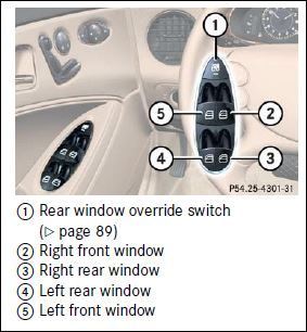

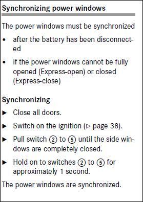

Im guessing you followed this right?

If resynch fails after several attempts, next step pull f33 (30A) @ interior fuse panel for several minutes in an attempt to reset door CU.

I used a different video, but the issue was I didn’t install a panel on the door, once it was I stalled the window normalized.
