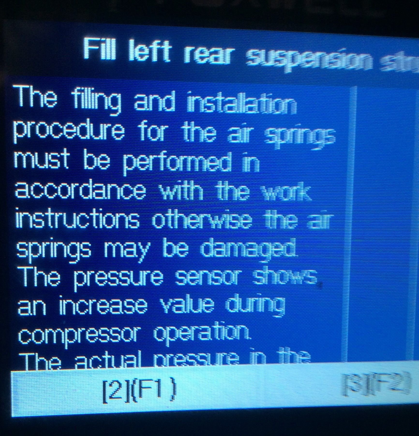

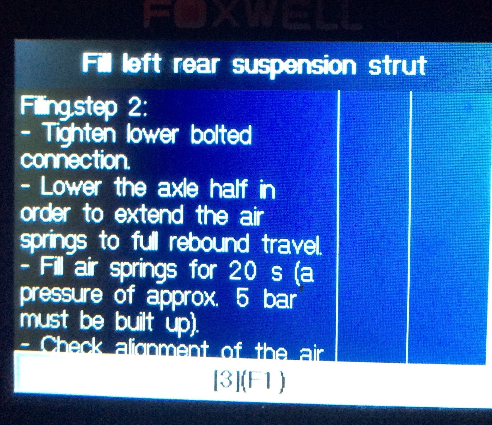

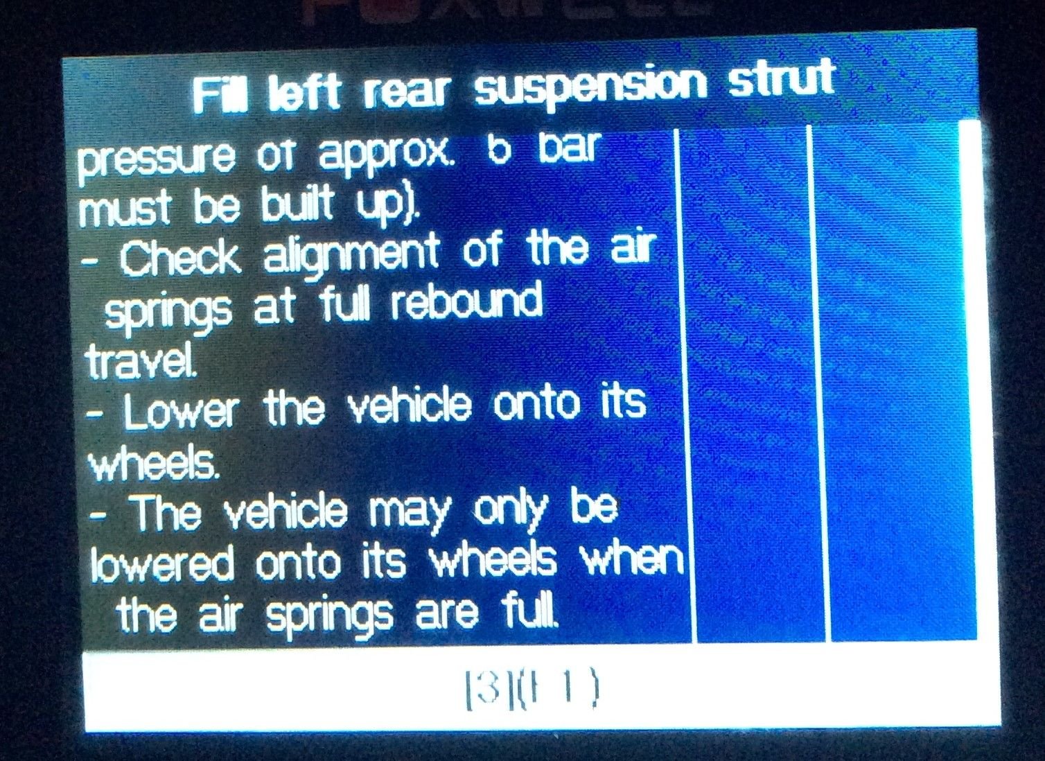

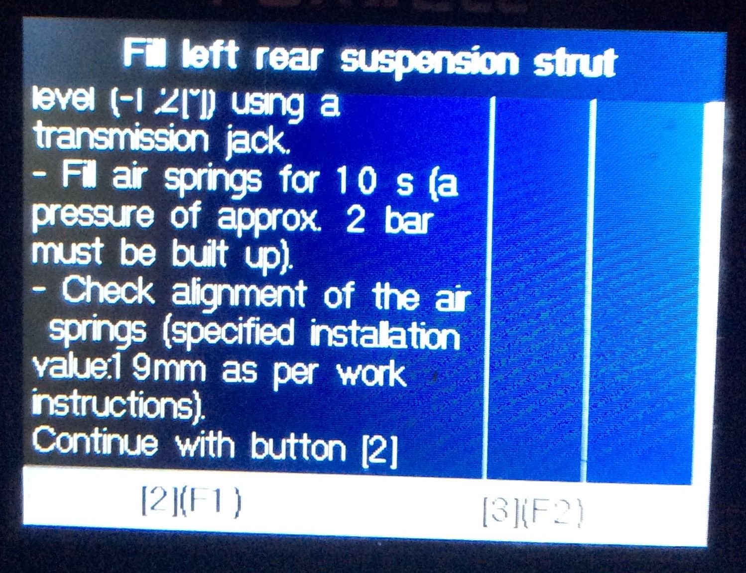

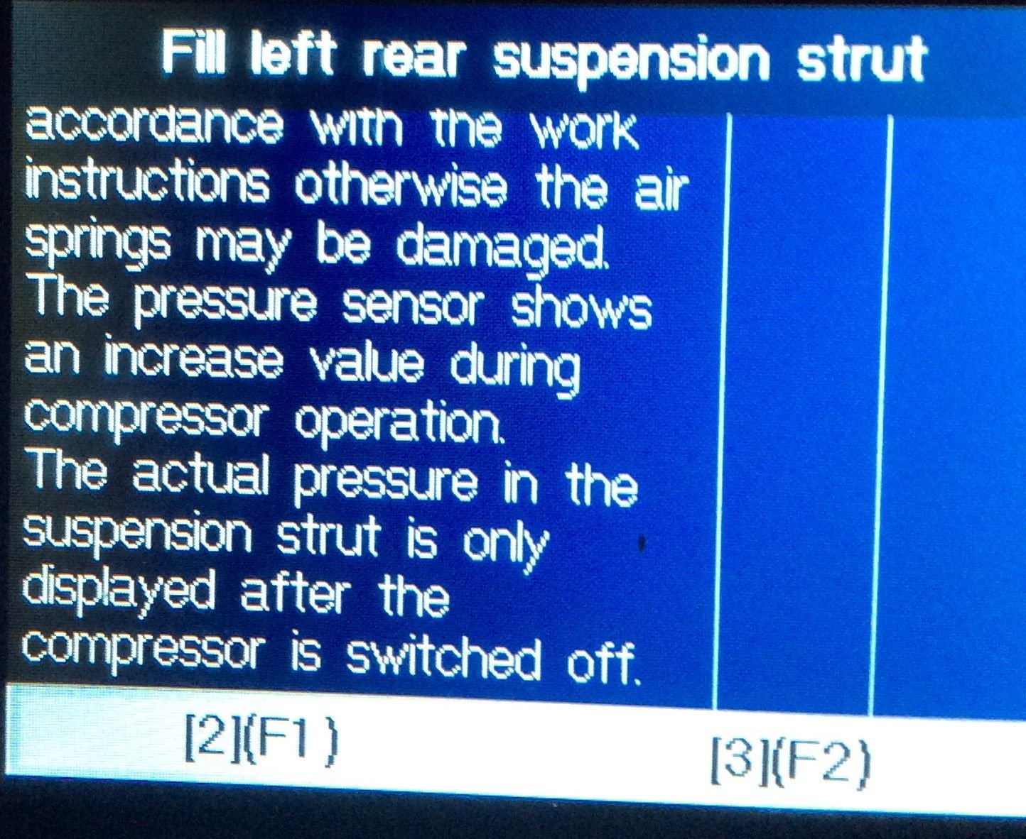

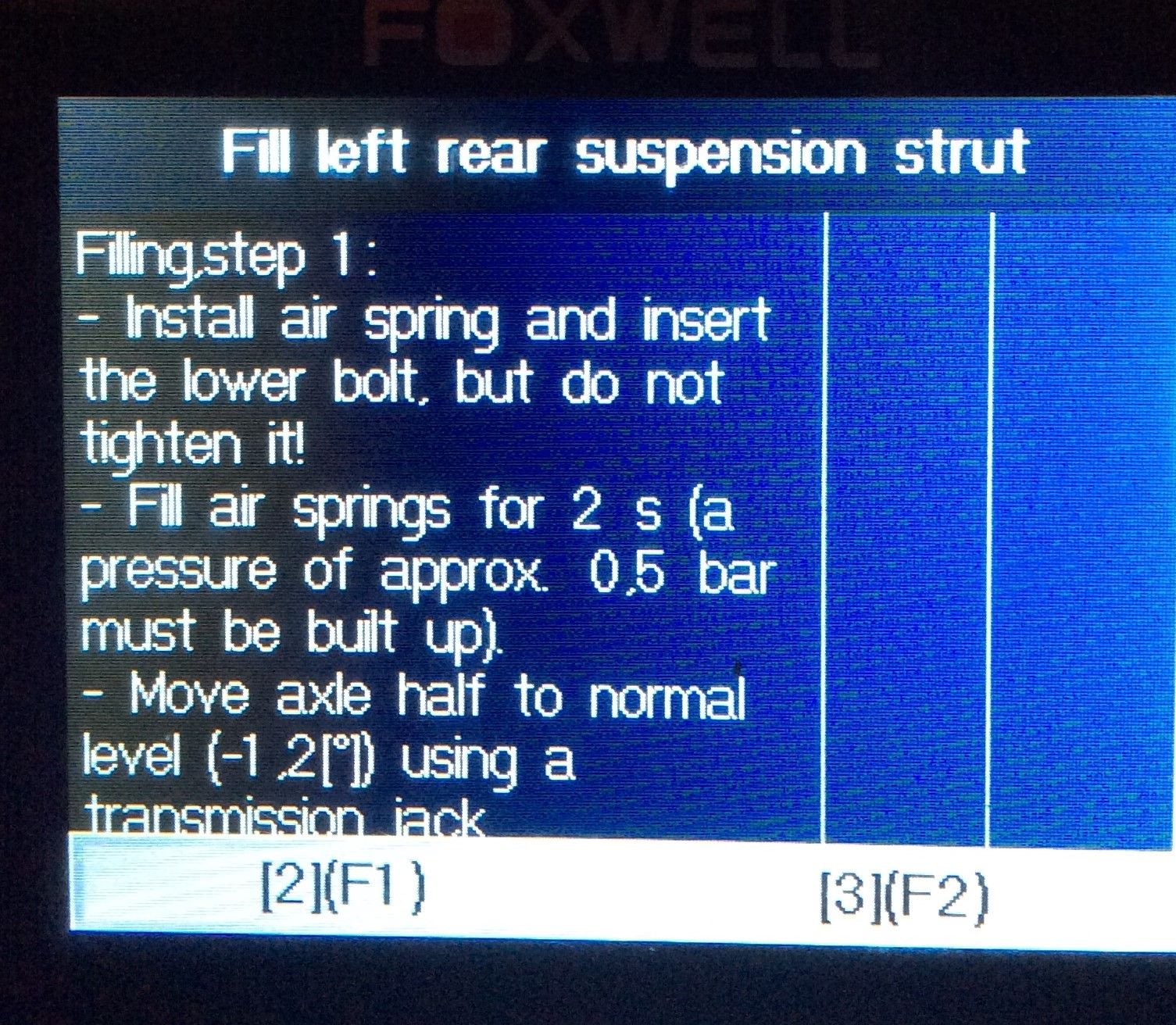

Finally got around to fixing this. The right rear airbag had a leak. I replaced it with OE (rebuilt) air bags from Mercedes that came with the air tanks and hoses, as well. Soon after, the left airbag started to leak and I went back and changed it, as well.
Most shops will say that you have to drop the subframe to change the tank but I was able to do it without dropping the subframe.
Also, I heard stories of new air bags collapsing right being installed. There is a procedure for not blowing out the air bags after changing them at least if you are going with replacement OE bags from Mercedes. The Foxwell diagnosis scanner walks you through the procedure. The key is not allowing any weight pressure on the air bag or torquing it down before allowing it to fill with air in a 3-step process first.
Here is a screenprint of the instructions:
