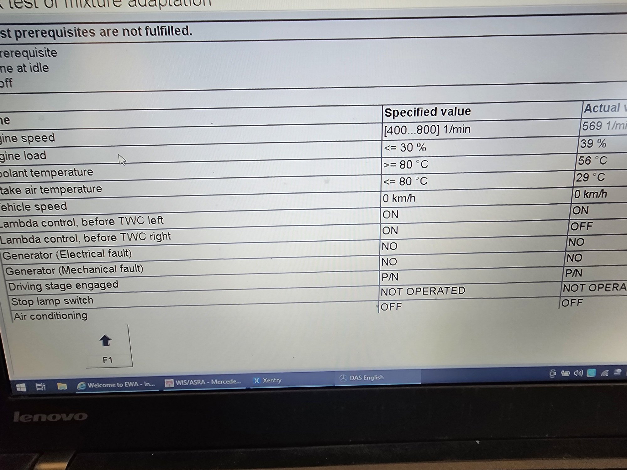

Hi,
I have a 2012 Cl63 Amg 59k miles bought at auction with flood damage title and injectors on passenger side not actuating in Xentry test with a new ECU. New plugs wires and coils and 02 sensor. Still no actuating of those injectors slow acceleration. I cannot locate area of water or flood intrusion. Really at a loss. I'm getting misfire crankshaft errors p something. Any ideas? Someone removed the injector soundproofing or padding insulation and high pressure fuel pump insulation. The Sam's have been checked and replaced the fuel pump relay just in case. Any help would be aporeciated

Two options:
-Failed camshaft position sensors on both Bank 1 (passenger side) and Bank 2 (driver's side).
-Failed mechanical camshaft adjusters. Multiple posts on the early engines suffering from failures as the adjusters' metal "enlarged" or "wallowed out" as the pins and sockets engaged and the tolerances exceeded factory requirements.
I'm not an expert on the M156 engine; just read a lot on this forum.

@bbirdwell Yes, diagnosed at local shop as need to replace camshafts and adjusters as needed (right bank are off) with new chain tensioner. Given informal estimate of 8-10k, An other shop I trust more said that was high and $6k was more reasonable. I think the water damage has no bearing on the problem plus I cannot find it.
