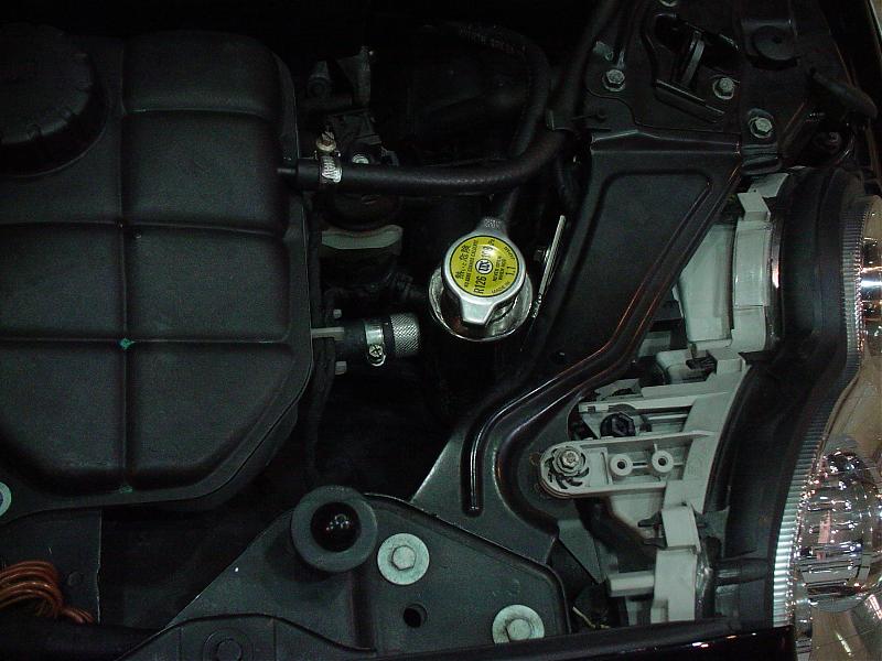

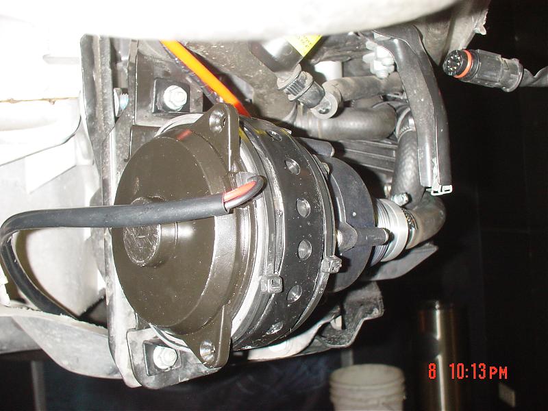

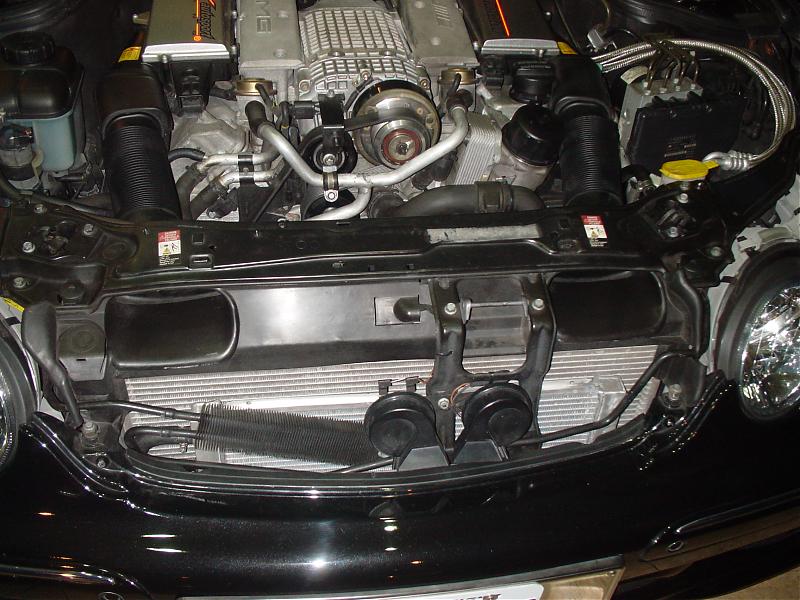

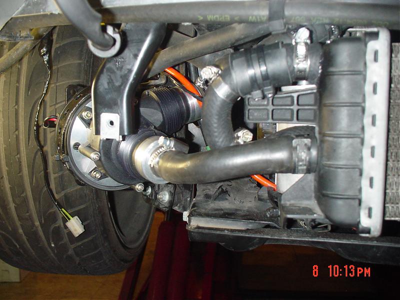

addtional charge air cooller radiator & pumps & indiviual tank
i don't know if u guys got the same problems as we do in our region or not?
summer time it can reach up to 35degrees or so, there for the charge air temp can be getting high all da time!!!thats way we been trying to using all those cooling elements to help it cools,,,
Attached Thumbnails addtional charge air cooller radiator & pumps & indiviual tank-addtional-water-cooller.jpg   addtional charge air cooller radiator & pumps & indiviual tank-addtional-water-pump-1.jpg   addtional charge air cooller radiator & pumps & indiviual tank-addtional-water-pump-2.jpg   addtional charge air cooller radiator & pumps & indiviual tank-indivisual-water-tank-intercooler.jpg

Looks like a new water pump for the intercooler system and another refrigerant tank? Care to elaborate more on this system and how it works (differently than the OEM system).
Old Apr 23, 2008 | 04:18 AM
DANIEL.C's Avatar
Joined: Apr 2008
Posts: 19
From: taiwan
W203 C32AMG T-MODEL&w202 c230kompressor
yaya!!original the intercooler share the engine radiator coolant,so we sperat the engine coolant & intercooler coolant to keep it low in intercooler coolant temp!!! stock got an standart radiator to cools the intercooler we install an addtional radiator & links with waterpump(bi-pump)!!!

We have put a similar trick in a few custom turbo projects...we run a stand alone water cooled radiator for a water charged intercooler, and we have ran some stand a lone cooling systems with the actual turbos as well...a VW water pump makes for a good unit in these systems...but any 12v water pump should move enough water for you...a simple thermostat or even a switch for "when your are on it" works well...
