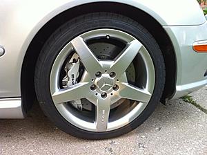

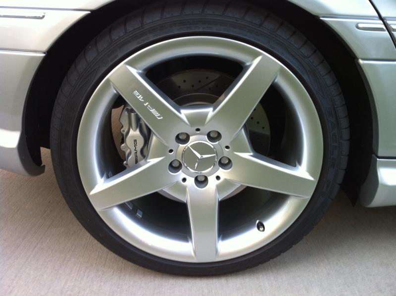

The big brake set-up (ie: from an SLK or C63) on a C55 is an extremely tight fit with the OEM dual spoke factory wheel. 18s are absolutely necessary to clear the setups, the fronts will literally come within 3mm of the inside of the rim. I ended up changing to a different AMG OEM 18" rim to give more clearance.
