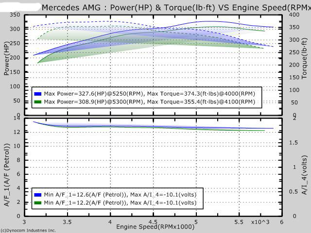

This can be it... Here's mine.

I was asking because I'm about to take my car to the dyno in a few days. I'm interested to know what I should be expecting. The only thing done to my motor is the LET 185mm pulley/LET tune. And the Johnson IC pump (which flows the same as stock?).
What was the difference between run 1 and 2 to account for the difference in numbers? Also, are you using the stock heat exchanger?

Dyno's differ so much it's hard to do a good comparison. The first run was 185MM/Tune, and second run 185MM/Tune with a custom intake I built. Stock heat exchanger. From what I've heard you should expect around 350WHP/WTQ with 185MM/Tune.
