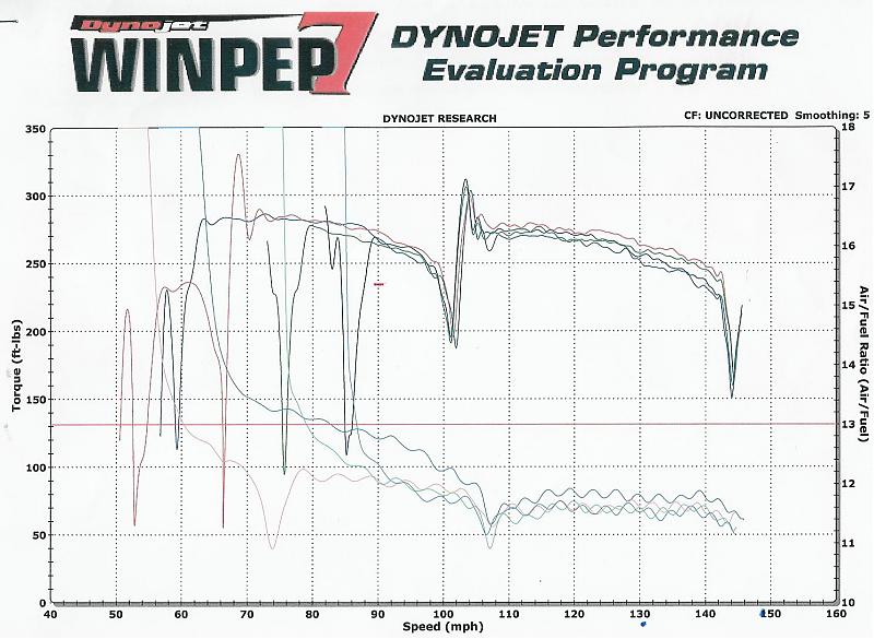

here's the afr with a stock c32 with a stock tune. As you can see at low rpm the afr is 15 and at high rpm and speed it goes down to 11.5-12 afr
https://mbworld.org/forums/c32-amg-c...7-10-07-a.html

What about for the C55 though? Have you seen any dynos on here with the afr?

i dont have any stock dynos of c55, but even cars with tunes are lean at below 3000rpm. My c32 is tuned and it runs 15-14afr below 3000rpm.
I would imagine that c55 fuel curve will look similar, maybe even a little leaner since NA can run leaner then FI cars. Most oems runs lean on the low rpm to maximize there mpg numbers when the EPA tests them.
Newer engines can run leaner then previous ones, especially compared to the old iron block motors. Only car i really seen that runs really rich through out the curve are evo's stock.
Thats why they get like 30whp just from a ecu tune.
