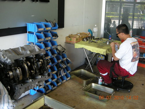

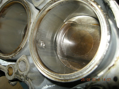

so there i am to share with all amg lovers,,story goes like this..when he bought it,its about 65000km everything seems fine,so we start to make some mod,-- cat off--185mm pully kit---software---bi-water pump,,,,then we push it to the limit & missfiring its occouring very offen,,,,we check the knocking status,,G!! with those number **** gonna happen just metter of time!!! in the other hand we had install the aquamist system & fuel regulator(4.5bar+).....but at the end still happening!!!!!
after rebuild,,we make a final check guess wut,pre-owner had install a stock 320 fuel pump,,that tell why!!!! so i sugg to check the fuel pump if u had a pre-owned C32
