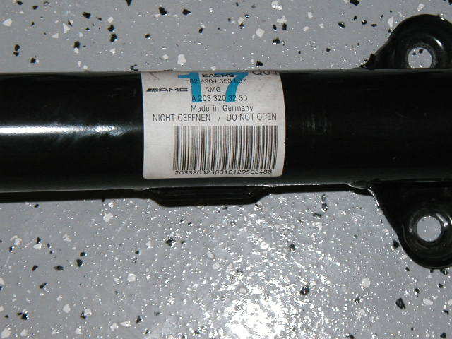

Kwik question
Kwik you may know, since you are a suspension guy with some actual Koni experience:
Do the Koni rears really have to be removed to adjust, or can they be adjusted via removal of the trunk liner? What about the actual front process too?
Can you rate the specific Koni Yellow adjustments from say:
MB-like ride, BMW-like ride, AMG-like ride, M3-like ride, heavy sport ride, track etc (use whatever you think is appropriate)?
What is the relationship between Sachs and Bilstein. Who actually makes the OEM AMG dampers?

Sachs makes our shocks. I'm 100% sure that I had my Konis were on the firmest setting. I work with Motons often, I 've had 2 sets.

Old Jul 10, 2003 | 05:25 PM
rrf's Avatar
rrf
Joined: Mar 2002
Posts: 711
Agree, my AMG shocks clearly say "Sachs" on the side too, but everyone else keeps saying Bilstein so I keep wondering if there is some relabeling going on or whatever.
I am very surprised that you find the Konis to be too wimpy even on the stiffest setting. Maybe because they are C320 based, and you track your car. If they are too wimpy for the average guy on the firmest setting, then there never will be any hope for that solution.

Originally posted by rrf
Agree, my AMG shocks clearly say "Sachs" on the side too, but everyone else keeps saying Bilstein so I keep wondering if there is some relabeling going on or whatever....
Umm....my parts buddy said AMG shocks are made by Bilstein. But choosing between Jon, Rich and my parts buddy to trust, I will believe the first two!!!
Old Jul 10, 2003 | 06:42 PM
rrf's Avatar
rrf
Joined: Mar 2002
Posts: 711
Harris not you too! See everyone is thinking Bilstein....
I know I have a pic, and I have seen Jon's pic too so ....
How about a friendly wager........
Some of the other model Mercedes use Bilsteins, thus more people are used to giving that answer. It is not uncommon for a manufacturer to have multiple part sources.
Old Jul 10, 2003 | 07:00 PM
rrf's Avatar
rrf
Joined: Mar 2002
Posts: 711
OK but we are 2 for 2 on Sachs, anyone actually have Bilstein?

Thanks RRF , I thought that I was going to have to take another photo.
