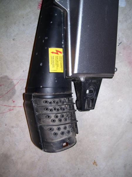

Hello all,
Today i was driving my car a little bit fast on highway. When i came home i opened the hood and saw the right air intake box cover is not at the pace should be. Some how it went another way and it was broken now the plastic cover.
So now it is without cover like in this pix.
Where i can get that cover plastic shield. And is it a problem drive car without cover?
Thanks.

It will not hurt anything to drive the car with the black plastic piece broken off. The filter is in the silver piece so the air is still being filtered. The air might be slightly hotter due to engine heat but not by much.

Zeppelin is right, as long as its before the airfilter it is fine. The air is still filtered so the reason why it is there is still in use.

Thanks. Also how can i get that piece? Where i can buy it?

Unfortunately; this piece not comes separately, it comes with an air box assembly....

ok. thank u all guys. i think i will go to plastic creators and tell them to do a plastic cover like oem maybe it will be good
