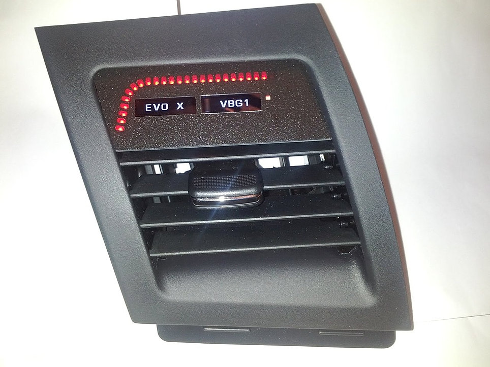

Hey guys, I have a Kleemann Stage II C32 AMG and I'm struggling to come up with a good solution for a digital boost gauge. My requirements are: no round gauges or gauge pods/pillers, digital display color must match the amber color of the other interior lights, it must look like a factor option.
I have a contact at Kleemann and he mentioned that there is a back door into the speedo display that reads out certain OBDII/K data, does anyone know how to do this?
"There are several "back door menus" to access via the speedo head. I'm not entirely sure boost is a data stream into any of those screens, and they aren't designed for permanent use. Absolute manifold pressure in mbar is a OBDII/K data stream, so I'm sure any of the "portable device" products that plug into the OBDII port and display to your phone will work."
I've been in touch with Andy at Gaugetek to see if we can do a custom application, but I wanted to see if there was anything out there.
Here is Gaugeteks vent gauges, but nothing that would work for our W203s (yet).
http://gaugetek.wix.com/vbg1
Thanks!
